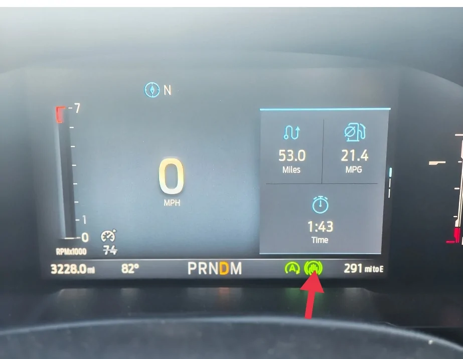

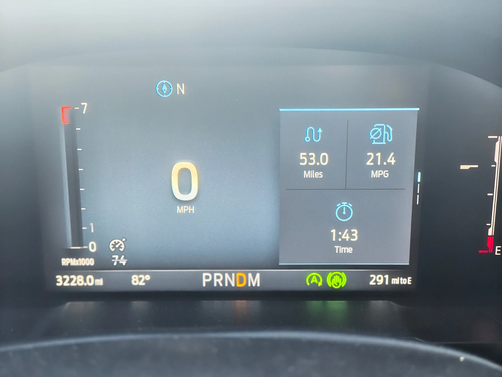

My #1 fav feature with my previous Volvo was when coming to a light, it would go into auto park mode. I was happy to see with my '26 Lobo I can manually do that my the gear knob. But I just noticed this morning it IS DOING THIS AUTOMATICALLY? What do the lights mean?

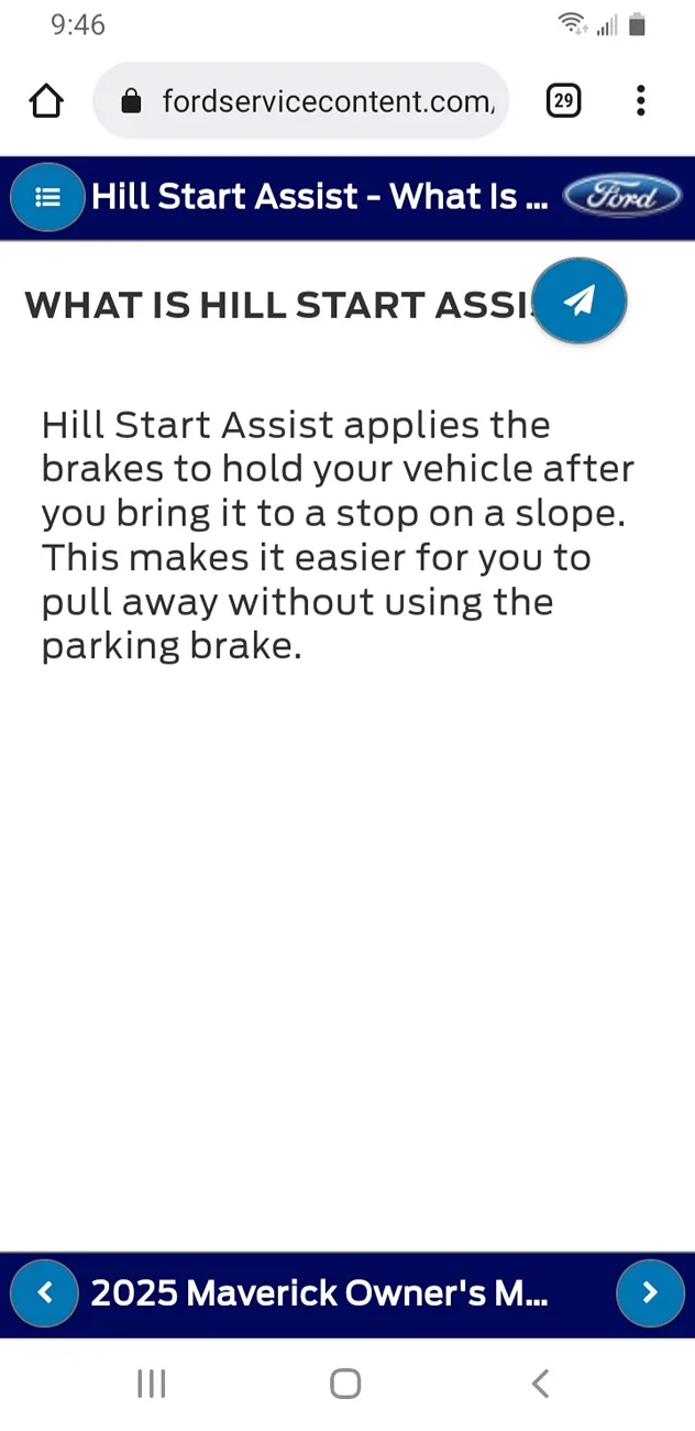

There are 2 different systems, on the Hybrid and EcoBoost.
1. Hill Start Assist.
2. Auto Brake Hold.
1. Hill Start assist Is always on.

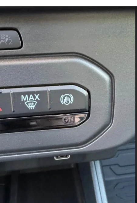

2. Auto Hold.
This can be manually toggled on and off.
I believe on MY's 25-26 the auto hold button is located on the Dash 👇 instead of the console.
Ford Maverick Autoparking brake? 20261005_090655
The green light below on your dash will light up when you come to a full stop.
Ford Maverick Autoparking brake? IMG_20261004_175848

Ok. thanks...AUTO HOLD...I never knew and it was not toggled on when I bought it...I have no idea how I toggled it on but I will look for the on/off toggle. Thanks guys!

If you have a 25 or 26 Mav.
The Auto Hold on/off switch is on your dash.

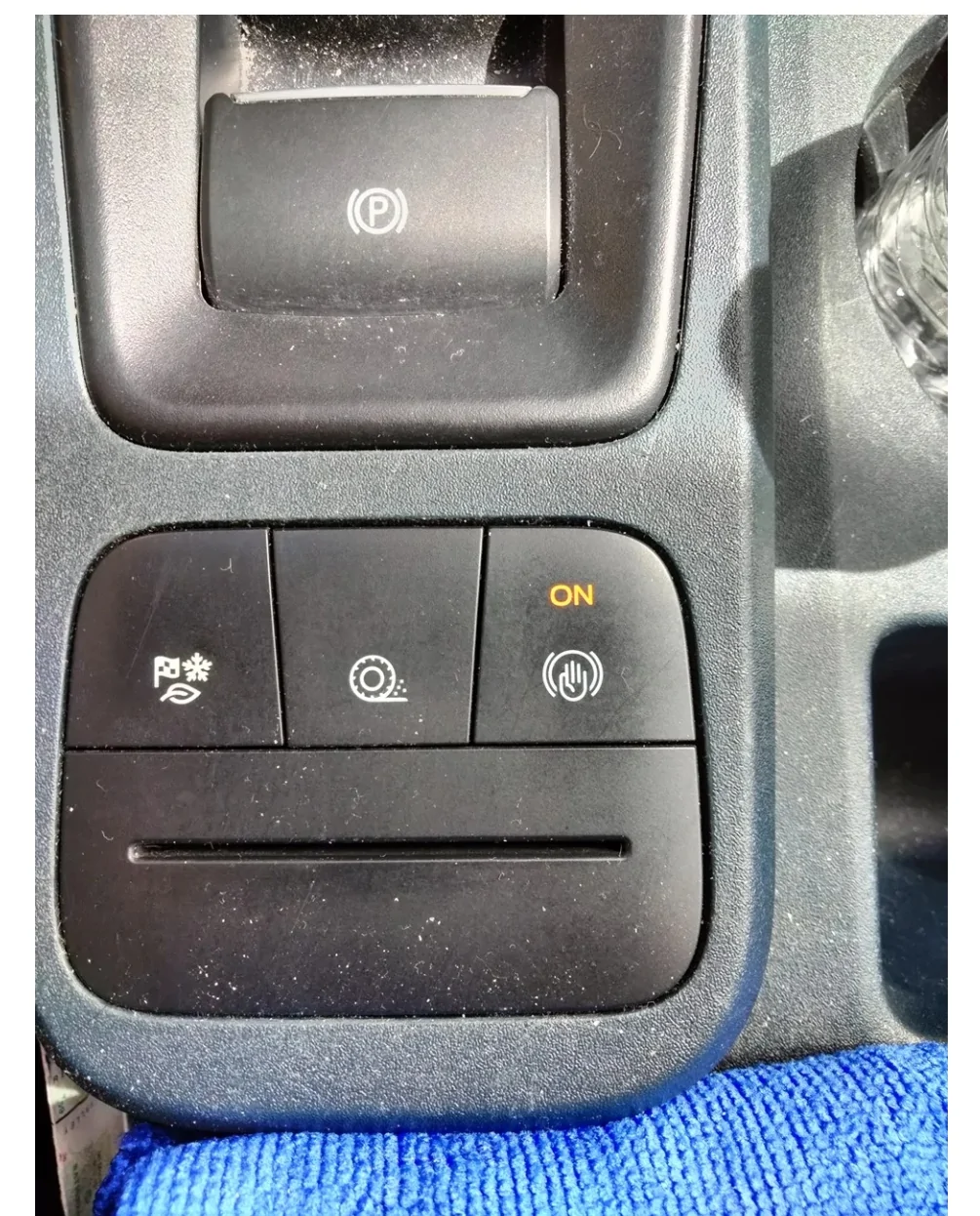

I have a 26 lobo and it is down by the gear shift knob.
I'm glad you found it.👍🏻
So is mine on my 23.
Obviously, it can be found in different locations depending upon year and trim.

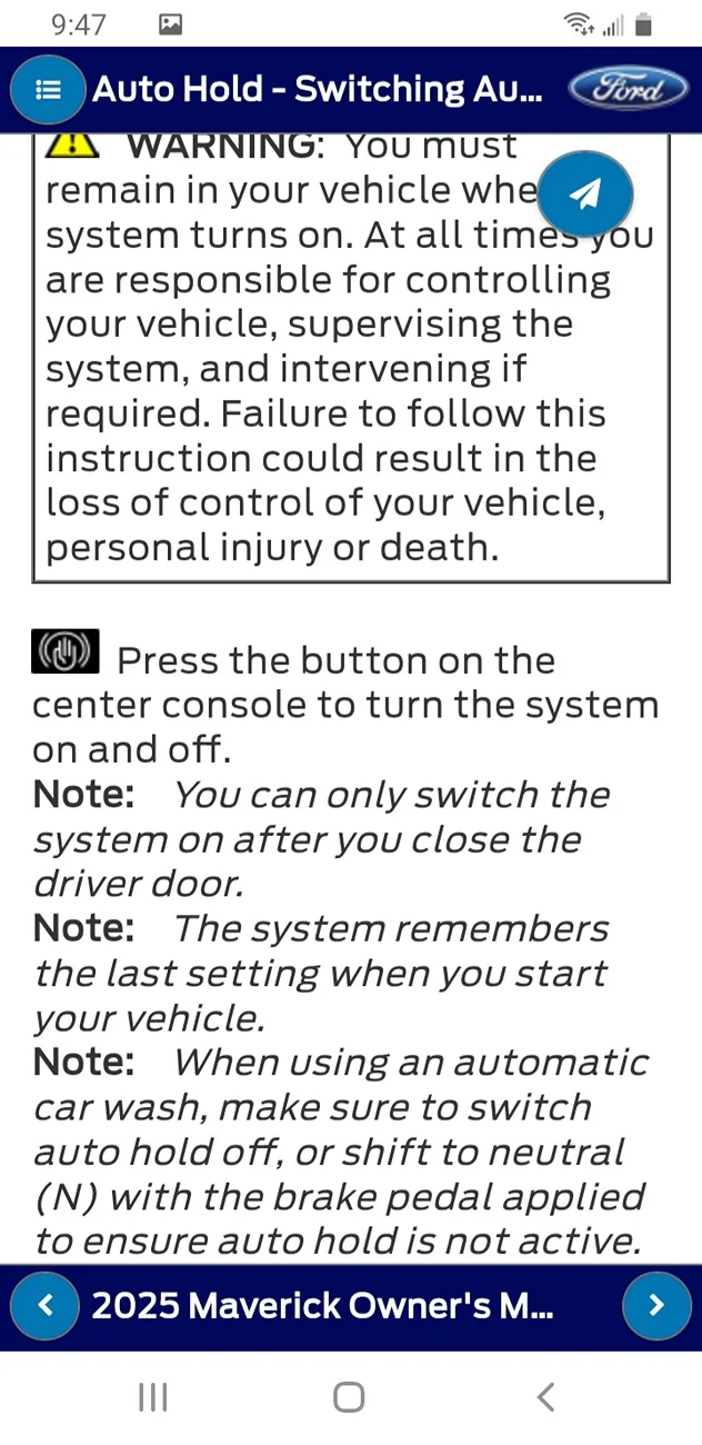

Ford Maverick Autoparking brake? Screenshot_2026-10-05-14-50-55-22_40deb401b9ffe8e1df2f1cc5ba480b12
Cancunbadlands
