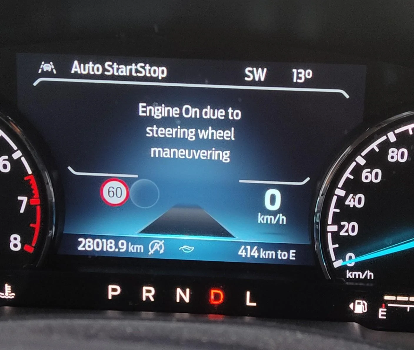

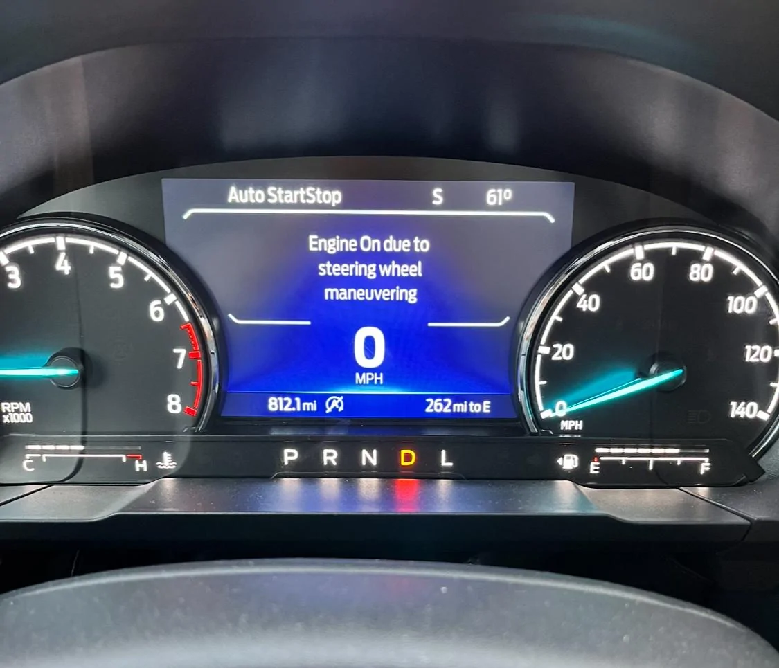

Just to make it more clear:
I noticed that I get "disabled due to steering wheel maneuver" now.

Gregk
Greg
Jul 18, 2023
84
Oregon
2023. XLT. 4K. F4X. Cactus Grey
FYI. I don’t get the steering wheel notification. But I also don’t have copilot
austinhiddy
Austin
Oct 4, 2023
41
Northern Illinois
2023 Maverick Lariat Lux
I have a lariat lux with lane centering (no ACC). I also get the same steering wheel messaging when at a stop. This doesn't affect lane centering for me at all! Very pleased with this!

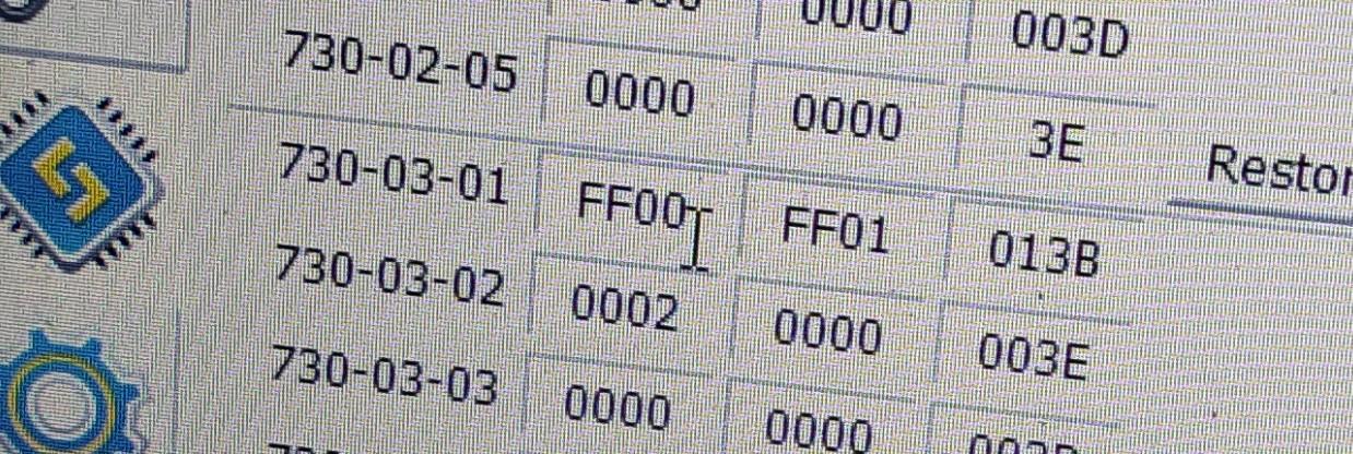

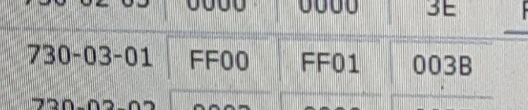

Just tried it on my 2023 and couldn't get it to work. My 3rd set of values are 013B by default. I changed the first two in that set to 00 and the last two automatically changed to 3A. Cycled to off and back on after the write and Auto Start Stop was still on by default when I started the truck. Tried 3 times with the same results. I haven't installed the most current Ford update that's available yet though.
I have the exact same problem here....
...any clues?
HolyCarp
Sep 24, 2022
169
272
DFW, TX
2023 Cactus Gray XLT Eco AWD FX4 4K
...any clues?
Found out that it actually worked. The symbol (letter A with circular arrow) still shows when you first start the truck. No need to press the Auto Start Stop button to defeat it. Just drive and the symbol goes away. When you come to a stop, the symbol comes back. But the engine stays running.
...any clues?
Should be 003B. type that in then save it and it will work (see my post 38 picture)
