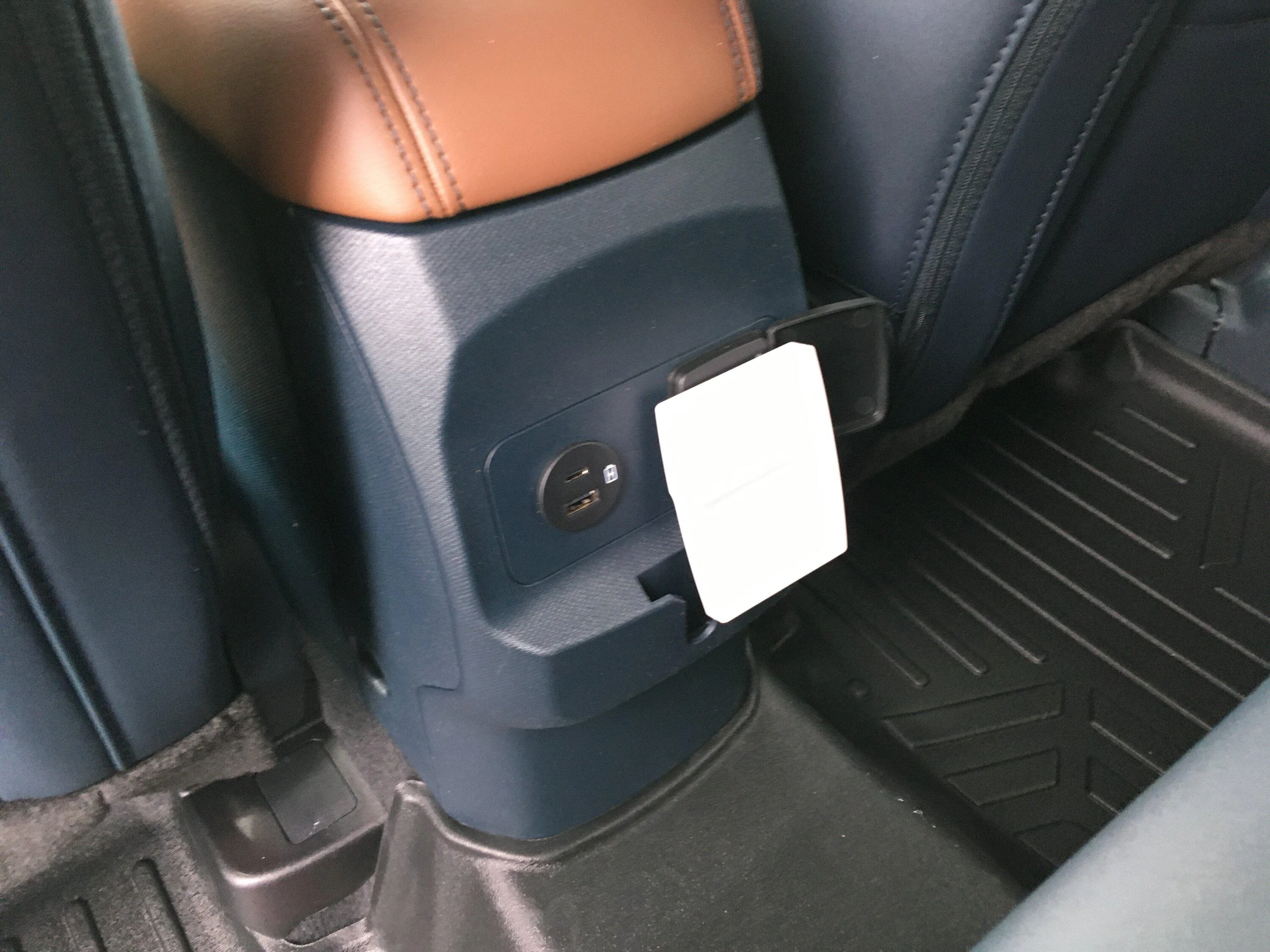

I have 2019&2020 Rangers and putting LED night light in rear 120 volt socket disables the stop start. I tried it on my Maverick and no joy ! I heard it works on F150's also. Im still looking for a good solution. Bret
