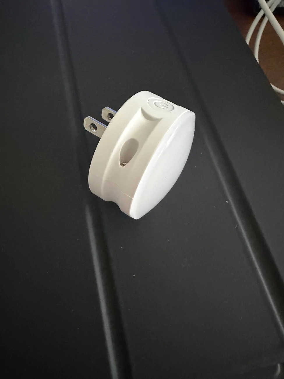

I have two night lights plugged into the AC outlets in the back seating area and the bed. I think the
truck sees a current draw on the AC inverter output and prevents Auto Start/Stop.
Can you post a pic of the lights?

Finally ran a test. With the lights plugged in the Auto S/S turns off as soon as I start the engine. With the lights unplugged the S/S does not turn off without pressing the switch. I had a 2019 Ranger that I used the light to disable S/S and it worked for the over 4 years that I owned it. I'll keep you posted if things change. For now I'm leaving the lights plugged in.

Thanks! So the lights are always on?
