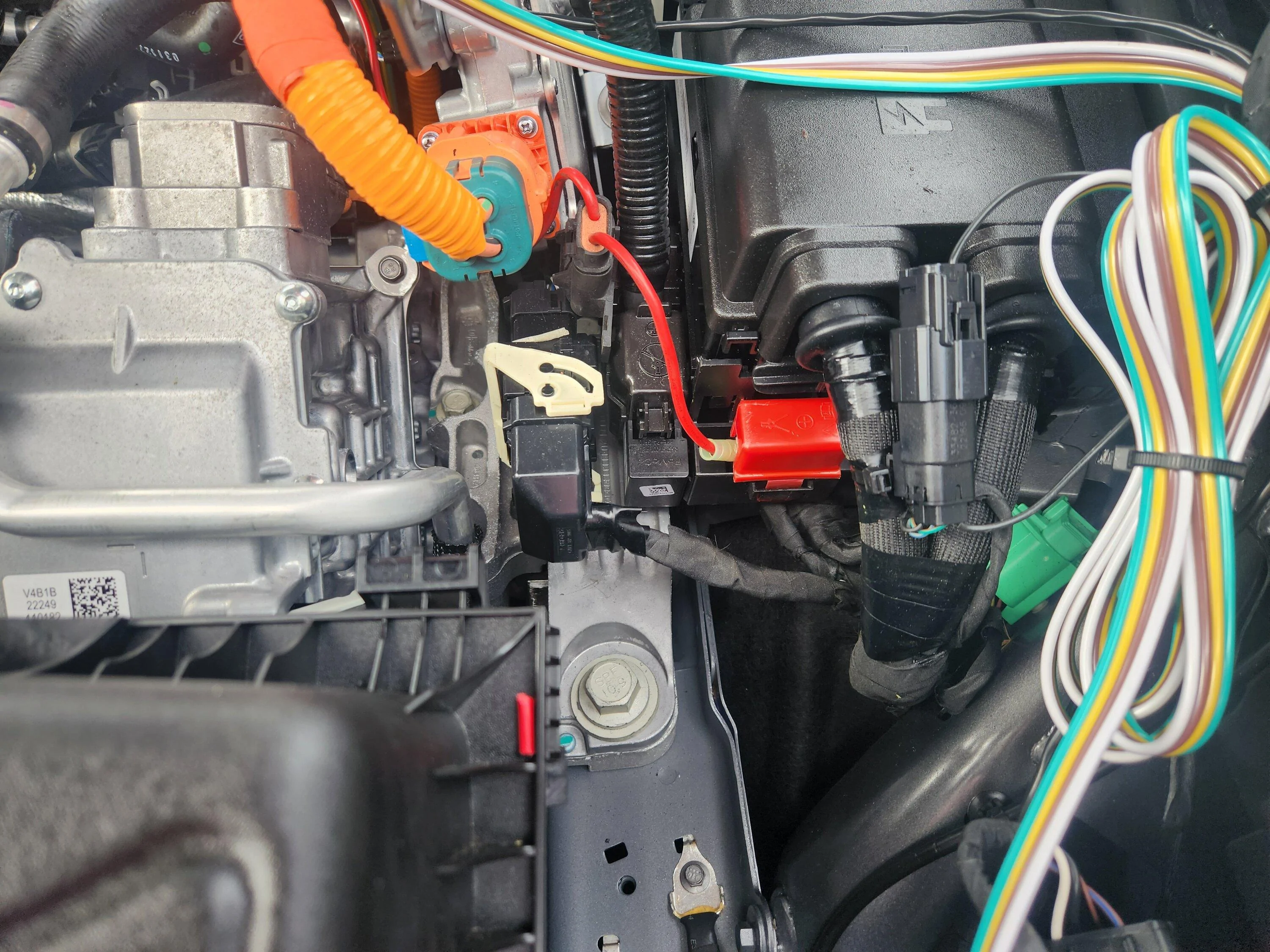

2000 mile round trip to Key West for the month of March. Easy tow and set up. Hauled 2 Lectric bikes, kayak and 6 hp Suzuki outboard along with numerous other things in the truck. RVi brake system, Blue Ox tow bar which I already had from our previous CRV toad.

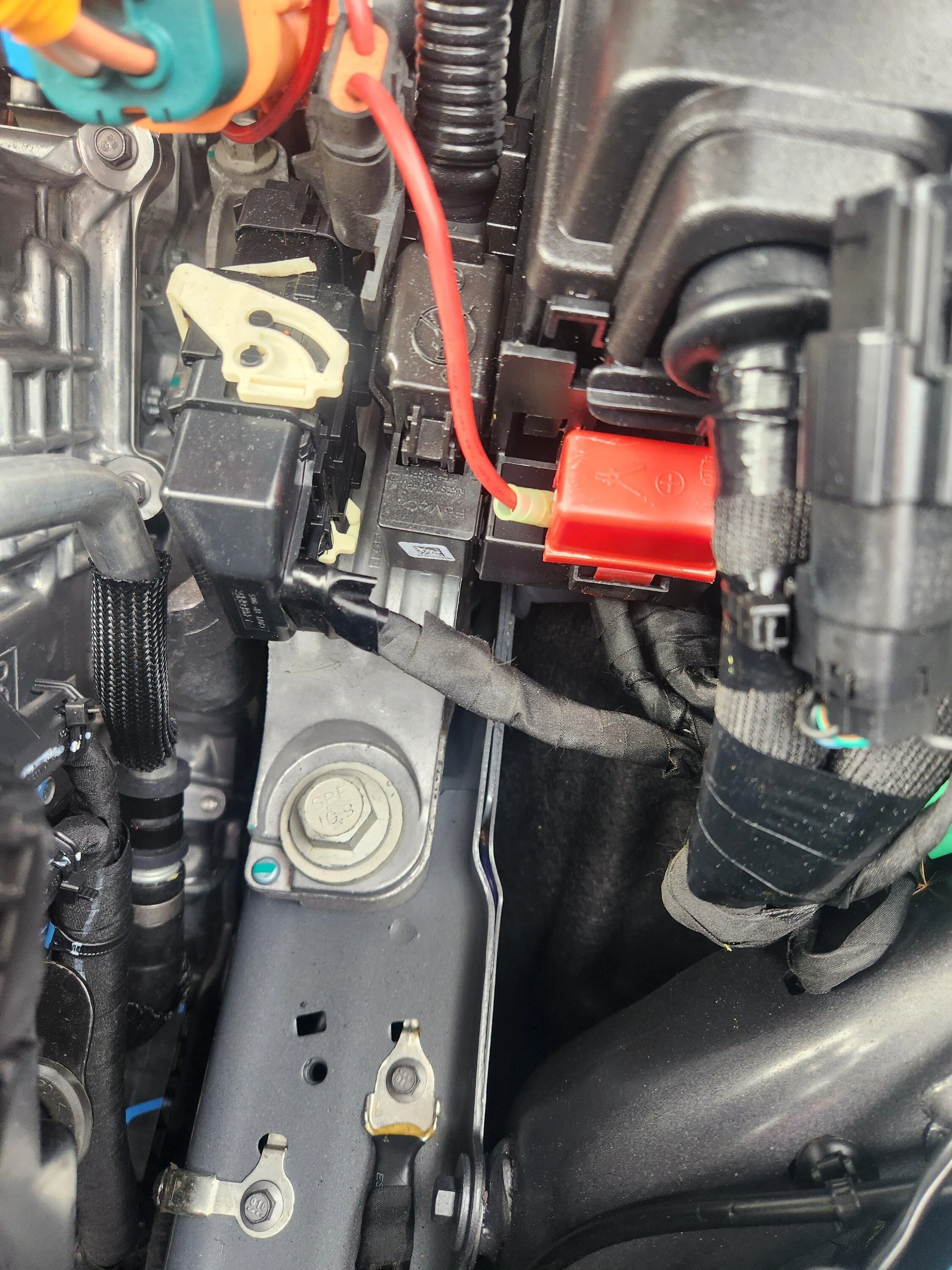

I used the diode wiring harness that splices into the Maverick wiring. Easy job.
What is a diode wiring harness? We had a shop install the tow bar and wiring but our truck goes dead and the brake loses power with in 90 minutes of towing. It's been a real pain.
Donald
Donald
Feb 1, 2023
227
199
Morehead City
2023 Ford Maverick XL
You need to hardwire a 12 volt plug directly to the jumper post under the hood. The existing 12 volt plug in the console shuts off in 90 minutes. Diode wiring harness splices into the lighting harness in the rear lights to allow the motorhome lights to work the toad lights. Easy install.

Please note that my Ford dealer said that connecting anything to that positive post that is only for jump starting the battery could lead to problems. I had to have mine disconnected from there and connected to the under seat battery. I installed a switch on the dash to deactivate it while not towing to avoid any further "warranty denial" items claimed by the dealer with the Rvi charger.

Yes, we hardwired from there directly back to the battery under the seat.
Tried this today but 50 miles into the tow we already have a dead battery! This has been a nightmare!
