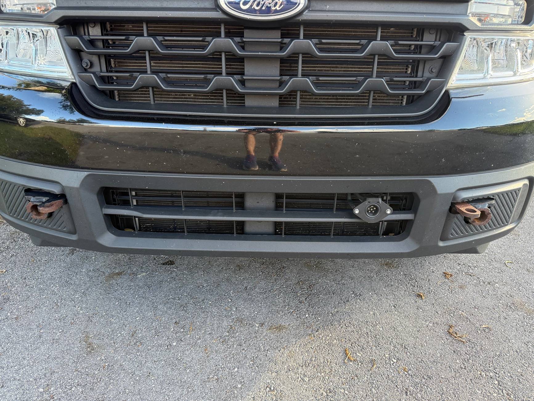

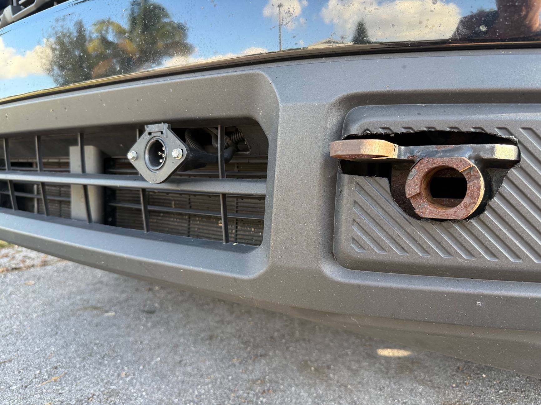

Question, maybe I missed the info. I bought my 22 XL hybrid used. It came with the front hooks and wiring. However, whoever did the wiring install did it by splicing my tail lights together causing the tail lights
Ford Maverick Maverick Flat Tow Videos IMG_6995
Ford Maverick Maverick Flat Tow Videos IMG_6994
to be faulty. I had to have the dealership cut the wires to the front pins in order to gain function of my tail lights again. Not to mention the gutting they did to my bumper. So I guess my main question is are these hooks secure or should I just have them removed? Everything I’ve been reading says the XL doesn’t have a place for hooks so I don’t know what they mounted it to.

Those "hooks" are a Blue Ox Baseplate...the original style that has had many failures. Yes, that is how you have to install version 1 from Blue Ox. Sounds like someone made a mess and then sold it off. You can buy a Demco Baseplate if you want to tow, and you can buy a replacement lower shroud. I wouldn't tow it across the street with that Blue Ox 2-piece baseplate.
