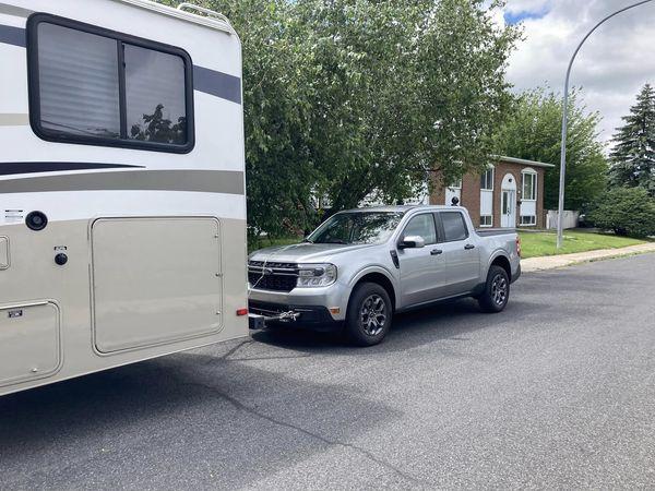

Has anyone flat towed a Maverick yet? I’m hoping to get mine by the 2nd of June and I bought it to tow behind my RV.
Don
Did a test run today. Work really great. Great thing that I don't have to disconnect my 12v battery like I had to do towing my Ford Flex for the last 10 years.

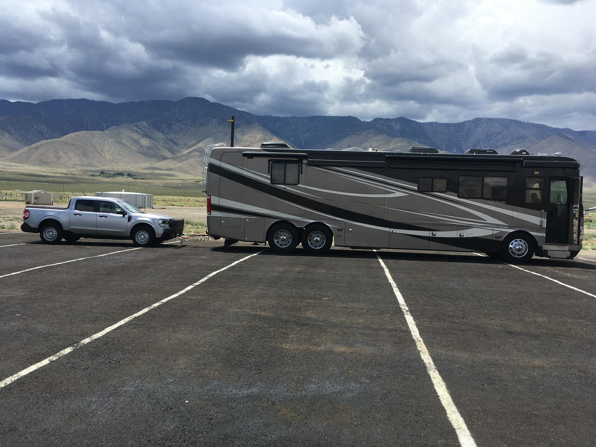

My thoughts exactly. I don’t have to disconnecte the battery any more. I haven’t had any problems with the switch over. Love the Maverick so much more room than the Nissan.
