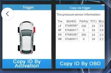

Sometimes a new pack of batteries off a shelf with a far future expire date - really don't last that long and ended up being bad quality.
Perhaps your sensors got a bad batch of batteries.
I haven't seen a TPMS reader that measures signal strength, but I'm sure they must exist.
Not sure if that's what the last column here is giving - battery V, which is just as good.

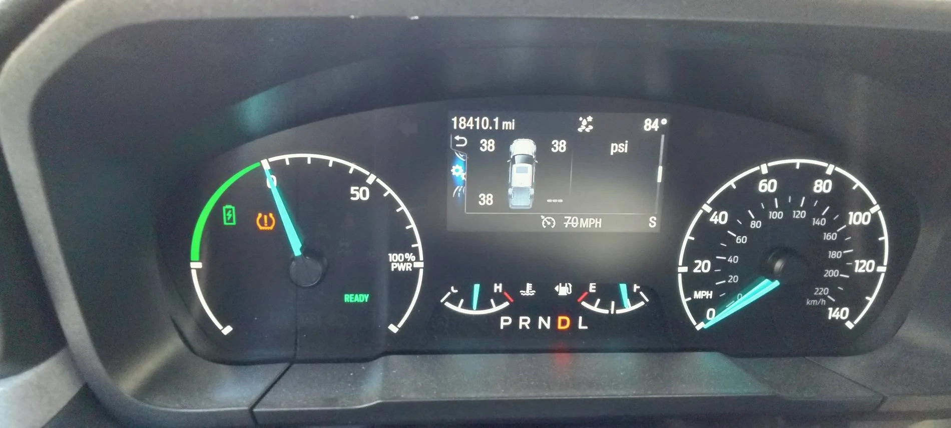

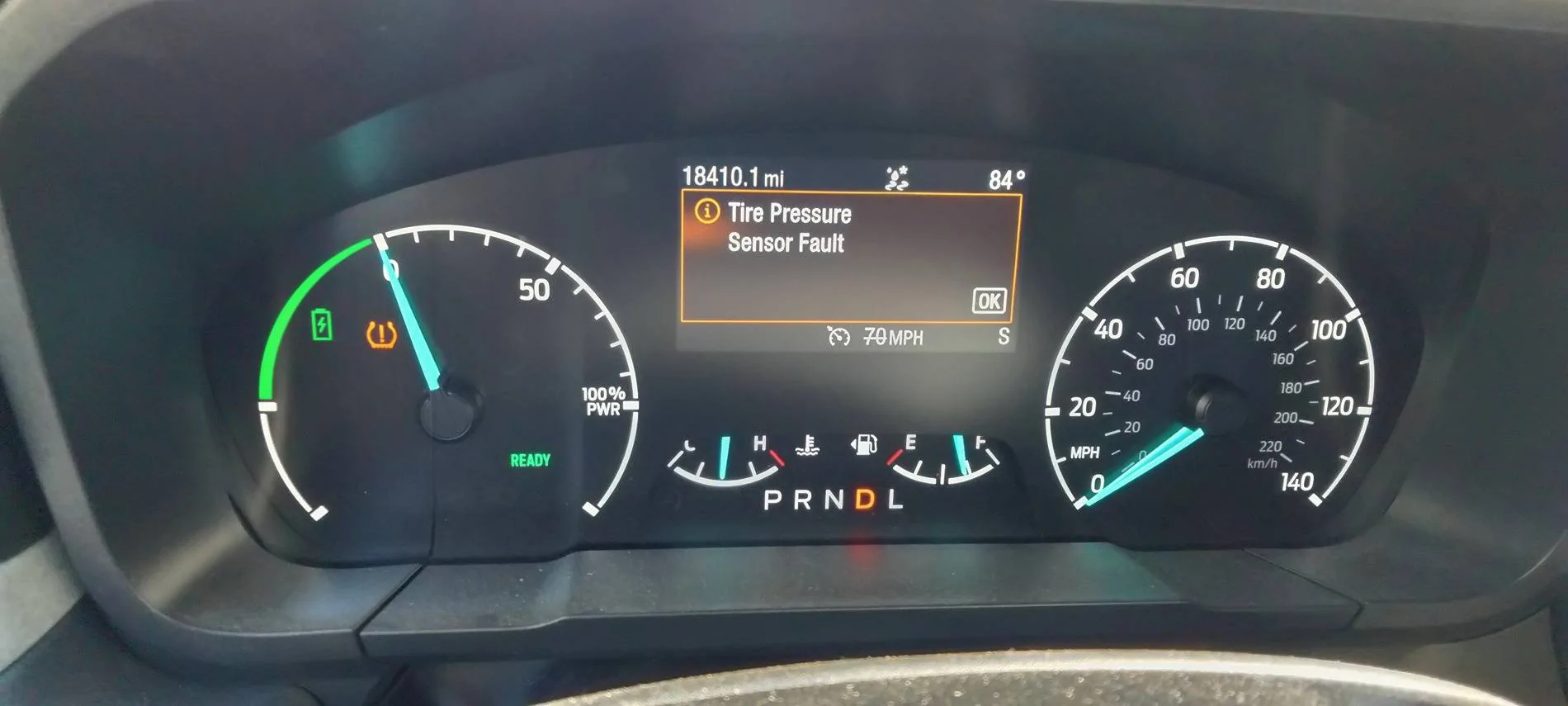

Yes but today it's the driver side rear and the passenger side is okay. See my post #6
Today's went away while I was driving.
Here's the picture.

A couple of weeks ago it was the other side.

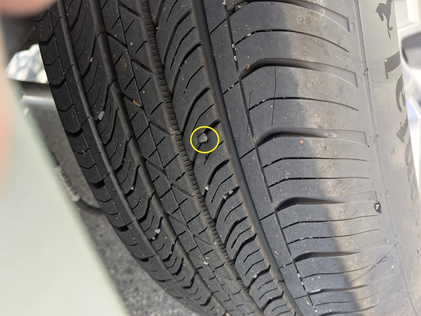

I got a low pressure warning yesterday - of course when I was in a hurry to get somewhere. TPMS said I had 15 psi. Tire didn't look "that" low but would hardly budge my pressure gauge. Did a quick visual and could not see any penetrations. Aired it back up and went for a drive. Pressure held steady for several hours and I kept checking the tire every time I got out. Finally found the nail that had poked in between treads. These stock tires seem to be magnets for road crap! Glad to have the sensors and I probably would have driven around on a low tire till someone yelled at me on the road :)
