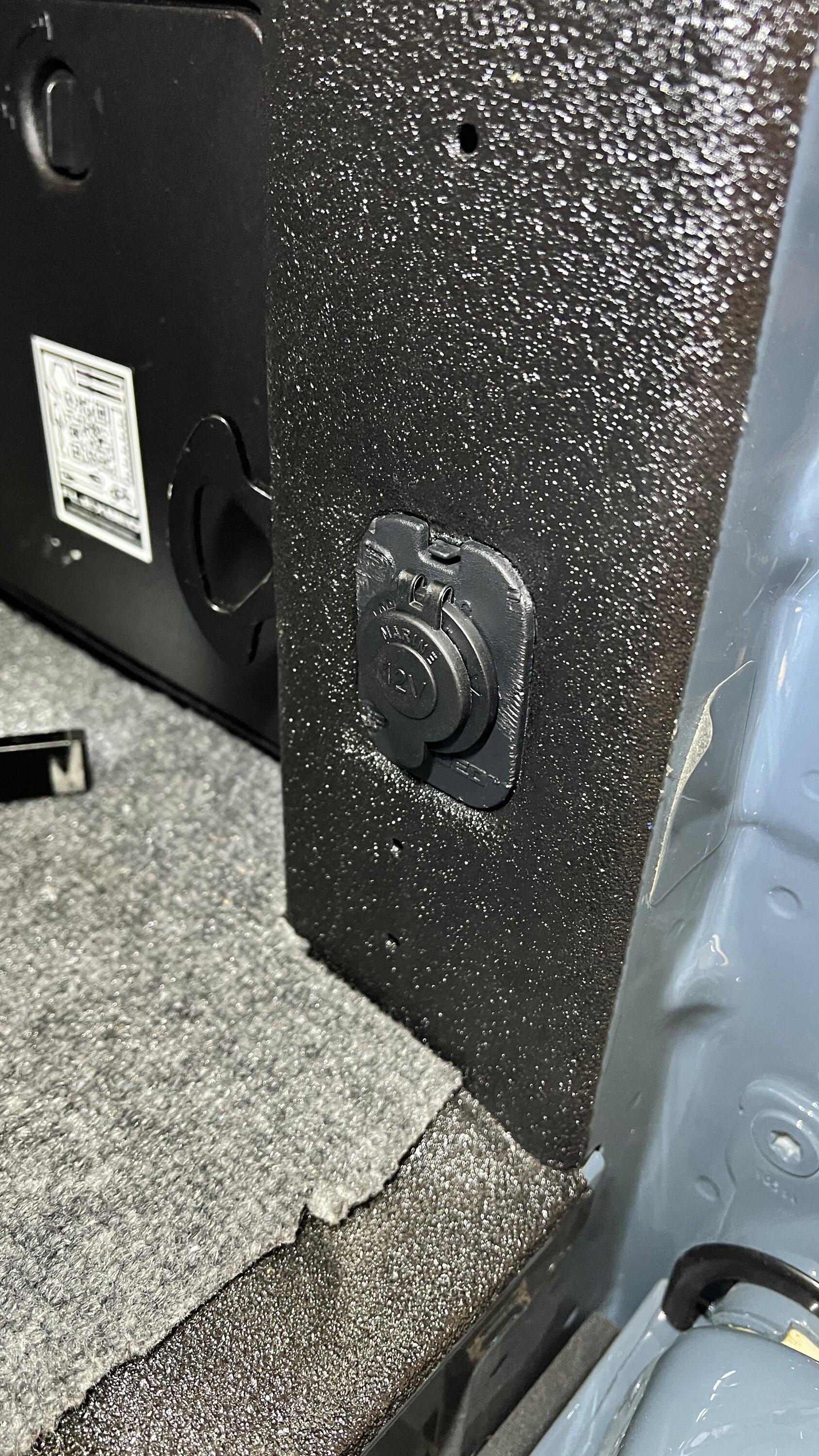

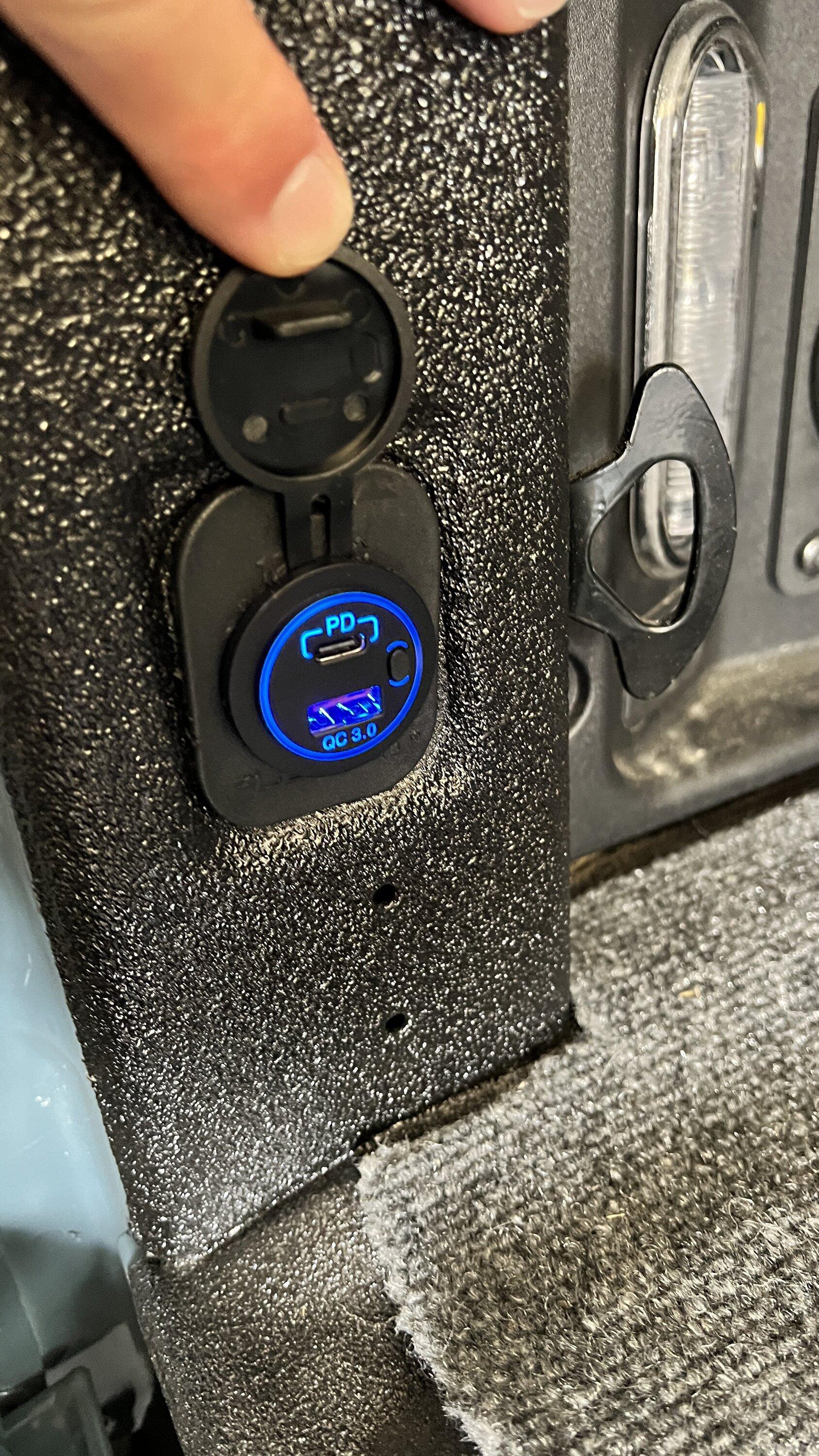

I grabbed an extra 12v adapter on eBay and put a plug on each side. Takes a bit of cutting on the cover, but it fits about as clean as it possibly could. The USB port turned out great; the cover on the 12v side got marked up a bit when I was modifying it.
Looks great! I'm doing the same thing on my Lariat; cig lighter on one side, USB on the other. I'm hoping you remember the size of the drill bit (forstner bit I'm guessing). Someone somewhere posted the drill bit size, but your post came up in my search, so I'm hoping you can help. Thanks for posting.
thin_crimson
Sep 18, 2021
71
40906
I used a 1-1/8 woodboring bit since it was all I had on hand at the moment. Best I recall it was a little more snug than I would’ve liked. A step bit would be more ideal. Had to shave the backside flush as well to make room for the nut.
