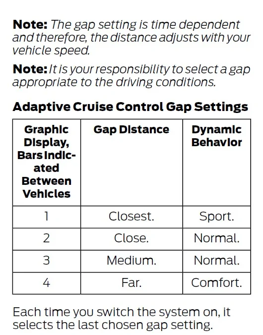

The behavior is dependent on the gap you have set.
HRG
From the Owners Manual
Ford Maverick adaptive cruise control runaway problem Screenshot 2026-06-09 163833

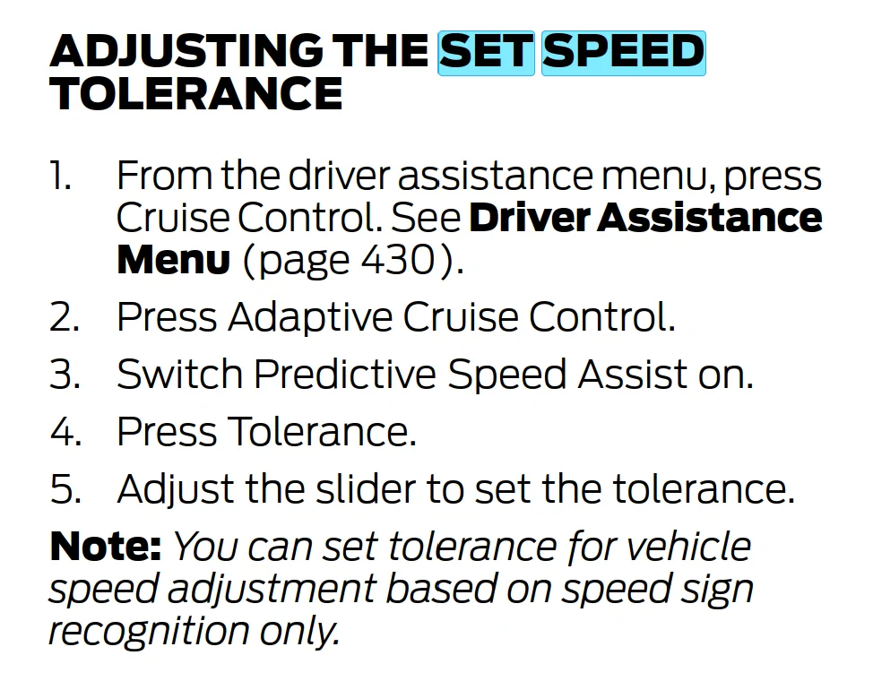

In my experience, if you have Predictive Speed Assist set to on with ACC, when the system sees a speed sign after adjusting speed down below the set speed limit, when it has clearance to speed back up, it will adjust the speed to the tolerance set of the last sign it saw which can be adjusted per below. If you have the tolerance set to +4, the speed will adjust +4 miles over the sign speed. If so, you can adjust it back down with the set-. Otherwise check these settings and if you don't want it to adjust after this scenario, either turn Predictive Speed Assist off or set tolerance to 0. Hope this helps!
Ford Maverick adaptive cruise control runaway problem 1781137538222-jh
The tolerance was set at 19. I don't know if I set that or it was a default. I set the tolerance at 4, and it seems to be working right. Thanks for the help.
