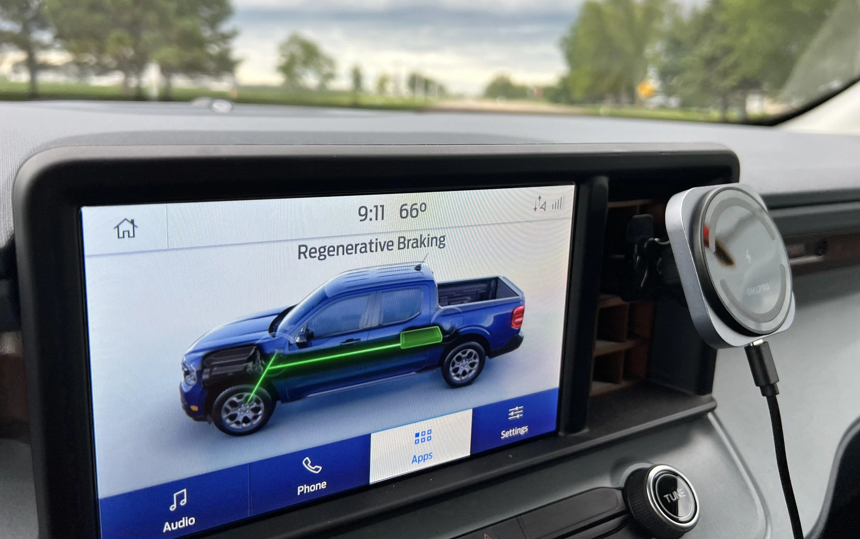

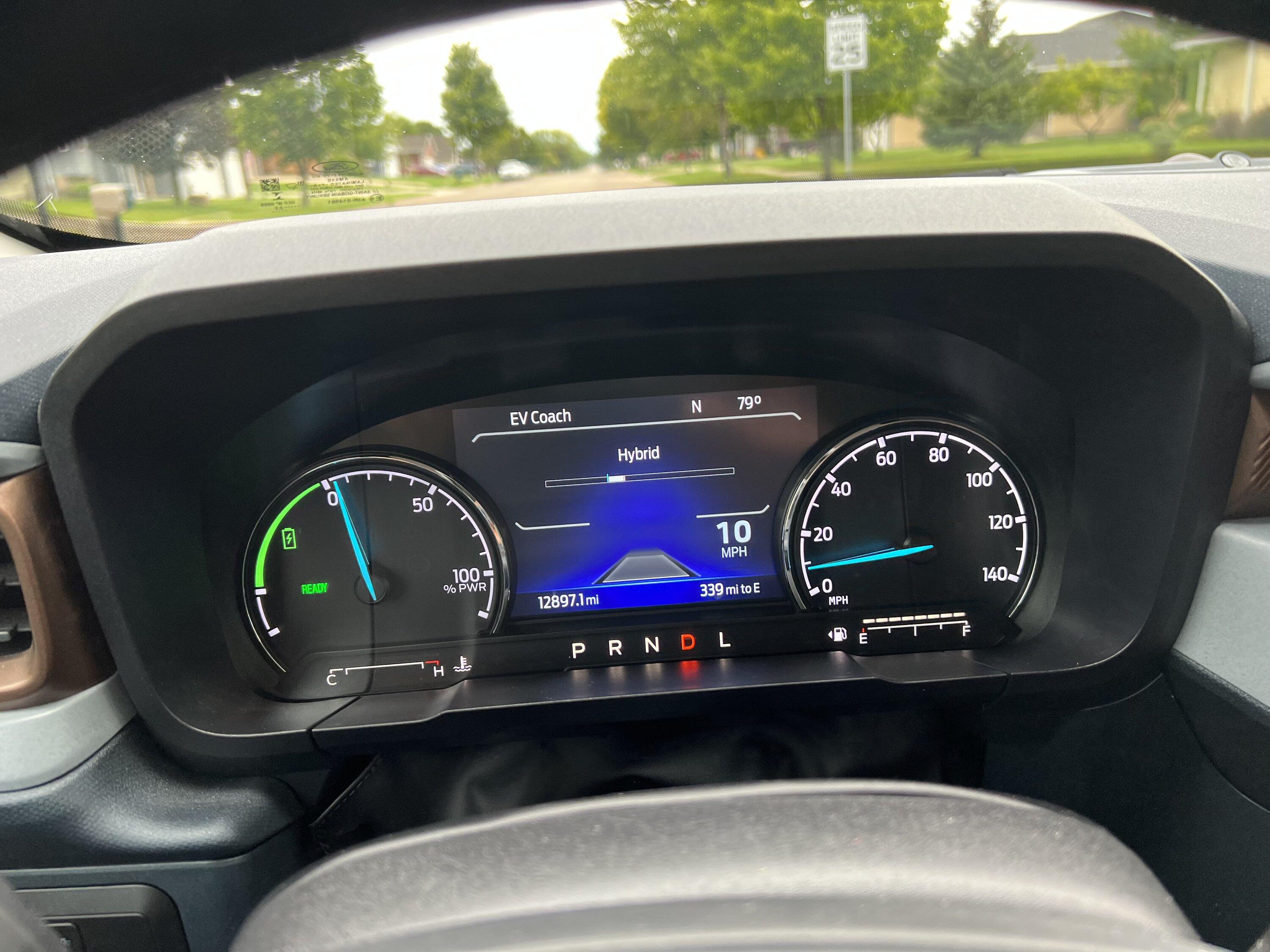

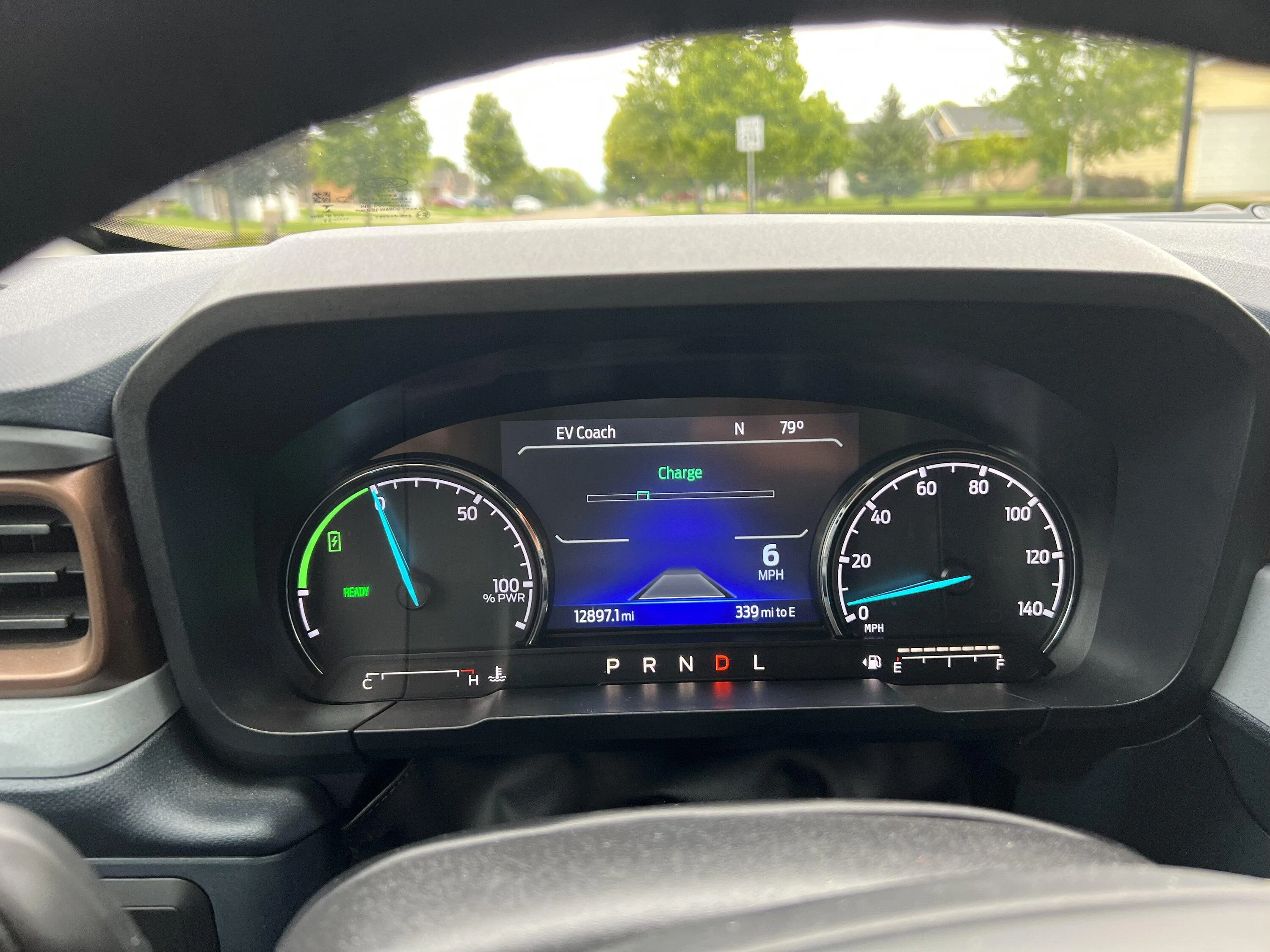

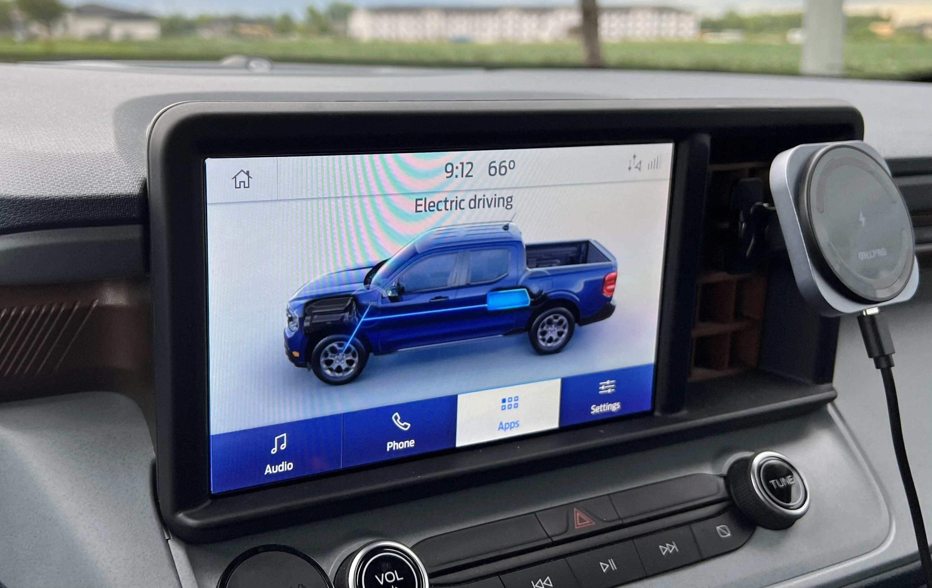

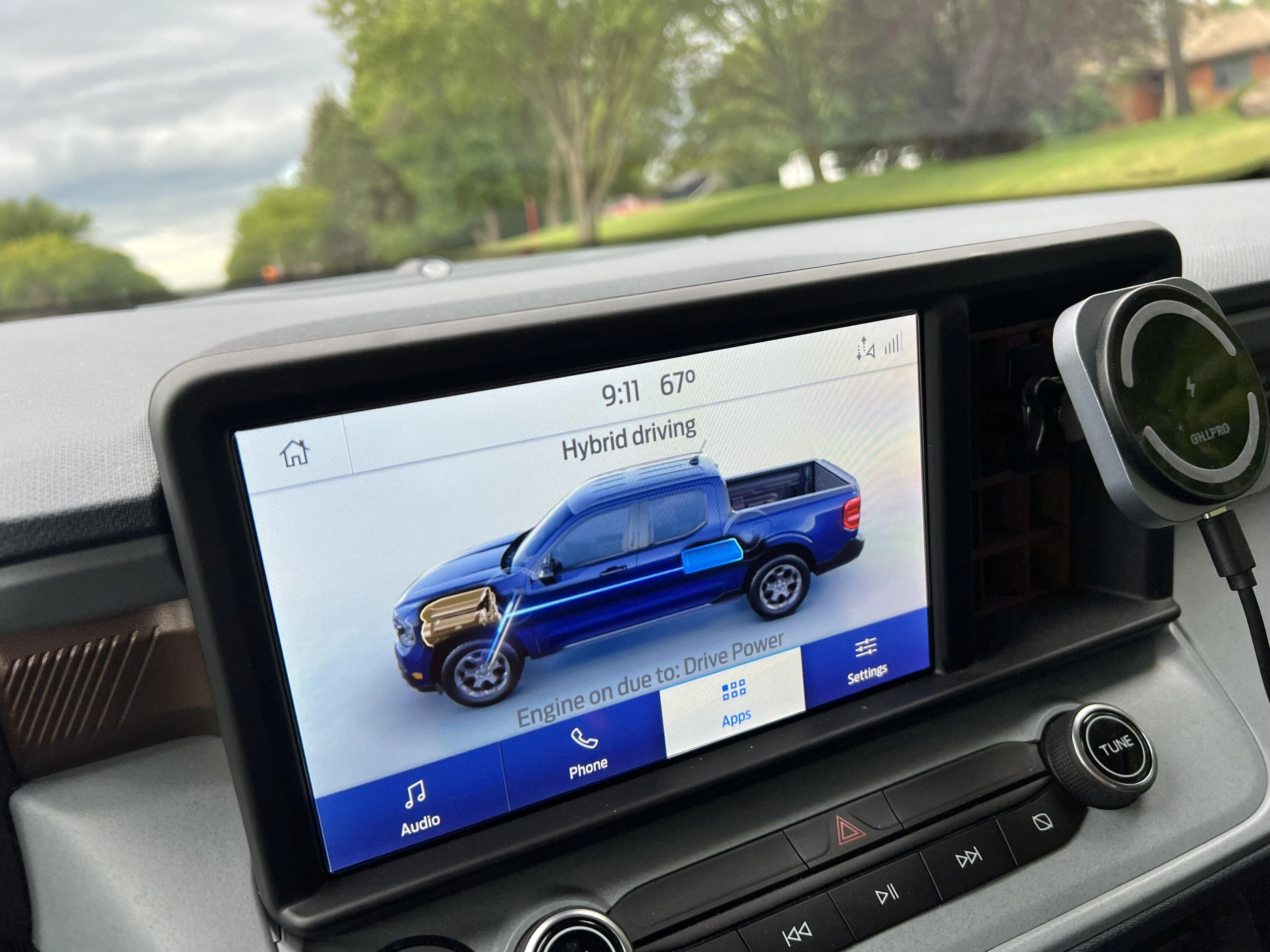

There are display settings that visualize the state of hybrid to gas. Fun to feather the gas pedal just enough to keep in electric mode. (Is it technically a gas pedal or would accelerator pedal be a better term)Also the radio has an app that displays, at least on the lariat package.
