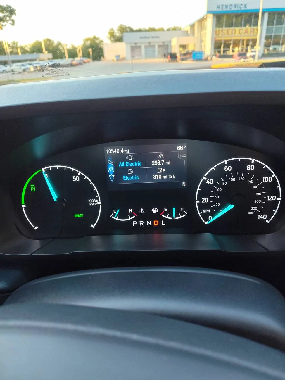

Happens frequently, seems like whenever I'm trying to log my trip stats before or after fuel up, very annoying.
Obviously I didn't get 300 electric miles - haven't discovered a way to correct it without moving fast enough to kick on engine, which now ruins the trip accuracy after fillup.
I've resorted to not shutting truck off until I get stats pre-fillup.
OP - if you want to see more useful EV/Hybrid status, using the wrong screen. Try the MyView with EV Coach instead.
Ford Maverick Electric vs. All Electric display IMG_20250520_195444126_HDR

"All Electric" is what has happened since the last key cycle.
Sometimes the "All Electric" will persist for 10 to 30 seconds after the gas engine starts. Just the way it is.
"Electric" is what it is currently doing at this second.
