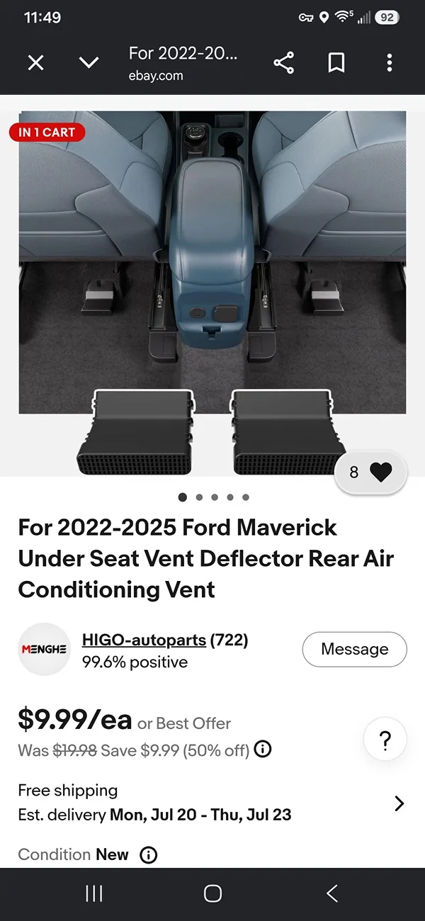

While it is possible that the factory may have neglected to install the filter, at some point in time someone should have suggested that the filter be changed. If it is still under warranty I would definitely have the dealer fix anything wrong. My personal bitch is the air in the back seat. Ford has such a crappy design that the poor passengers in the back suffer a great deal
As for the rear passengers, not sure how much it'll help, if at all, but been meaning to try them
