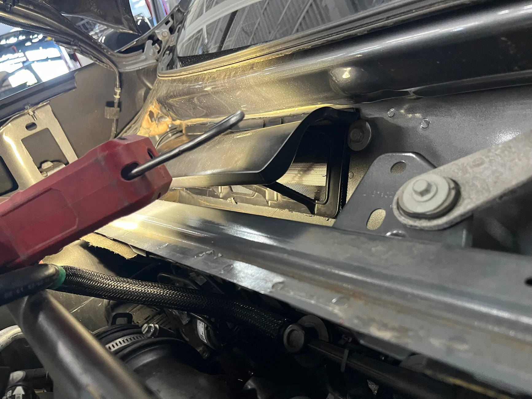

Peppermint oil mixed with water in a spray bottle. Spray it all over, under hood, behind and under seats in outer wheel wells, in box, everywhere. The HVAC vent is only one of many entrance points into cab, there is also an open vent behind the rear seat. A mouse trap bated with peanut butter under the seat as added insurance. Just don't forget to check on it once in awhile. P.S. spray that cabin filter too! Do it about every 2-3 months.
That is a terrible idea putting a trap in the car. You rage baiting people 😂
