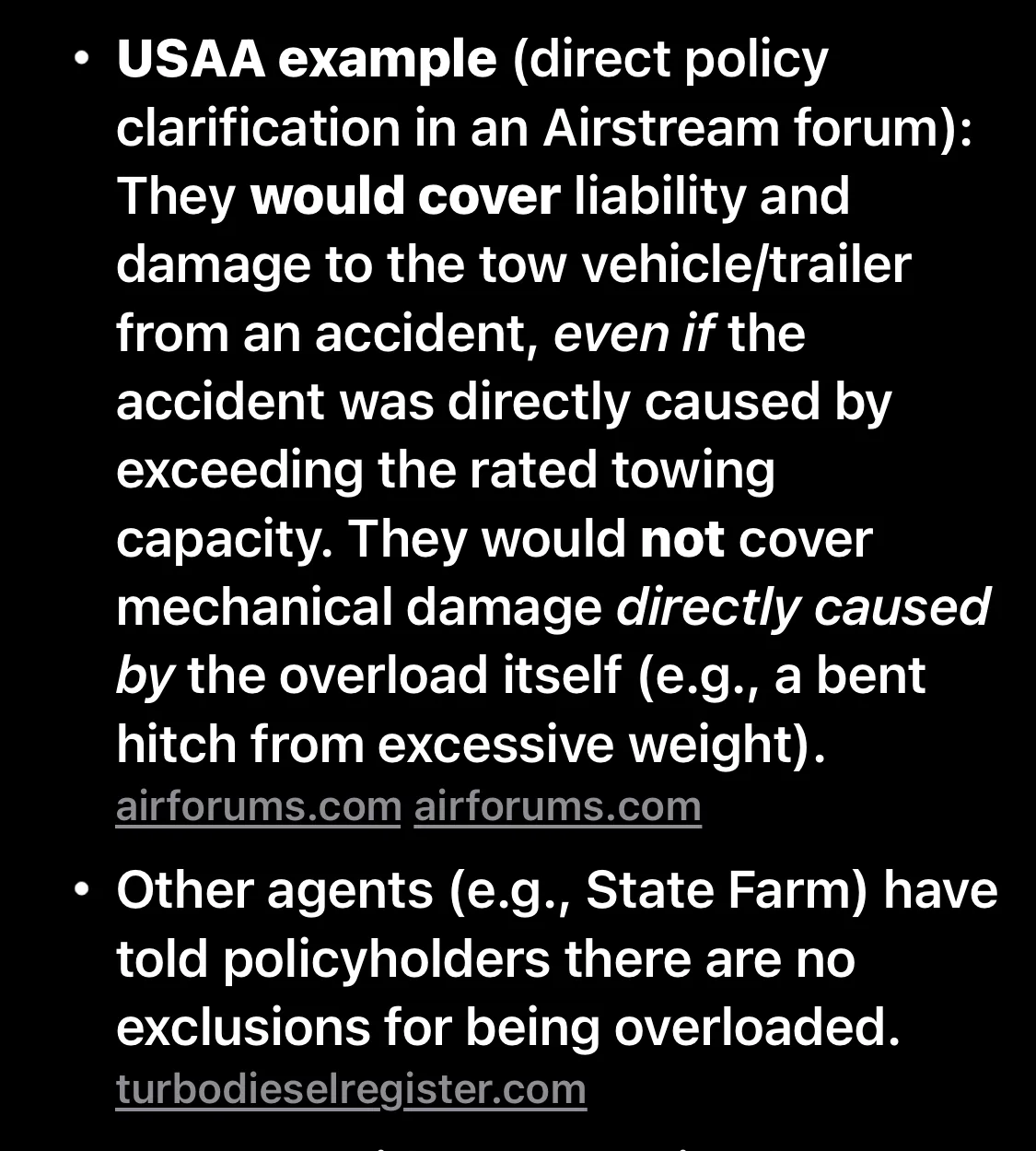

Results of a 40 second Grok Think. https://x.com/i/grok/share/07a0c39e9fb748eba54618432c8f311b
TLDR;
No prominent, publicly documented court cases or news reports were found of an insurance company outright denying coverage solely because a vehicle was towed (or towing a load) above its manufacturer's rated upper limit (e.g., towing capacity, payload capacity, or GVWR).

Thank you for taking the time.
I have done my best with less powerful tools and have not found any evidence either.

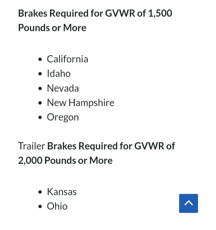

Regardless of what your Maverick is rated for and you feel safe Towing. Some states have a pretty low trailer weight where brakes are required.
Where a 1500 lb trailer being towed by a 2K tow rated Maverick would still be breaking the law. Unless you've added an electric brake hookup.
