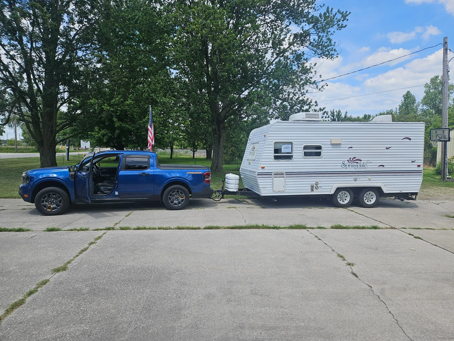

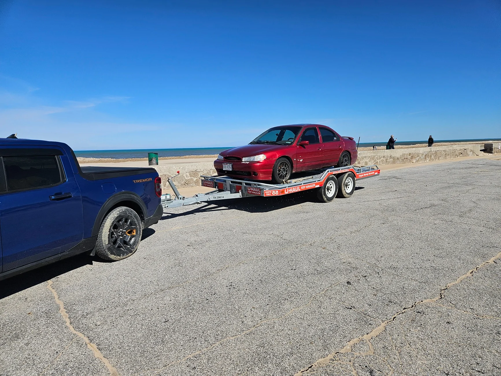

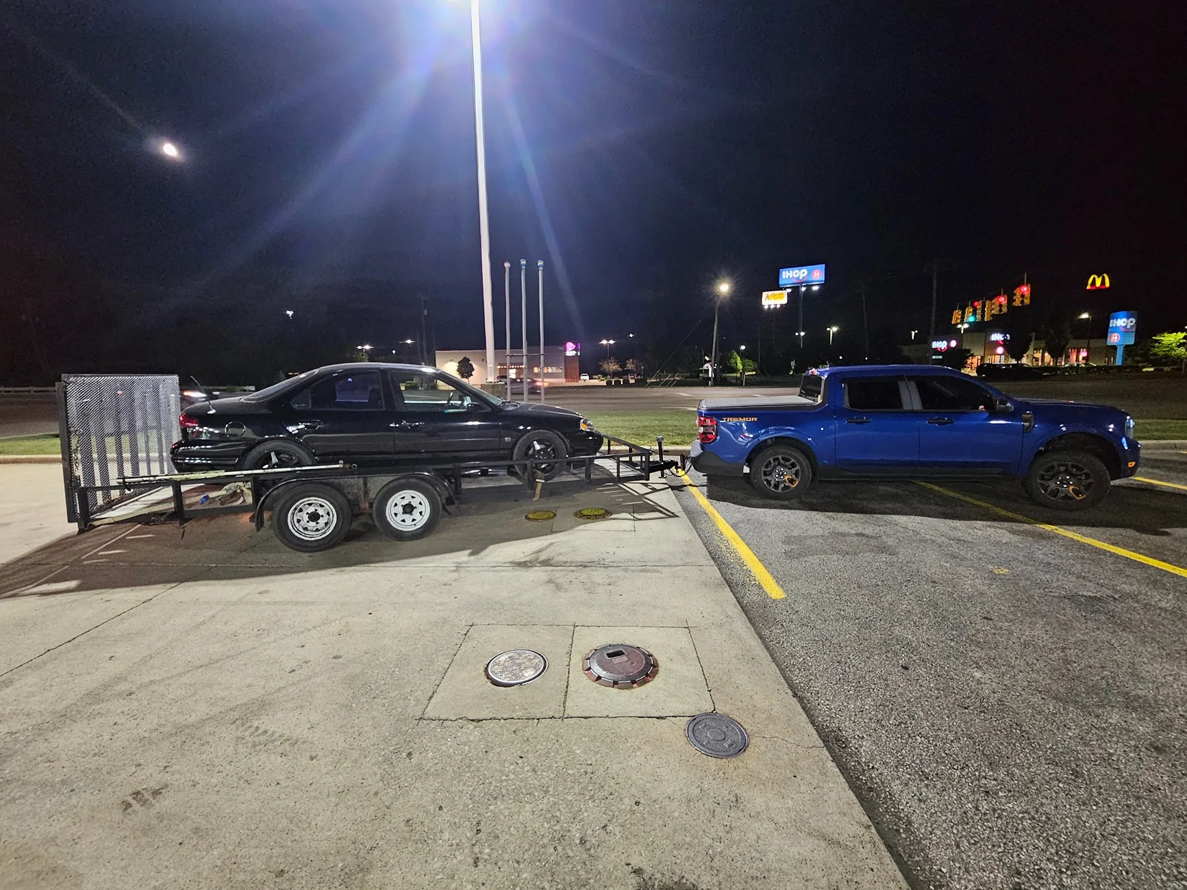

I pulled a 6x12 Uhaul from Indy to Boston when my son moved. Same truck you have with FX4 and 4K towing package. I took the southern route thru PA to avoid all the trucks on the flatter NY route. Mileage averaged about 16-18mpg and I had no problems towing. Hardly noticed the trailer was back there unless I was going up a grade. I kept it between 60-65mph because of the drag that I did not feel, but I knew the truck did. No problems and no wear and tear that I could see. It is a great little truck.
I agree, I'm quite impressed by the capability of the Maverick It has the ability to do things that older generation f150 we're capable of but packaged in a small truck..I love mine

How close are those to the 4000 pounds? Looks like close to the limit.
