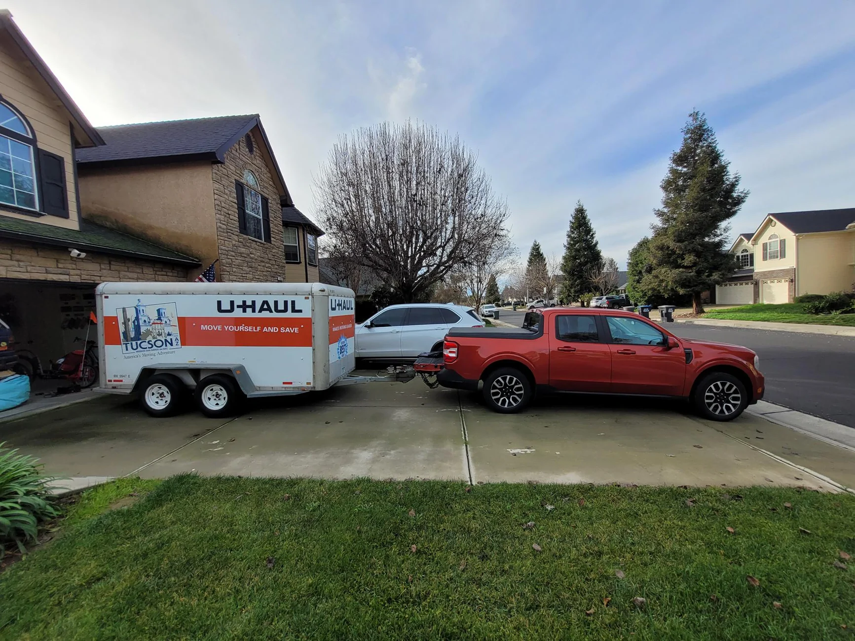

I towed a 9x12 with my 22 hybrid for a few hundred miles and it did just fine. Biggest concern was going through some deep flooding on some curvy mountain roads, but all went well. It was probably ~2,500lbs (so slightly overweight) but I took it easy, didn't rush and California won't let me go over 55mph while towing anyway (it did fine at 60 the whole way). Surge brakes were jerky when coming to a complete stop at a stoplight, but felt good through the mountains.

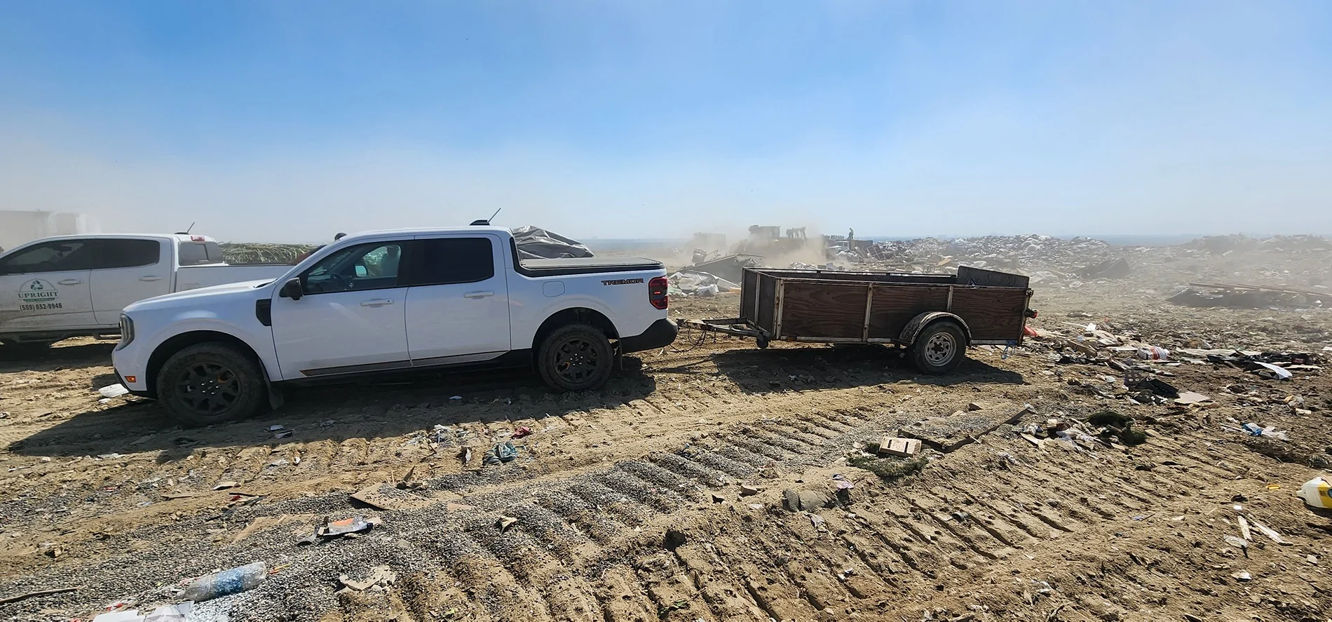

Naw :) If I planned on regularly towing anything, I would not have gotten a Tremor. I have a roof top tent that has taken up permanent residence in my truck bed (see profile pic). If I want to do any "truck bed" stuff in my truck, I just borrow my Dad's little 4x11 trailer. Besides this one little goof off thing I did, my Dad's trailer is the only thing I have ever towed with my truck.
