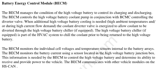

Considering the HVB is under the truck with no cabin air flow to it, and has coolant lines for the purpose of heating or cooling - wondering how cabin cooling will do anything for it?
Besides the fact the OP has no hybrid.
What is the service info that mentions that?
Thanks
From the "free" online service manual, which includes some but not all the detail re: hybrid systems:
Ford Maverick A/C on even when the LED Is OFF? 1723240915334-n0
And this...
https://www.mavericktruckclub.com/forum/threads/hybrid-battery-cooling-data.35154/post-636532
