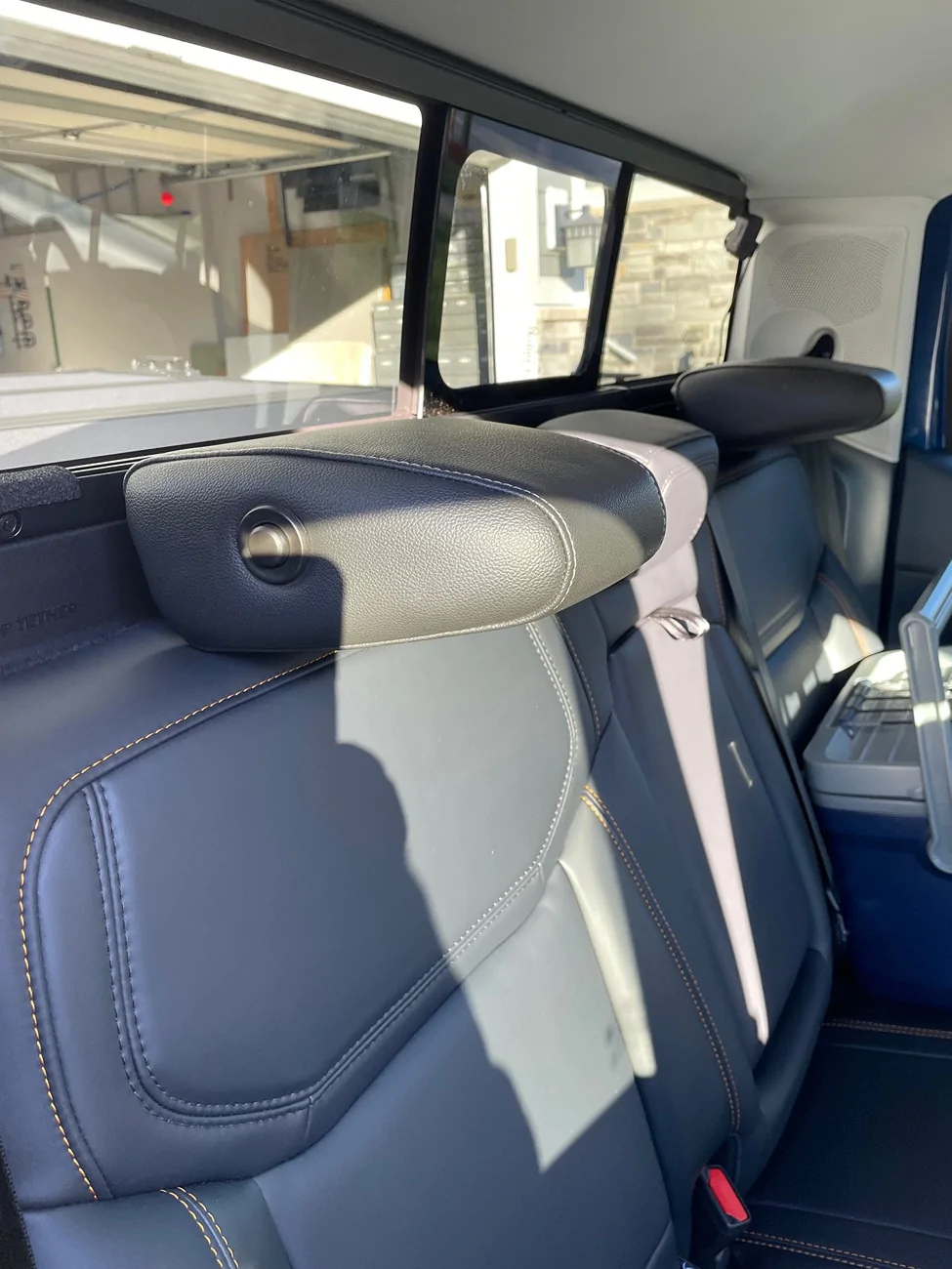

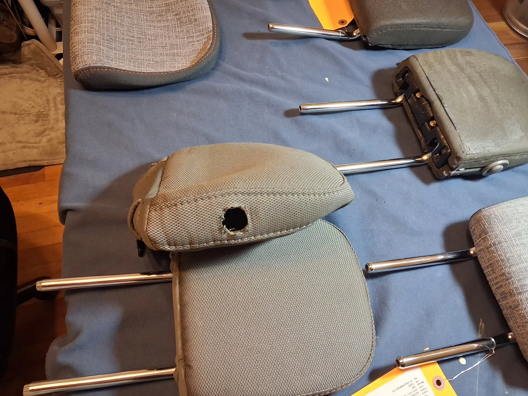

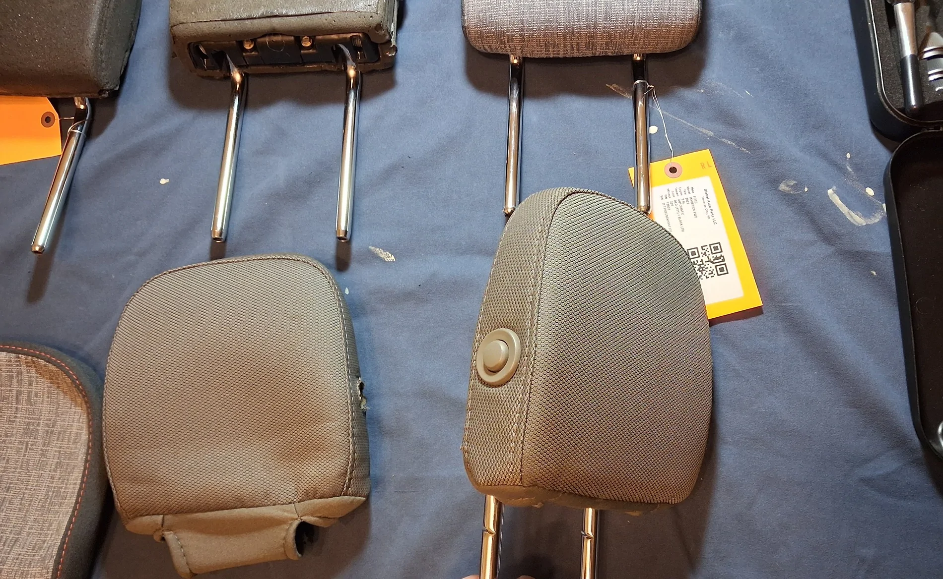

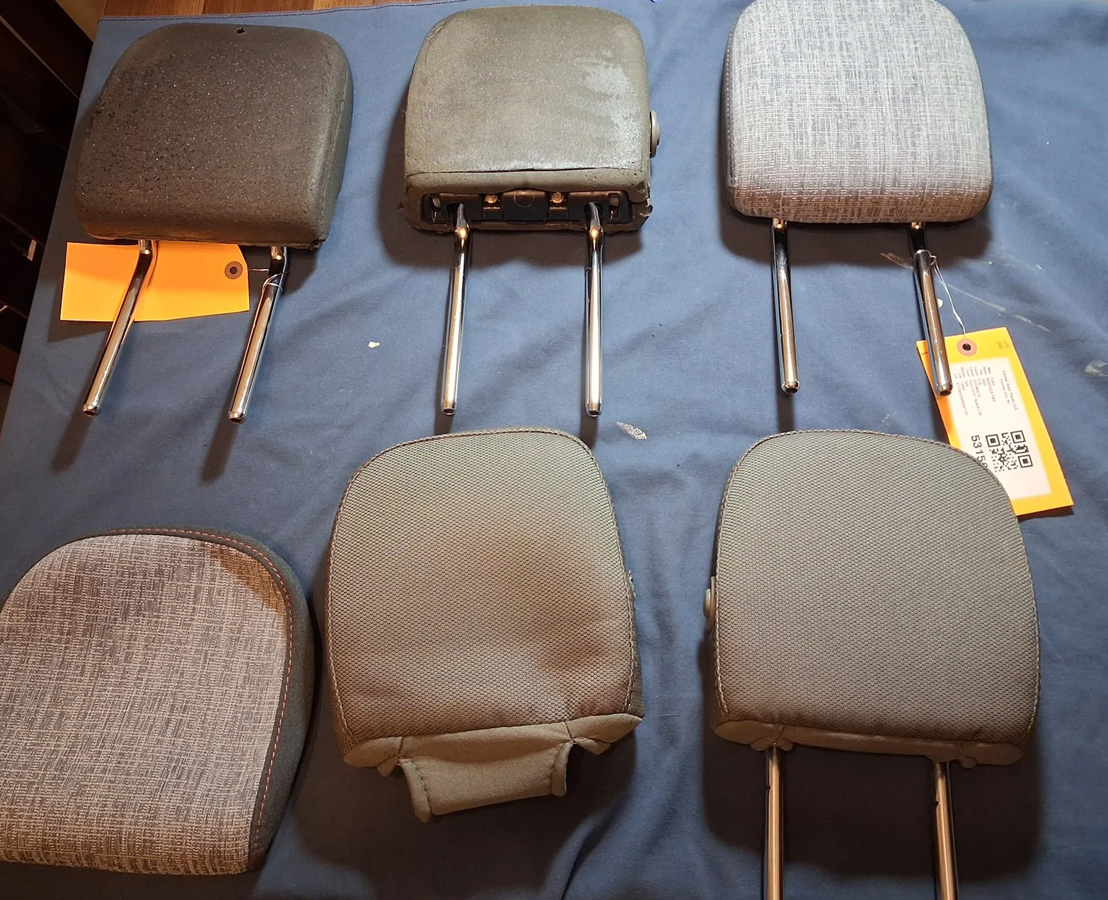

2015 - 2020 Ford F-150 foldable headrest have the exact same foam profile as the Maverick rear headrests.
I had to cut out for the button, and open up slots at the bottom for travel. My sewing skills are not good so I lined the slots with iron on rip-stop strips which worked great. In any case this area is not visible. I also had to widen the right side post notch to lock into the Maverick guide. That's it. Bought the full set of F-150 headrests on eBay for $70.
I never really noticed a problem with rear visibility with the factory headrests, I just wanted foldable just because. Now that I have driven with the headrests down they really do help. Well worth the effort.

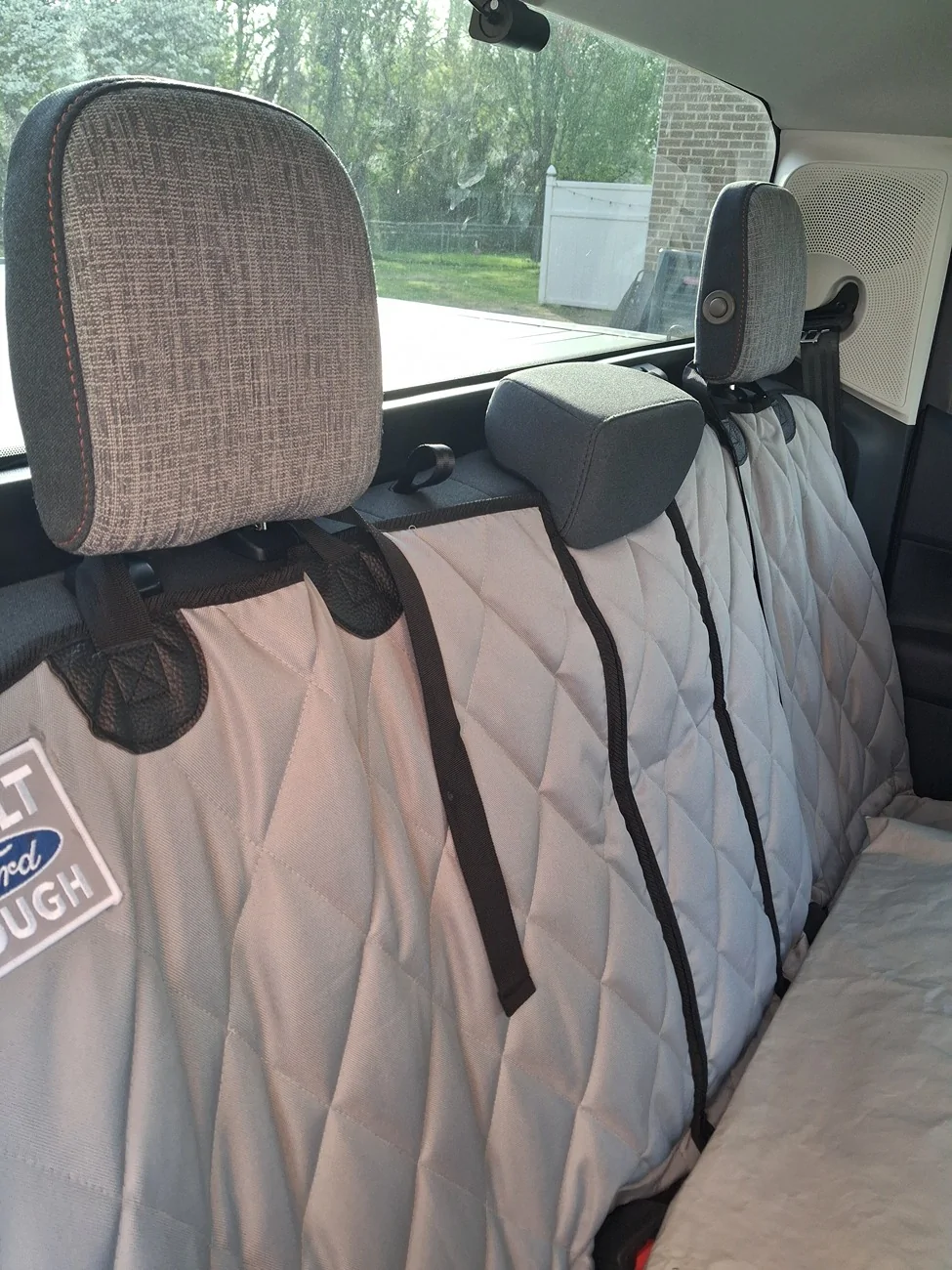

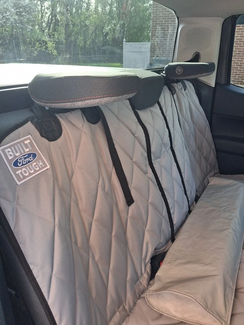

Excellent DIY. Definitely something I might look into.

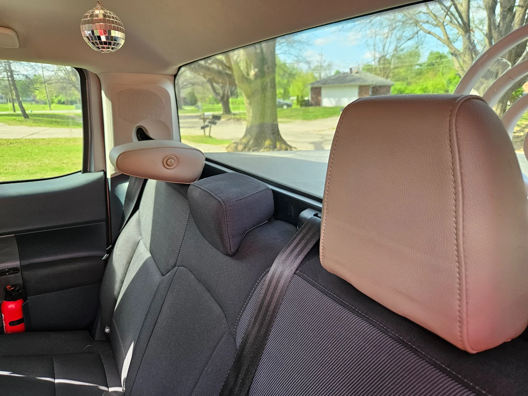

I occasionally use a seat protector that hooks on to the headrests when I watch my niece's dog.
Ford Maverick Fold down rear headrests (from F-150) installed in 2024 XLT Navy Pier interior Screenshot_2026-04-12-17-31-34-26_40deb401b9ffe8e1df2f1cc5ba480b12
It's all about convenience.
I like the view out the back without the headrest, I don't want the additional hassle of removing and reinstalling the headrest. When I put the seat protector in.
I would rather just fold them down when not needed fold them up when I need them

Good job OP.
Mine are stored under the rear seat 97% of the time allowing full view out the back window

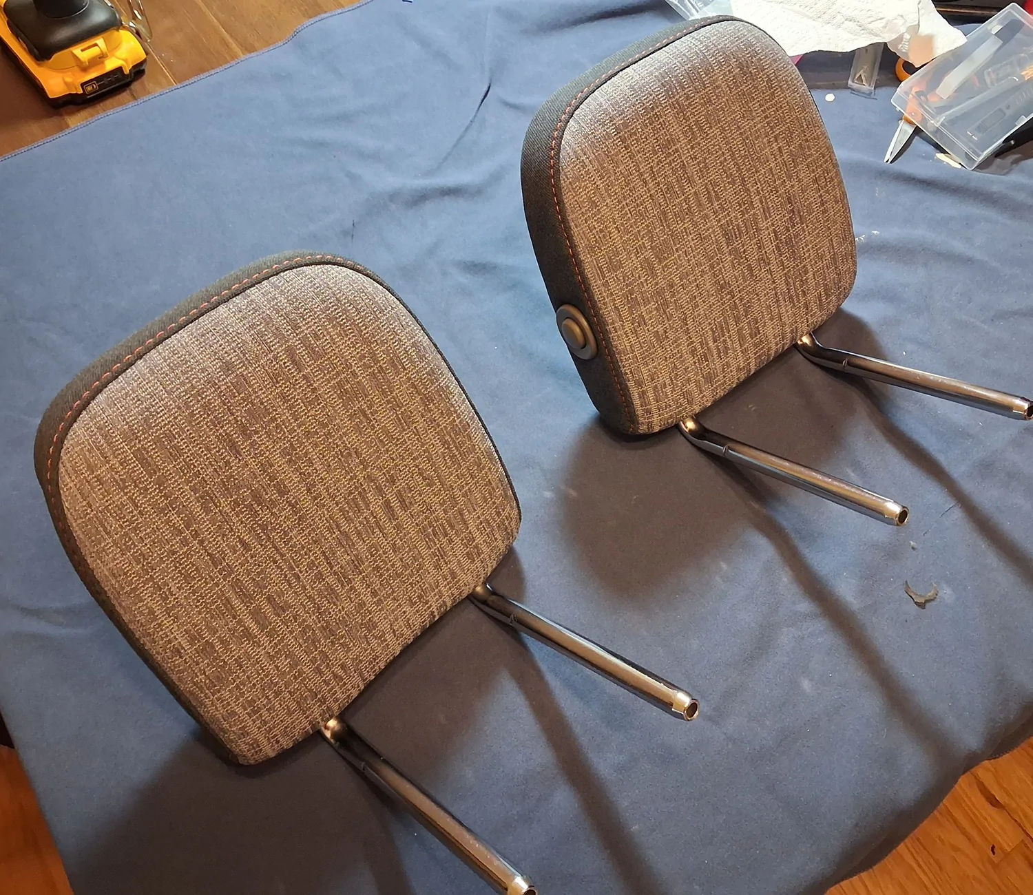

I bought a set from an Escape for mine.
HRG

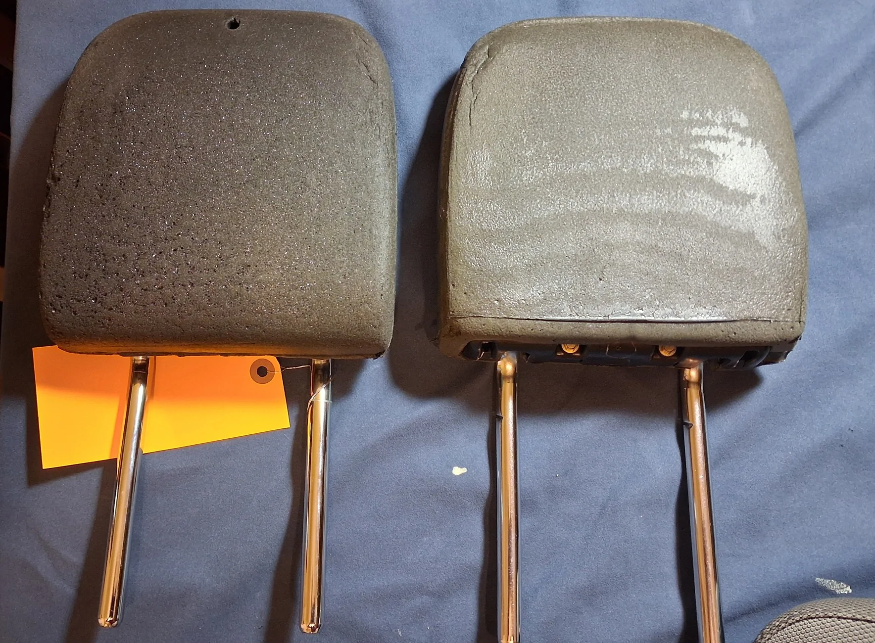

I got my idea from your original post. If I remember correctly you found headrests that matched without swapping covers? Nothing matches with navy pier, of course. I had to take it one step further. Thanks for the idea!

I got my idea from your original post. If remember correctly you found headrests that matched without swapping covers? Nothing matches with navy pier, of course. I had to take it one step further. Thanks for the idea!
Glad I could provide some inspiration. Nice job on the cover swap.

I’m curious - what interior color do you have specifically/were the Escape headrests a perfect match?
I've got a Lariat Tremor, so the Black Active-X interior. The Escape's are not a perfect match, but close enough for me. If the sun ever comes out here, I'll try to take & post a better pic.

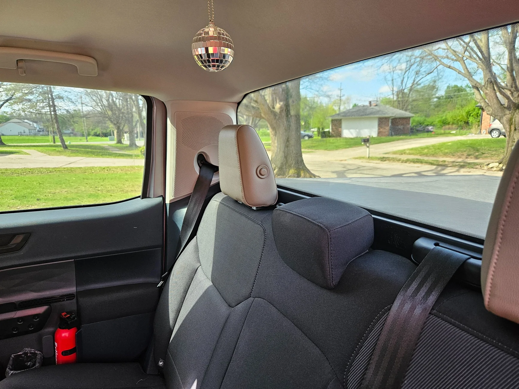

Here is mine - I will be installing seat covers in my maverick that I am hoping will match these headrests later this month, they came from a Ford C-Max:
