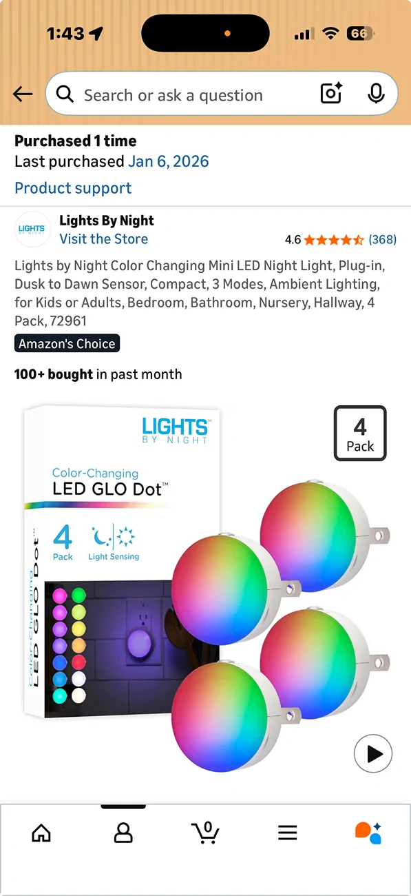

`I had a 2019 Ford Ranger that I owned for 5 years. The whole time I had it I kept a night light plugged into the AC plug in the passenger area. With the light plugged in the S/S was disabled for the entire time I owned it. I now have a 2025 Maverick and I do the same with the night light plugged into the AC outlet in the passenger area. That keeps S/S disabled as well. I've unplugged the light and the S/S will shut the engine off at stop lights. The night light thing has worked for me on two vehicles. The only explanation I have is the computers see a drain on the AC system with the night light and prevent it from shutting the engine off. You need to put tape over the sensor on the light so it will always be lite when the engine is running. Night lights are fairly cheap, other methods not so much.
Really? That's great!! I assume you mean the 'Cigarette Lighter' accessory plug? I would like to hear from others to see if this works for them as well.

I should have been more specific. Behind the rear console in the rear passenger area on some Mavericks is an AC outlet like you would find in your home. There is a 400 watt inverter that supplies 120V AC. You can plug things like an electric razor, toothbrush or other low wattage appliances into. I think it is an option so may not be on all Mavericks. My Tremor also has one in the bed area near the tailgate on the left side. The night light would be like one you would plug into a wall outlet in your home. I got mine off Amazon, but I assume you could get them at Walmart or Target.
