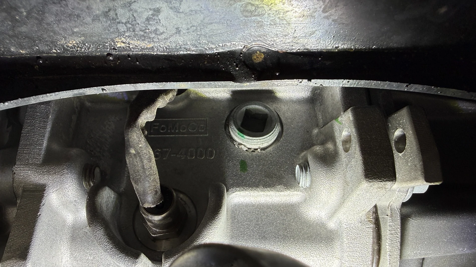

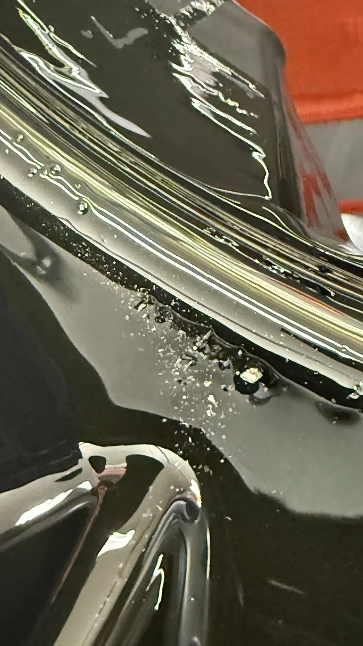

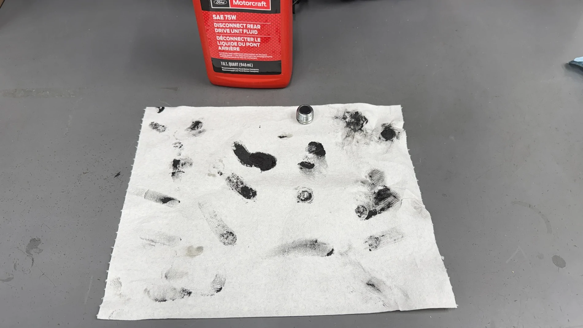

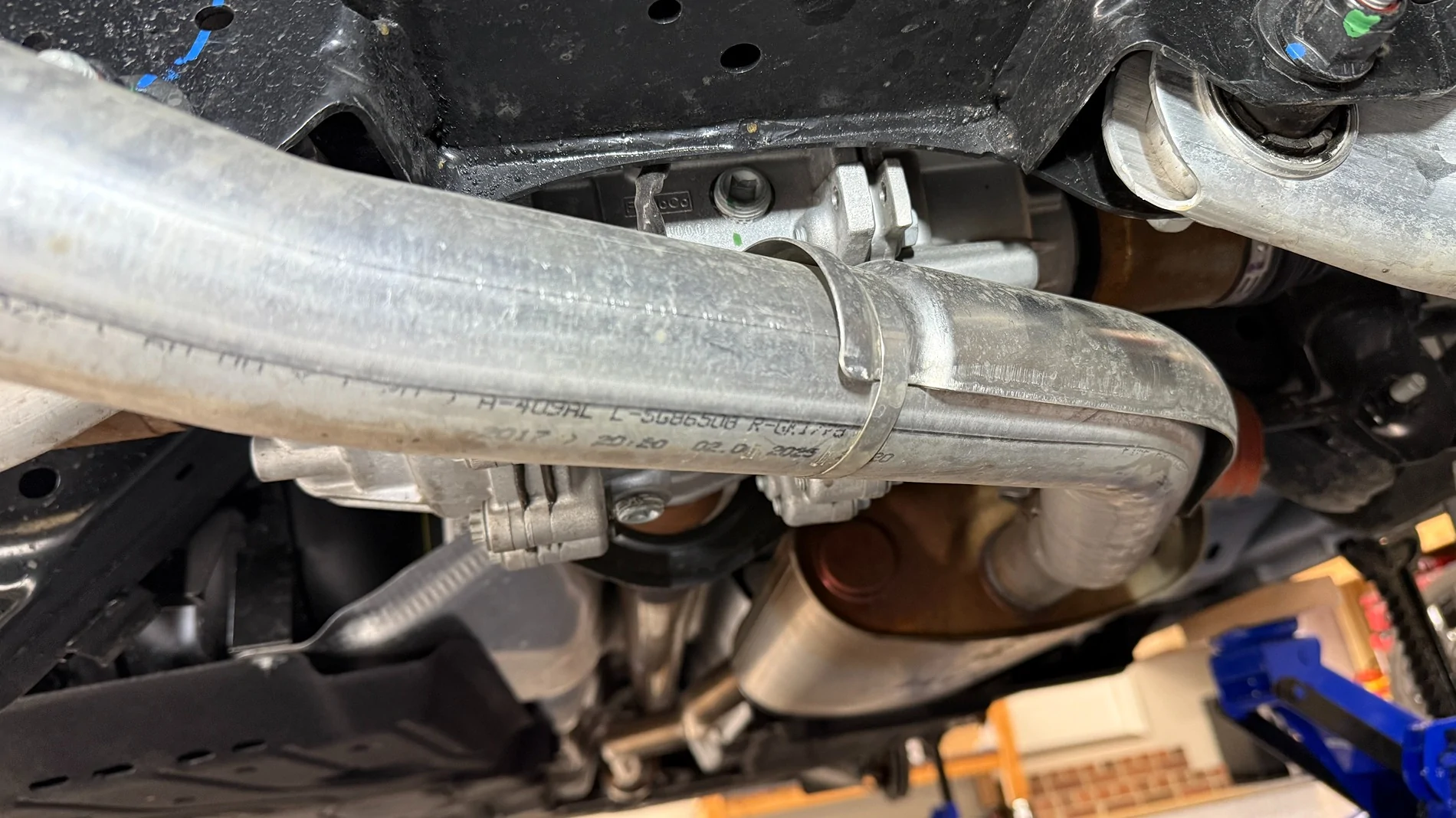

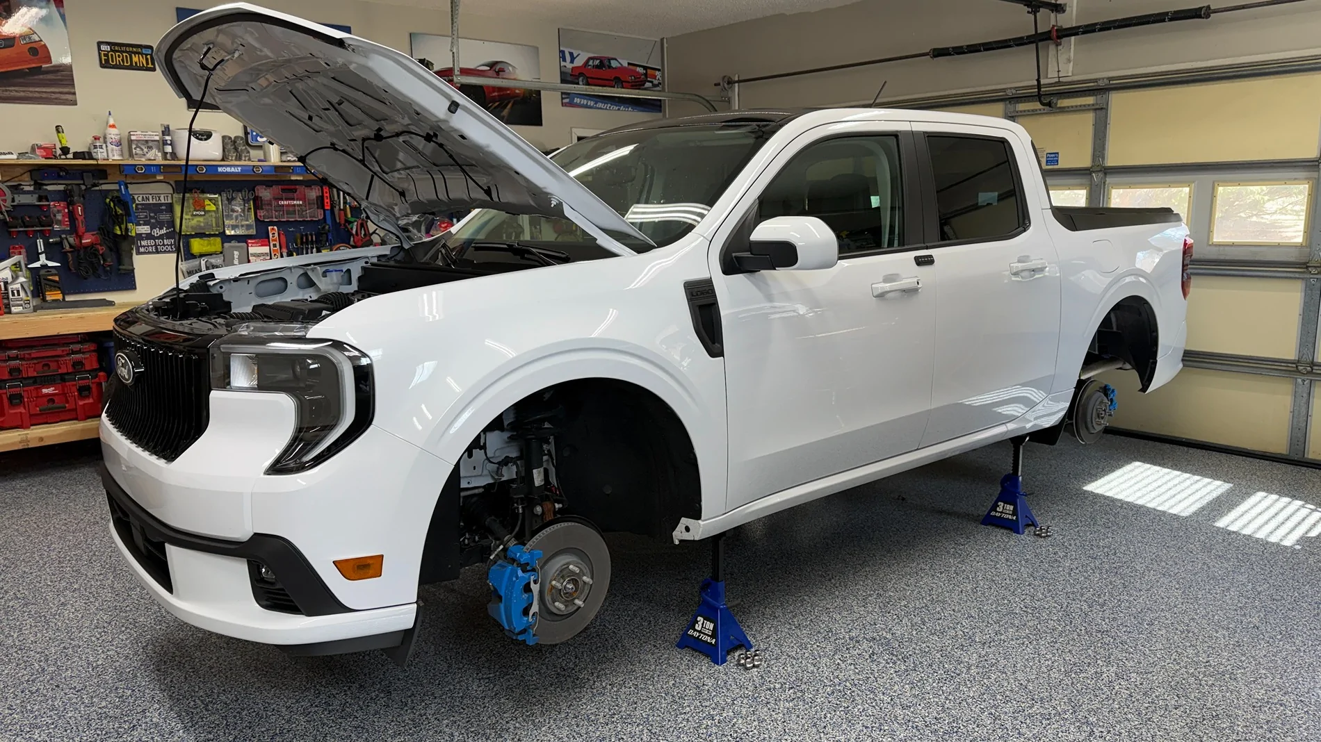

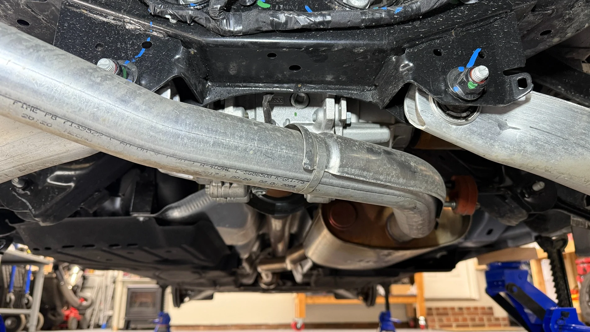

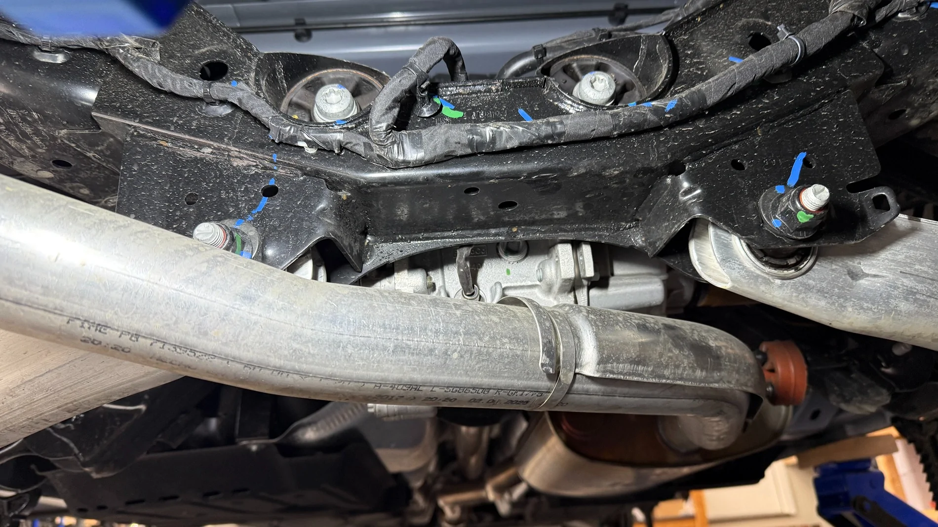

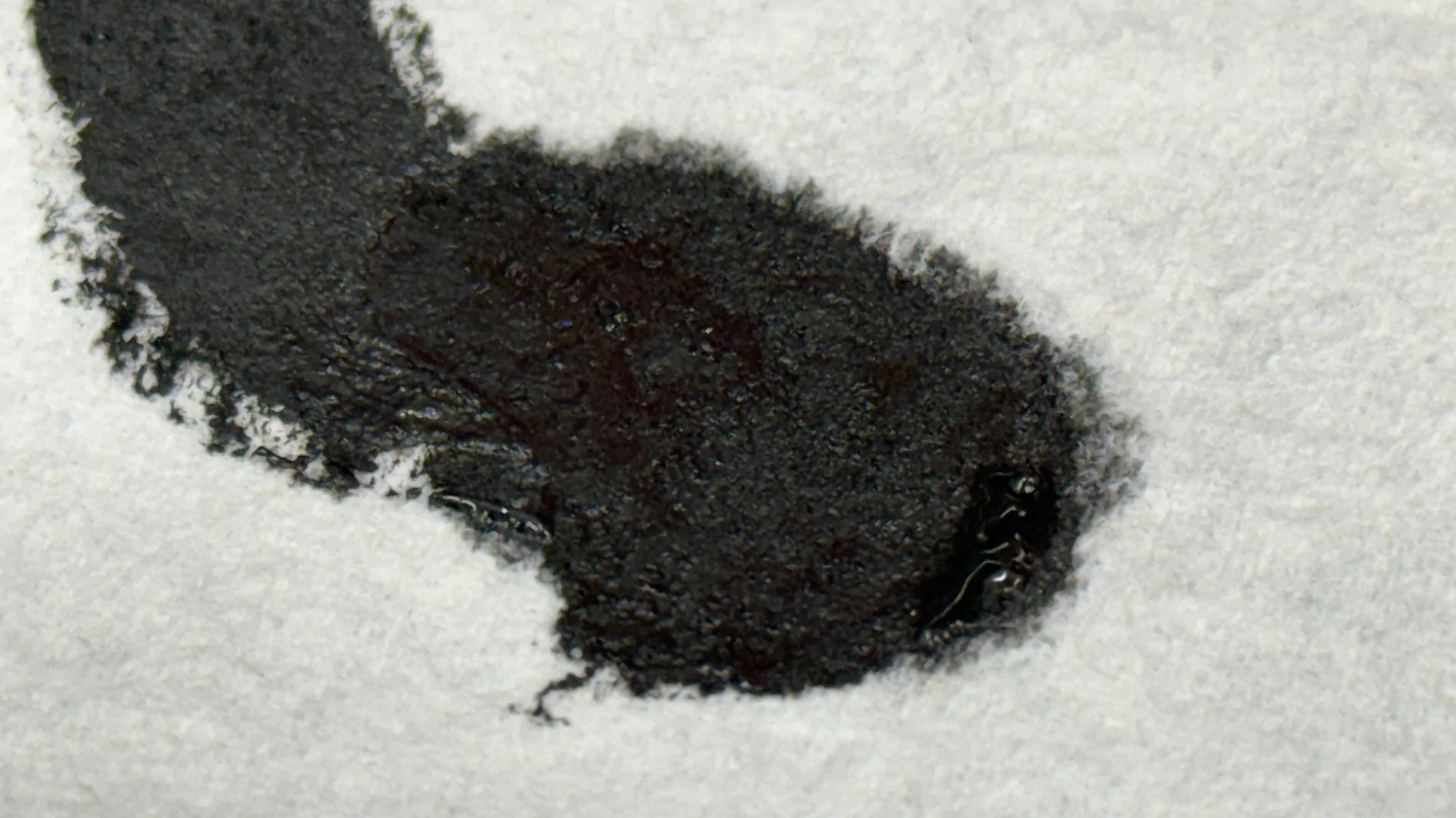

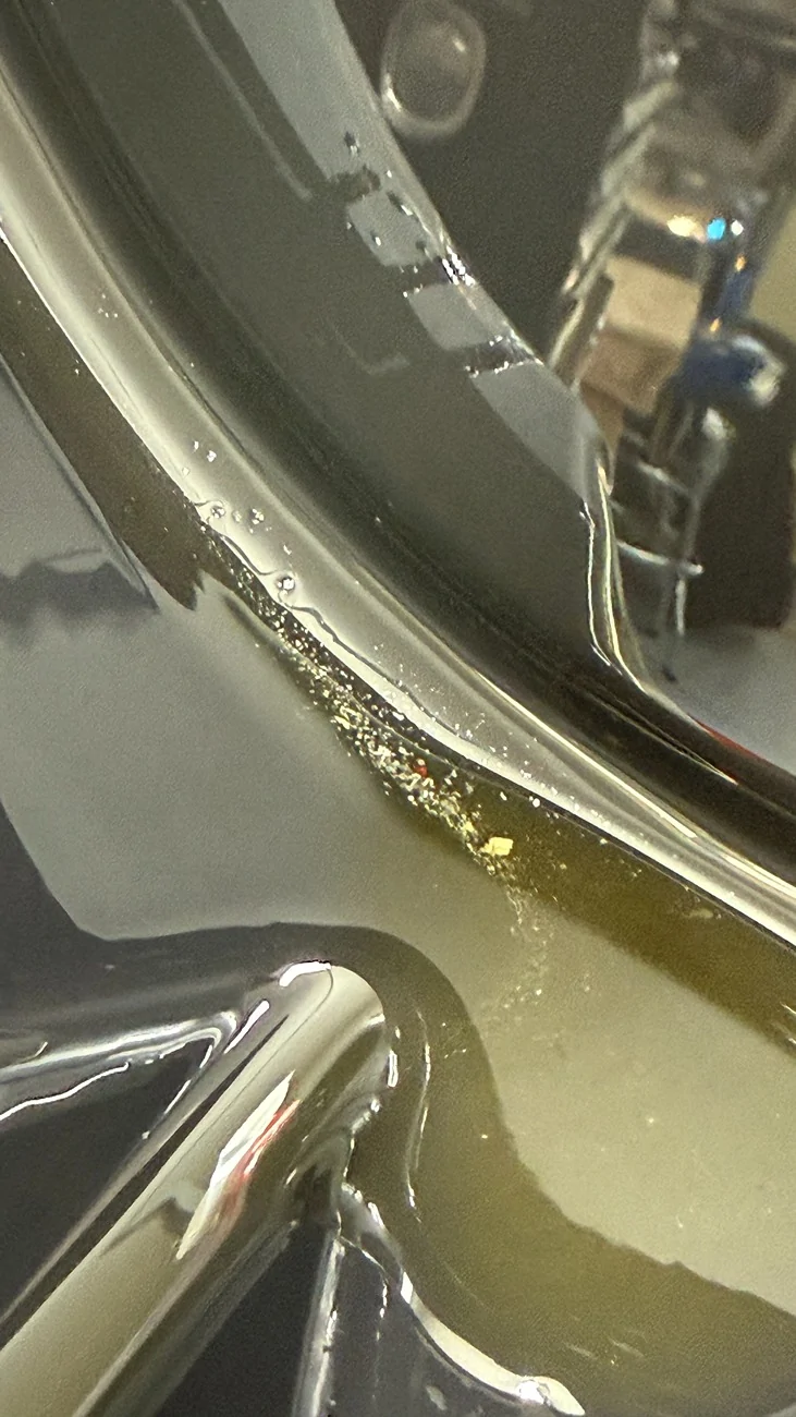

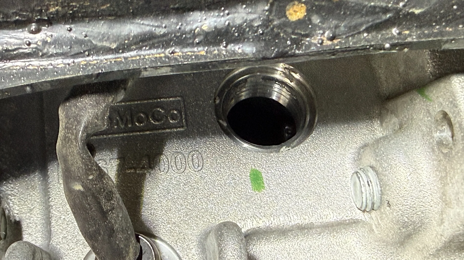

After seeing a few posts on here and on YouTube, I decided not to wait and change the RDU / PTU oil at 5,000 miles on my 2025 LOBO.
Photos and Videos below of my findings. TLDW/R = DON'T WAIT to change, or at least top-off your fluids in the PTU & RDU. For the life of me, I don't know why Ford is under-filling these units. Seems cheaper to fill them than replacing them, I've seen posts of 18K miles and needing replacement and while I'm glad it would be under warranty... I don't want the downtime and dealer visit if I can help it.
Apologize for the separate videos, didn't have any time to lump them into 1 and edit it all before wanting to post up.
- RDU Drain
- RDU Drain Pan
- RDU Drain Plug Metal
- PTU Drain
- PTU Drain Plug Metal

Pretty consistent with what’s been found so far. Good thing you did it early. Nice Maverick!

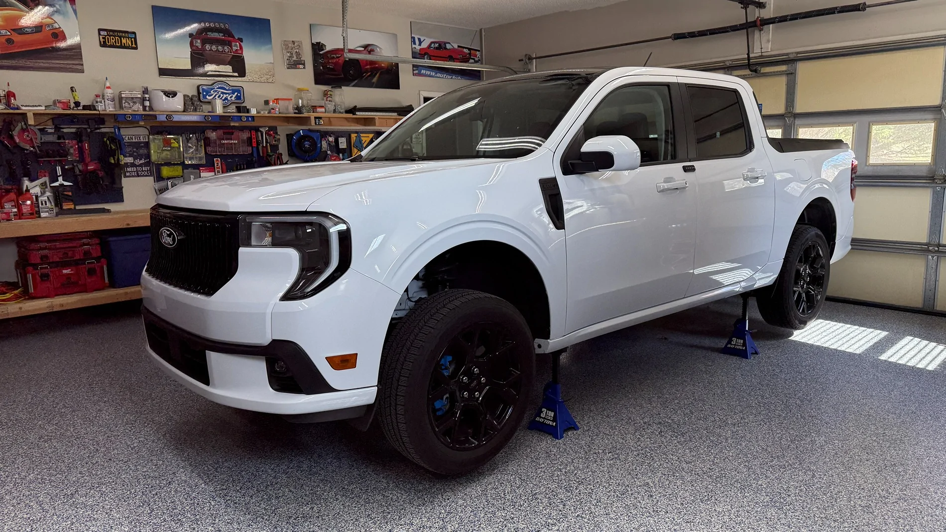

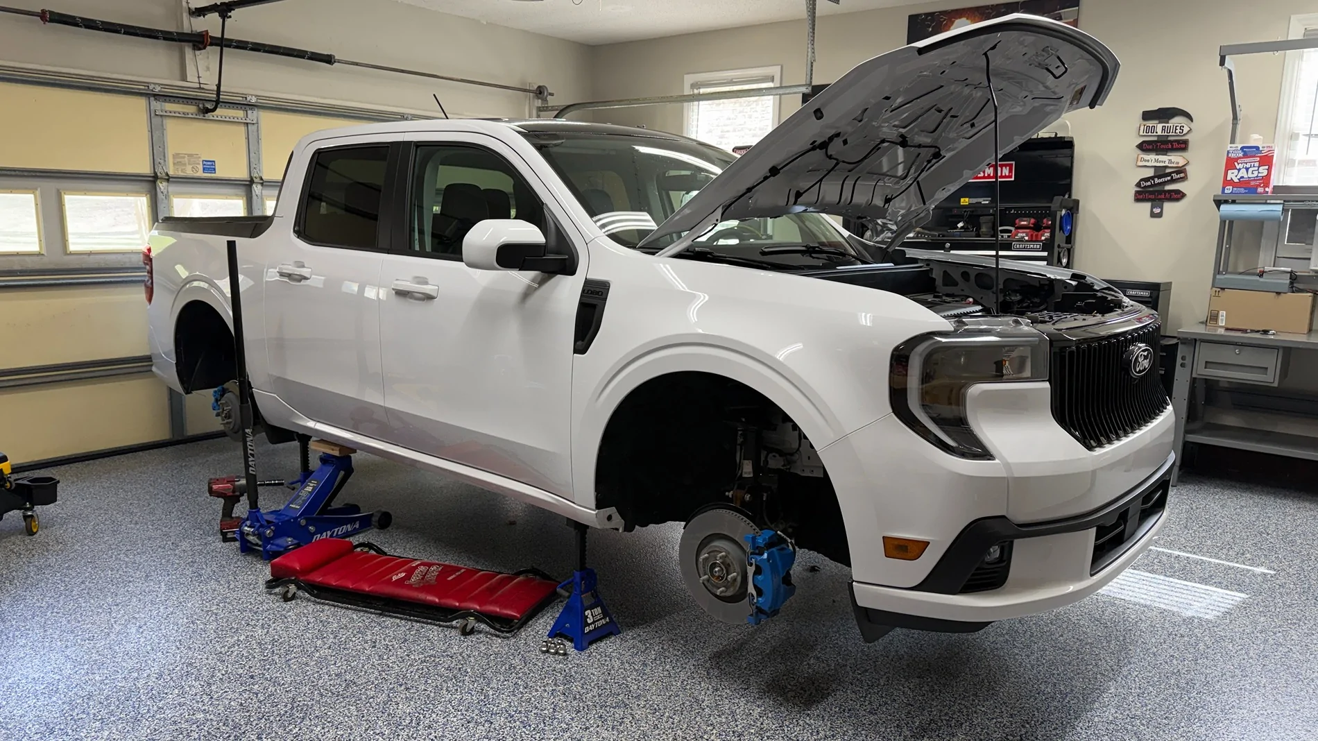

Question - do you think I can do RDU first on two rear 7inch ramps instead of truck being level on four jackstands? Then same way for in front for PTU?Does a slight tilt affect the fill?
Thanks for any advice!

I would absolutely recommend level so you get all of the fluid back into the RDU & PTU. Heck, now that I think about it, jacking up the rear only would allow you to slightly overfill it which probably wouldn't hurt.

I service the RDU flat on my back without stands, no problem. When I pulled the plug, a dribble of oil ran down the housing. It was full. The oil was clean and the plug had a fair amount of grit on it which has always been the case on all services done on many different brands in 58 years. This vehicle is a 2024 Lariat built November 7, 2024, purchased November 30, 2024.

Is that dirty oil or oil with friction modifier in it? Does it stink real bad? I remember rebuilding Mustang 8.8 rears and that modifier has a nasty smell. Handle with rubber gloves on.
That's a good point - seen some videos lately of mechanics commenting on the nasty smell of new spec'd lube/oil.
I guess buy some ahead of time to know what it smells like - in case attempting to give a smell check to what's already there.
