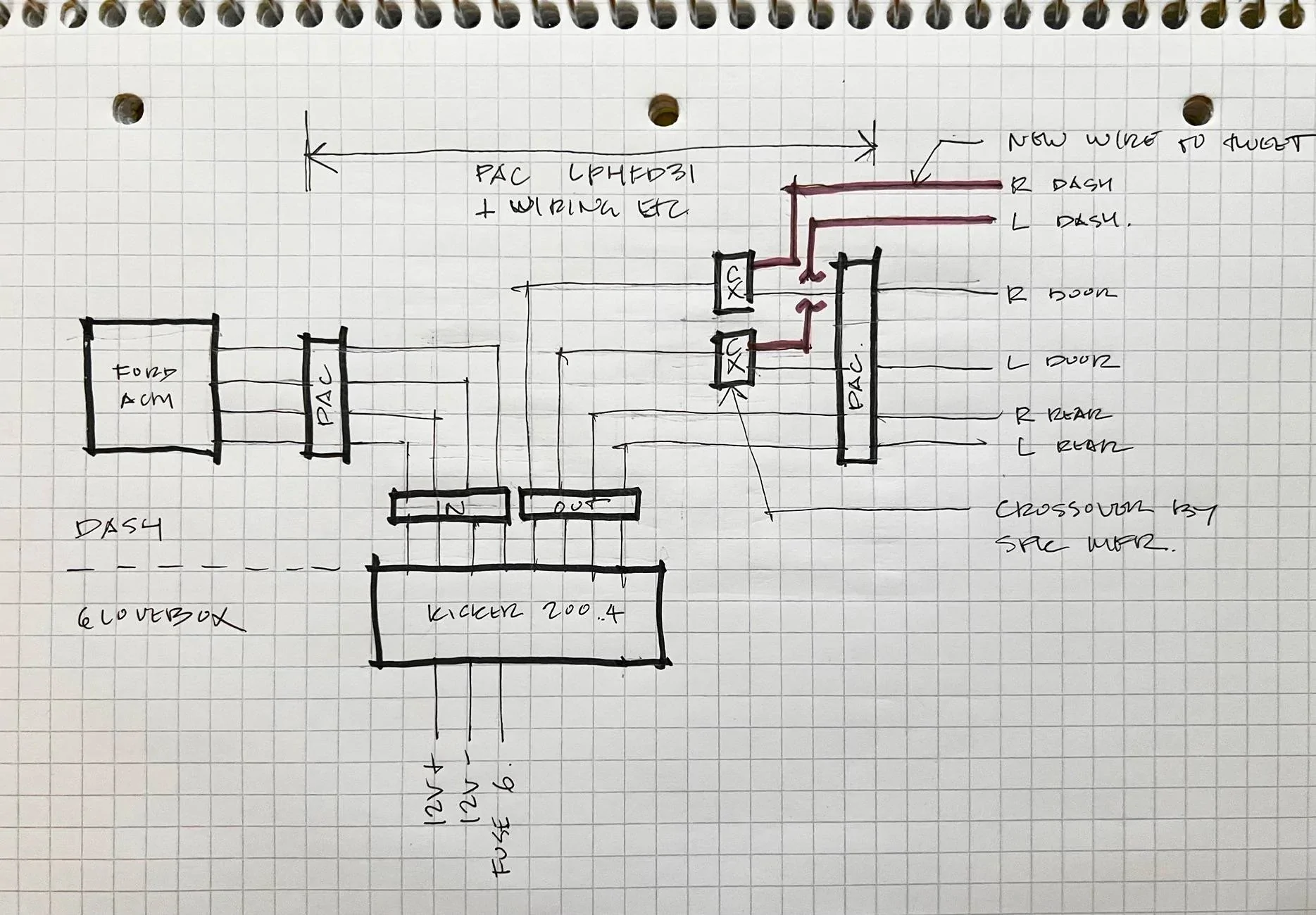

  • The component Kicker tweeters I used fit in the dash PERFECTLY... once you permanently cut off some little tabs in the dash cavities. The dash plastic is soft enough that a small X-acto knife will work for this, even cramped up against the windshield.
  • I abandoned the Ford leads to the dash speakers because I wanted to wire in Kicker's component crossovers. Running new wire down through the dash was no problem.
  • I mounted the crossovers inside the back panel of the glovebox with VHB tape. There is a tweeter level switch on them that is adjustable, so I can easily access that if needed.

Amp
  • This thread about amp mounting is clutch; amazing stuff. It's what forum communities are all about: I had to farm my bracket printing out (in nylon) but it's perfect.
  • There is a nice ground lug up in the passenger footwell on the right. If you have an Ecoboost and are putting a key 200.4 or other equipment up behind the glovebox, don't buy 10' of grounding wire lol.
  • Likewise, fuse 6 in the BCM fuse box (also in the passenger footwell) is a perfect tap for an amp remote turn-on signal - and you want to use a 12V turn-on signal as opposed to any auto turn-on function, because of this. I used one of these.
  • There is a rubber grommet in the firewall above the brake pedal that is a good spot to bring fused power in from the battery. I took the battery completely out temporarily to have better access to the grommet and for power cable routing under the hood. FYI the grommet is easily removable; I just took it out and poked a hole in it before putting it back.

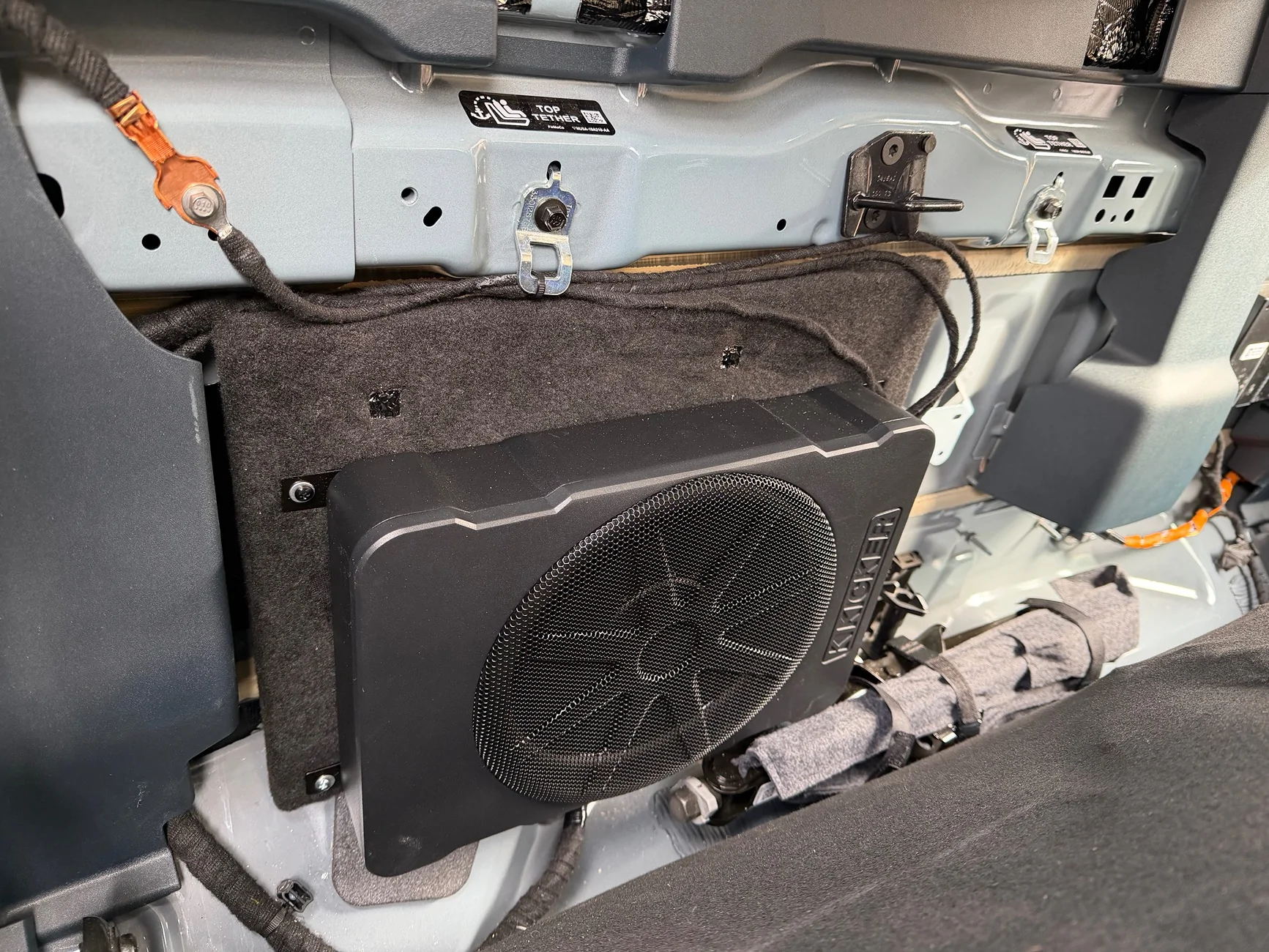

I lied. I did, in fact, need a sub. 😀
I lived with the setup as originally posted, but was not satisfied with the bass response at low-medium volumes. At high volumes the bass was better, and the system produced SPLs that set off hearing damage warnings on my smartwatch - but that level just isn't sustainable for the obvious reasons.
So, I have added an HS10 to my system using the same PAC harness kit. It works exactly like I thought it would. There are no LOCs or other devices needed.
The original four channels are still going via the PAC to a Key 200.4 behind the glovebox. I did enable the 200.4's built-in selectable high-pass crossover.
The addition was the PAC "Sub-T" harness. With that, I was able to split off the rear signals before they get to the 200.4. I ran those speaker-level inputs in shielded 4-conductor cable back to the HS10.
The rear speakers are fine after the new signal path, though I can still overdrive them if I push the volume too far. I may end up adjusting the Key's high-pass even higher, but I like what the door speakers are doing for now.
Depending on what that Sub-T harness is doing to the load, I could probably revisit the rear gain on the 200.4 as well. At the moment I have things faded dead center and it is just about perfect.
Finally, this system is good enough that it bumps when it needs to, AND I can hear details in the music I had missed before. Final bill is somewhere between $1,000 and $1,200, but that is including sound mat, wiring, wire loom, Tesa tape, and a few dozen crimp connectors etc. :beer:

Epilogue...
I have had my HS10 in for over a month and have been experimenting with various settings on the Key 200.4 and the HS10, as well as the usual head unit tone controls. I think I finally have it dialed in.
The Key 200.4 is still serving both front and rear channels.
I turned OFF the high-pass crossover on the Key.
I added 600Hz bass blockers on the rear channel outputs.
The HS10 low-pass crossover is roughly 80-100Hz.
Ford audio settings are treble +3, midrange -3, and bass flat. Fader is balanced front/rear.
Gain on the Key is set per the instructions; gain on the HS10 is set to "where it sounds balanced."
The Forscan changes I originally made are still in place.
So what did this get me?
With the Key high-pass crossover set, the bass was far more directional than I thought it would be, even set at 60Hz. The door speakers can produce a lot of bass, and I never had any issue with them. Shutting them out with the Key crossover seemed to send all the bass to the sub, which was so obviously coming from the back, it was distracting. Turning the crossover OFF helped my setup immensely. Takeaway: even with the sub, the upgraded door speakers do a fair bit of lifting with respect to bass frequencies.
As I have said before elsewhere, the small KSC40 rear speakers cannot take 50W each of full-range signal. They just do not have the range of motion, even if they could reproduce the lower frequencies. The answer in my case was the bass blockers. Yes, I may have exacerbated the issue by setting the rear speakers to "full range" in Forscan, but at least with the bass blockers, there are many available frequency ranges to choose from, and thus you can make adjustments - unlike the on/off nature of the Forscan setting.
This is nearly 400 watts of total power. The OEM volume setting of 8 (out of 30 I believe) is good. 10 is "enthusiastic." 12 is jammin. 14 gets attention. I had it at 16 for maybe 30 seconds to listen for distortion, and now my ears are ringing. According to my smartwatch, we hit 98 dB at some point. Test music was NIN "Pretty Hate Machine," B-52s "Cosmic Thing," Fleetwood Mac "Rumours," Def Leppard “Hysteria,” and GIFT "Illuminator."
I was pleased before, but now it is properly set up, and I am duly impressed. Not bad for an old dude doing this in his driveway with mail-order stuff. :sunglasses:
