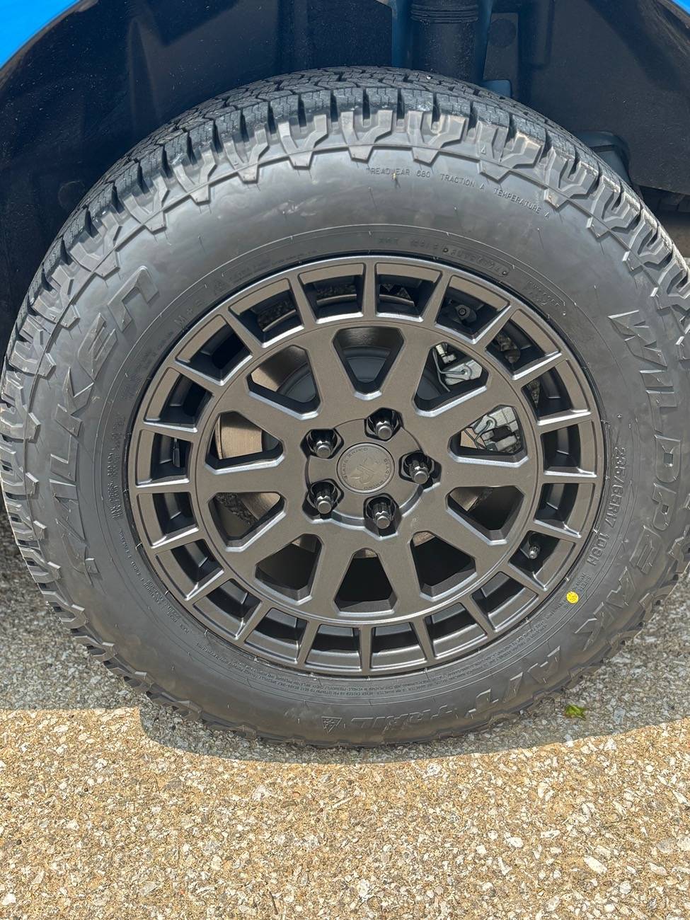

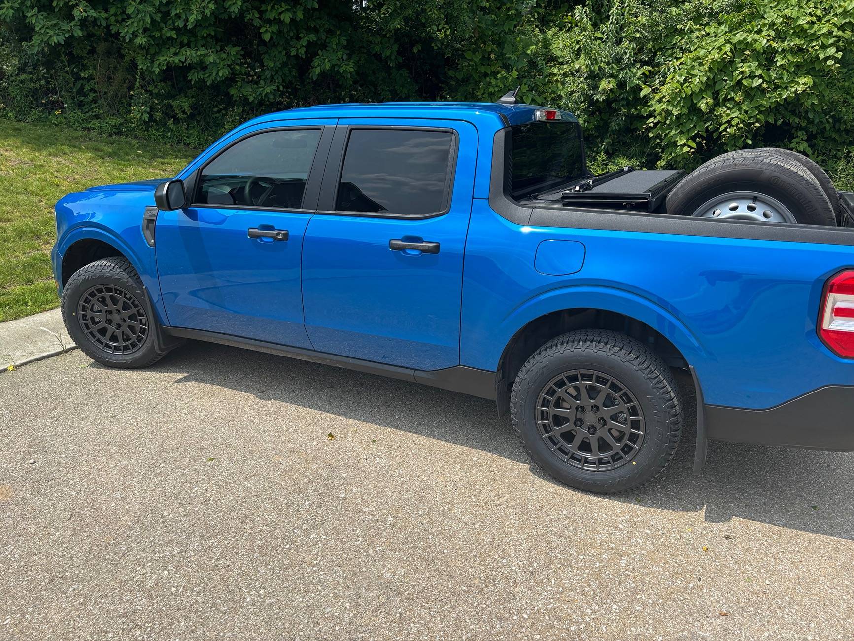

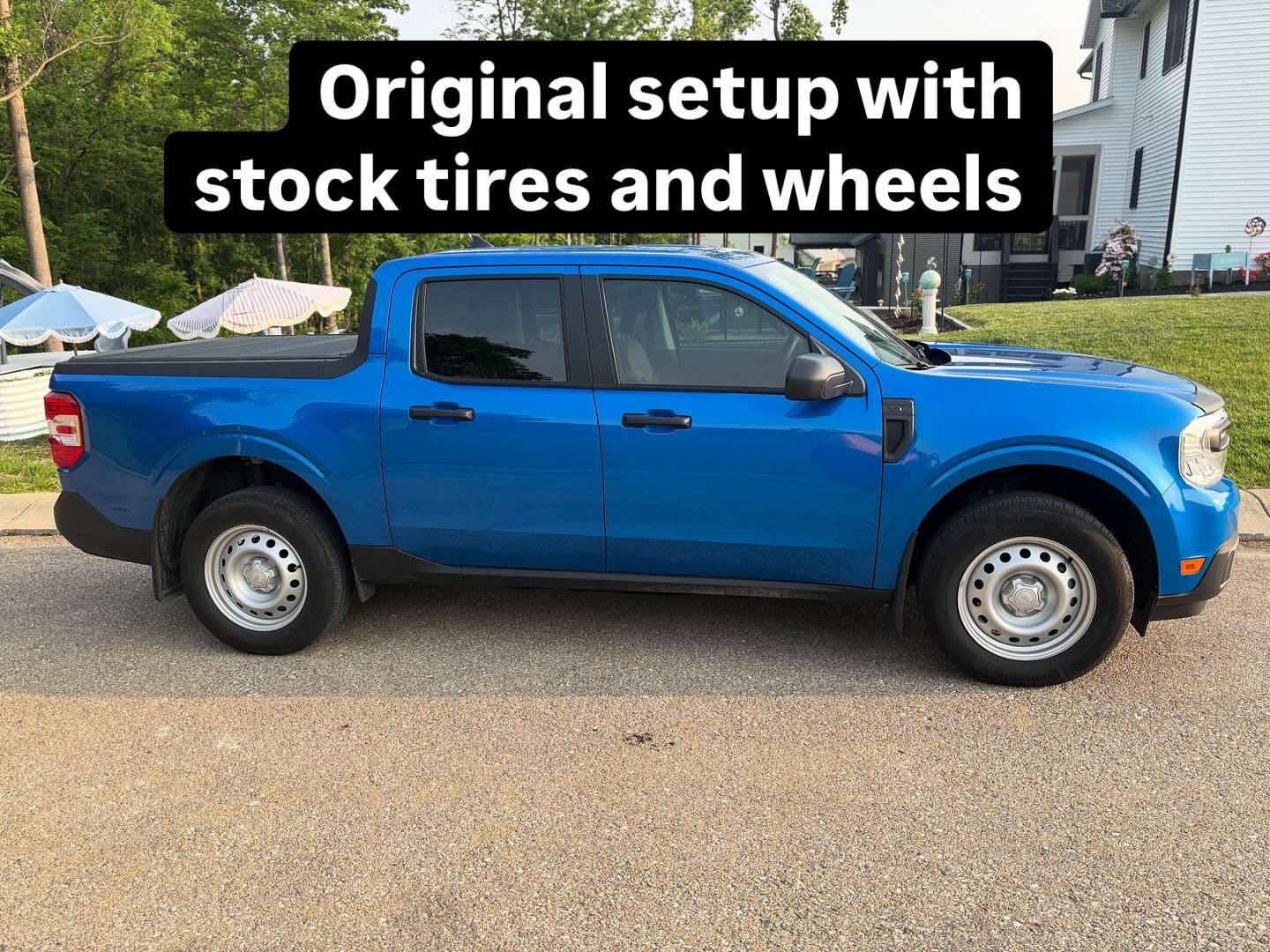

Hey everyone!
Just wanted to share my latest upgrade on my 2022 Ford Maverick (Velocity Blue)! Got new wheels and tires installed this morning, and I’m seriously pumped about how it turned out.
Wheels: 17” Black Rhino Boxer in Gunmetal
Tires: Falken Wildpeak AT Trail – 235/65R17
I initially tried to go with the 245/65R17 Wildpeak AT4Ws, but they rubbed a bit at full lock. I swapped to the AT Trails in 235/65R17—no rubbing at all, and I think they still give the truck a great stance. Fills out the wheel wells nicely without overdoing it.
Ride quality has stayed really smooth, which surprised me in a good way. It feels more planted, and I swear the hybrid has a slightly more aggressive sound now—like it knows it’s rolling on chunkier rubber.
While yeah, I’ll admit the aesthetic upgrade is a bonus, I do plan on using these for some light trail exploring and fire roads up in the national forest when I get the chance. The snow in Indiana can be nasty in the winters, so these will also help mitigate the FWD setup. Figured it was time to have a setup that can handle a bit more than pavement when I need it.
Appreciate all the advice from this forum—it really helped me choose a setup I feel great about. Let me know what you think or if you’re running a similar setup!

The wheels and tires look great! I think the "on road" all terrain models like this are the right category for most Maverick owners and their uses.
Kudos for being specific about model. I can't tell you how many times there's a fitment thread and the commenter says, "I have Wildpeaks in 2XX/6X R17" and don't say what model. That's frustrating.

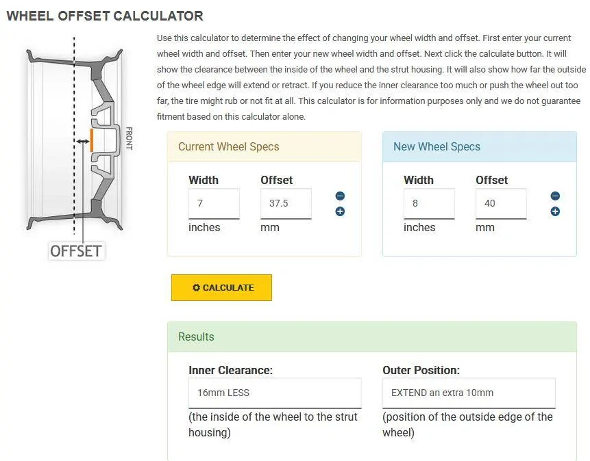

looks good. those wheels are very light with a claimed 21 lb, did you happen to weigh them (even on a bathroom scale) to check? I did see they also have a 1375 pound load rating, if we consider the rear wheels with a full payload of 1500 pounds in the bed, that's probably right near the max rating, but should be fine.
I'm pretty surprised the 245/65-17 wildpeak at4w rubbed. those wheels are only 16mm less clearance than stock on the inboard side.

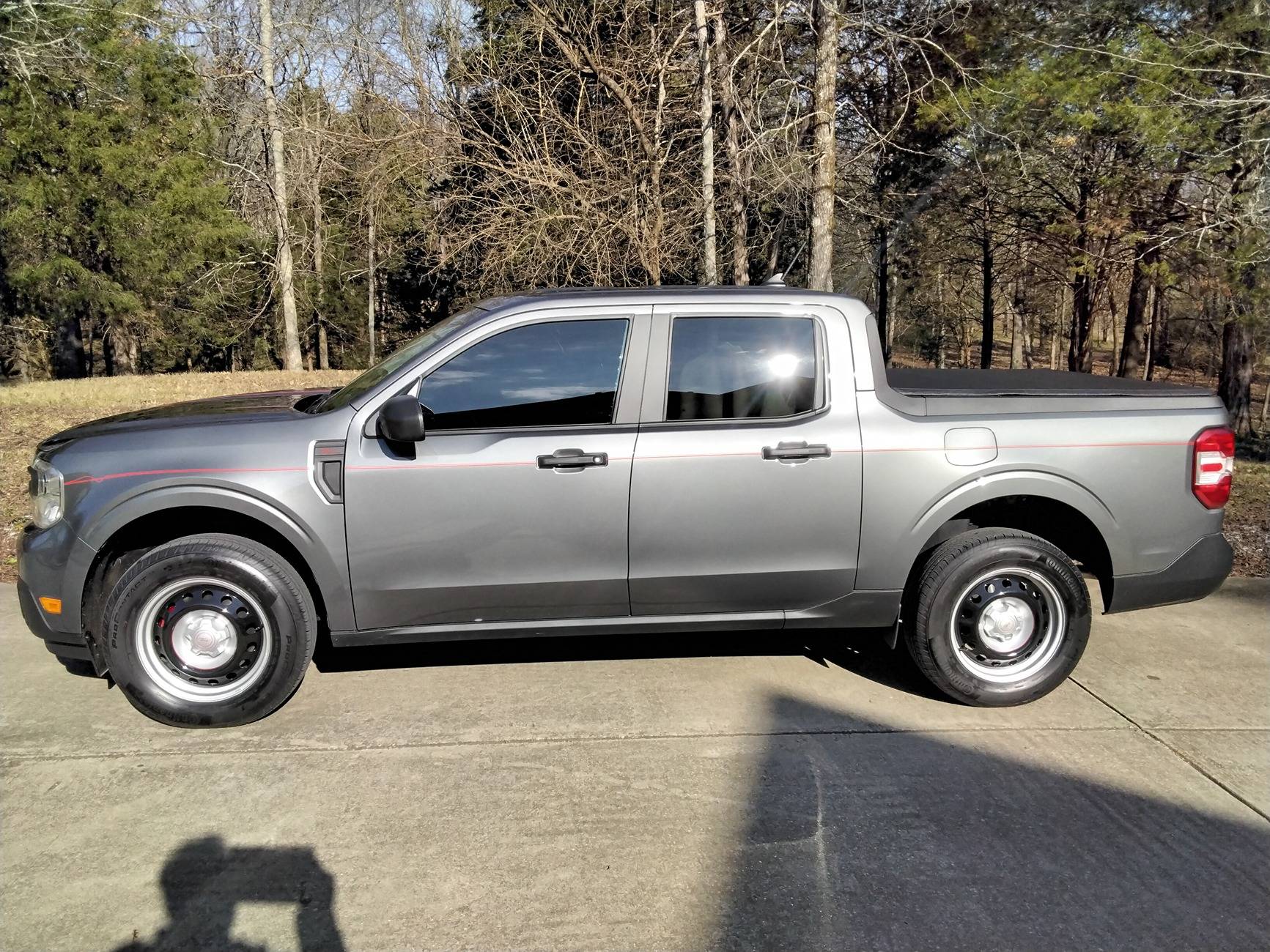

I'm keeping steel on my cactus gray.
Upgraded tires to Wildpeak AT3W stock size 225's about a year ago.

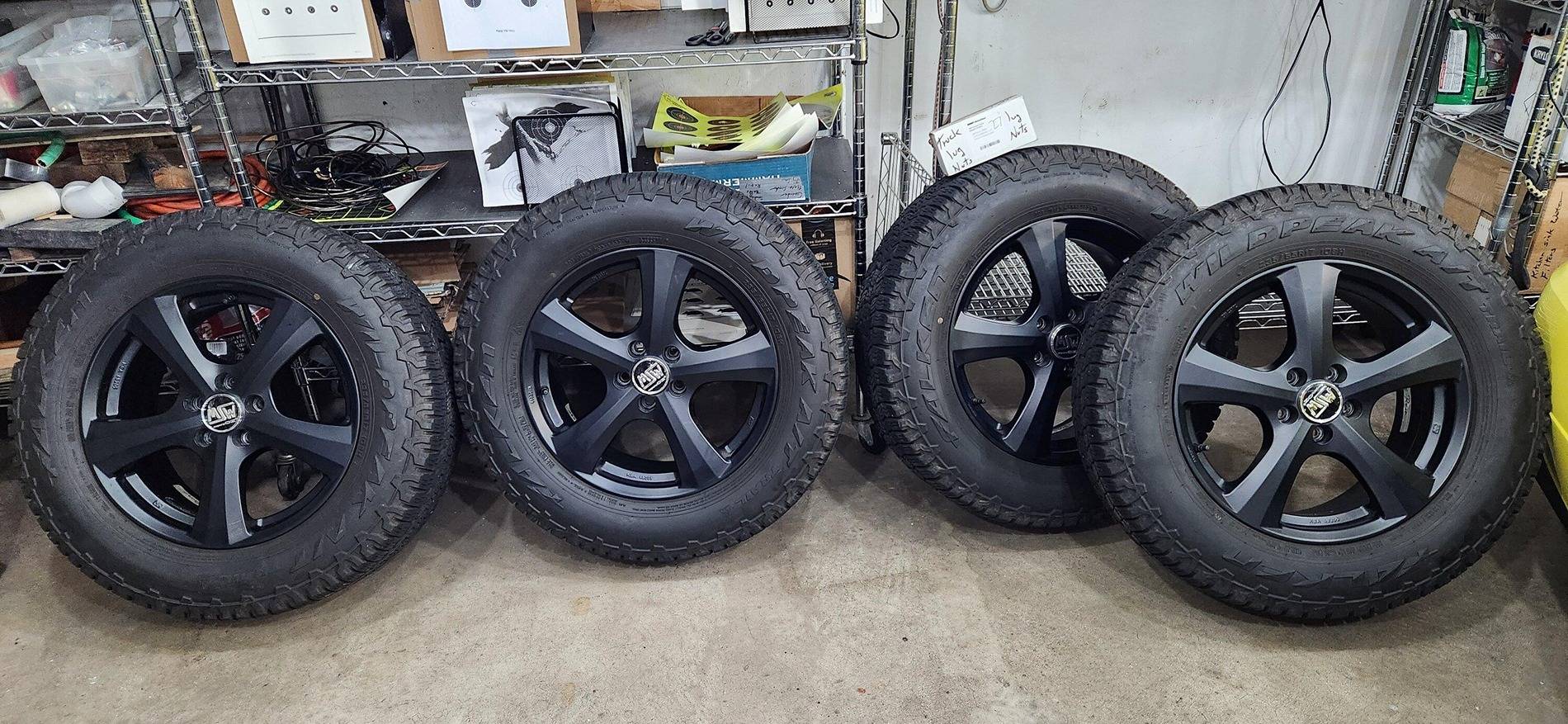

Yr gonna love those tires! 3Peak rated and handle great in Snow, slush and rain! Dry is very very good as well.
The only downside will be for you is the slight drop in MPG. But other than that they are phenomenal tires. They are what I have for both Summer and Winter sets.
Summer I have my OEM Carb Grey Aluminum and for Winter is a set of MSW black wheels. I didnt want the salt to ruin the OEM Carb Grey as they matched my rig perfectly.

Thanks! I haven’t weighed the wheels myself yet, but I might try using a bathroom scale just out of curiosity. Good to know the 1,375 lb load rating is cutting it close on the rear axle with full payload, but still within spec — that gives me some peace of mind.
And yeah, I was surprised too that the 245/65-17 Wildpeaks rubbed. I figured with only 16mm less inboard clearance compared to stock, they’d fit fine. Might’ve just been tight tolerances or the sidewall bulge causing it. Either way, I ended up going with the 235/65-17 A/T Trails and they fit great with no rubbing.
