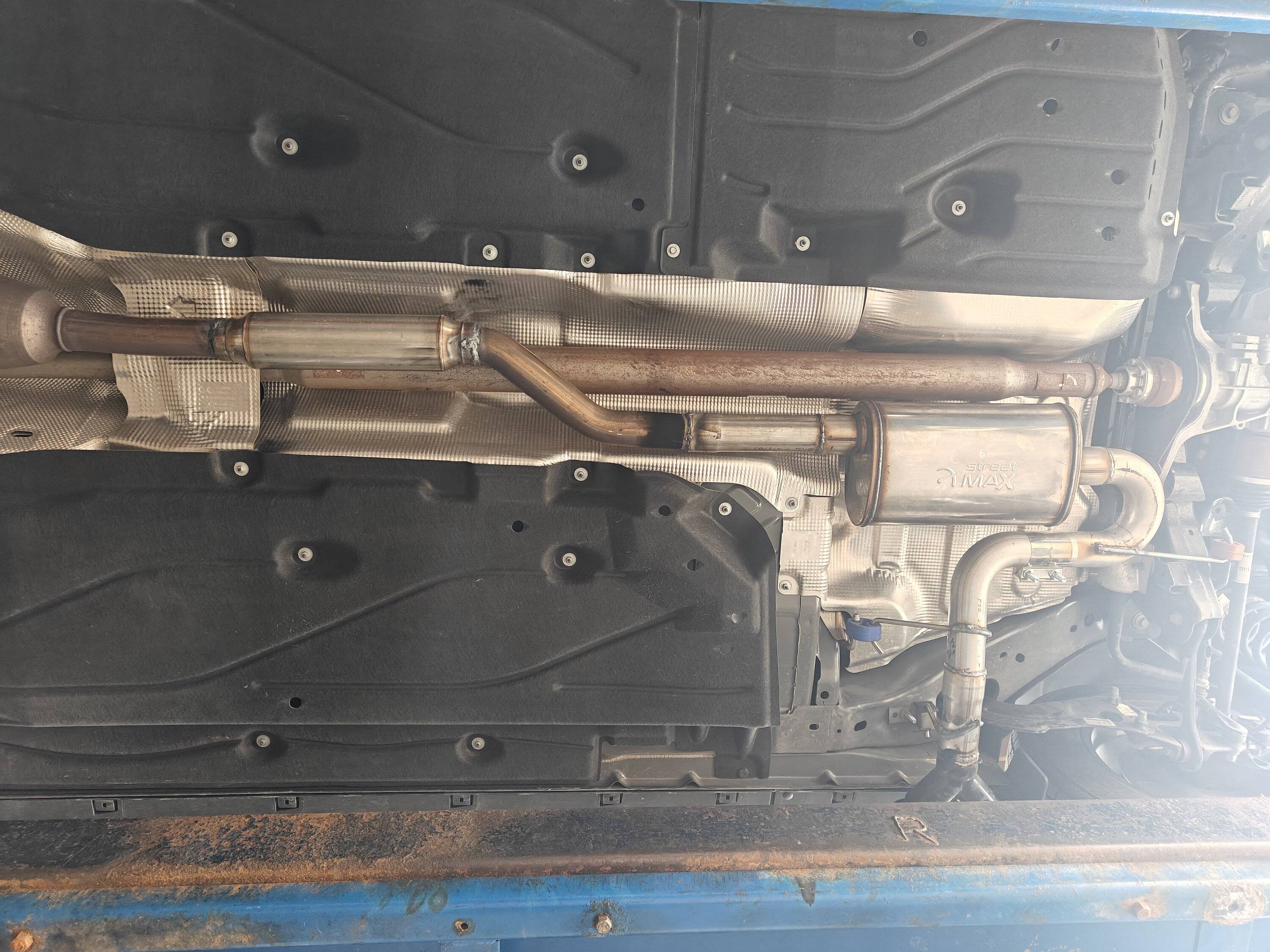

Took out the Aero Turbine today. It sounded awesome but just to loud for an everyday driver. Here's what's in it now.
Street Max 12226 (Magnaflow same part#)
Aero Resonator TR253
Street Style Tip SS4025114CF
180° mandrel bend
90° mandrel bend
Turned out perfect! At startup and under normal driving conditions it's mildly louder than stock with more Bass. No drone...zero! When you get on it it wakes up, gradually gets much more rumble but not obnoxious or intrusive, that full throttle you can hear the turbo whine.
Updated with video sound clips:
Ford Maverick Side exit exhaust #2 DIY'd.... Nailed it!! (added sound clips videos) IMG20250530170313
180° mandrel bend
90° mandrel bend

Nice 3 inch?

Nice 3 inch?
It's all 2.5. the factory pipe mics out around 2.375. going 3-in on a side exit while not impossible would pose some difficulties. The radius on the mandrel bends is larger,
