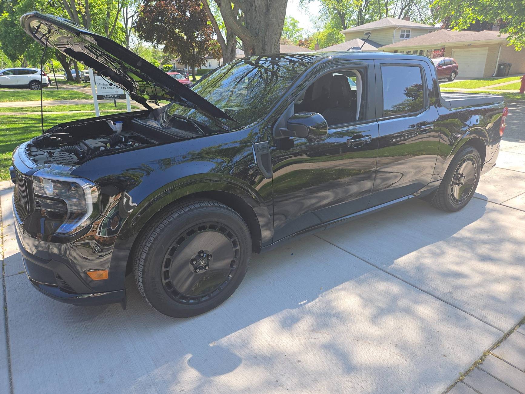

The black wheel rims on a black truck look great.
I do like the look.
But I spend a lot of hours in mine and I put substantial weight in the bed frequently so I value a soft ride.
But this is a great truck to lower.

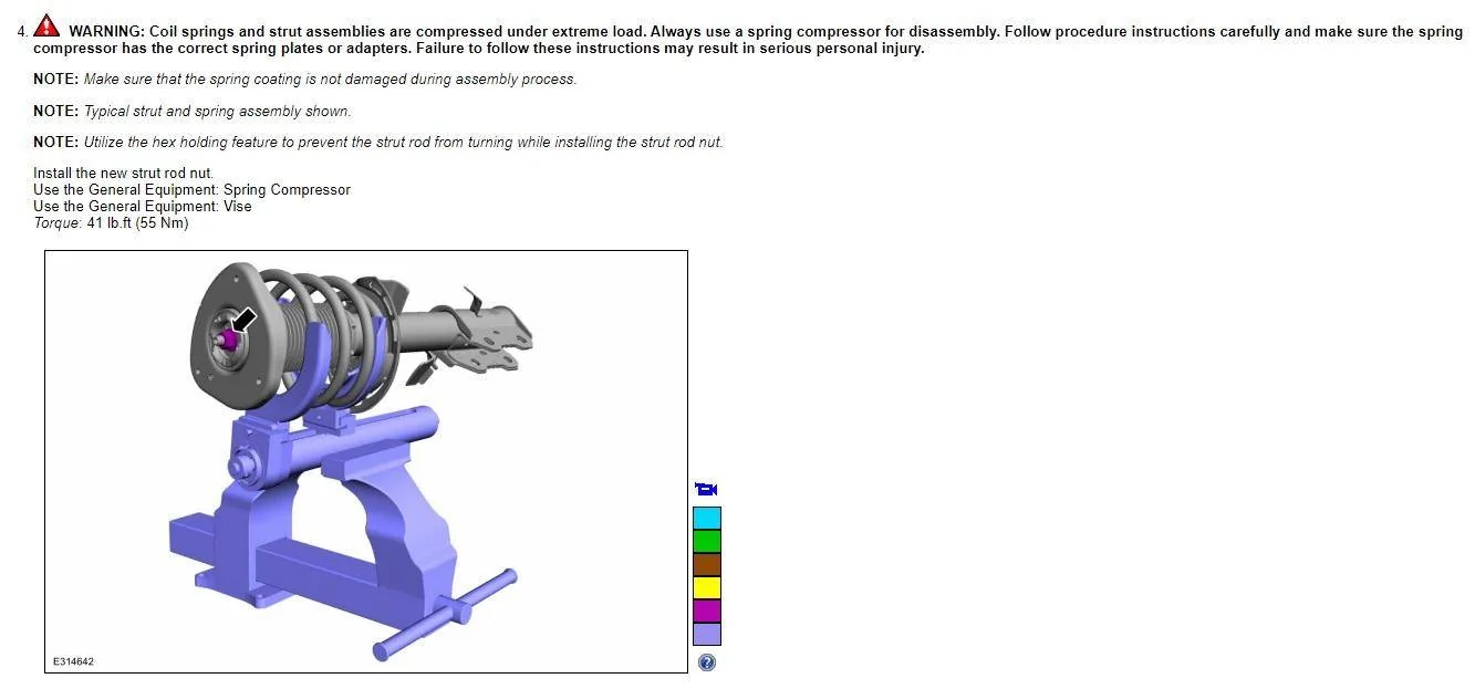

What are they torqued to?

Sure would be handy to snag up one of those spring compressors in the pic
Lobo looks great lowered! I have the Goodwin's at the house awaiting a free weekend so I can install
I dunno, it's clamping only in one place, which to me seems a little iffy even though it does have a lot of contact, on roughly half of the coils.
I borrowed a spring compressor from Autozone. It's a $55 deposit which gets refunded when you return the tool clean and in good condition. it has 2 clamps so you can compress the spring equally and it doesn't bulge out.

Nice. I feel like my FX4 is already painfully low from the factory given its mission statement, but the stock Lobo is just begging to be lowered. Looking forward to seeing more of them with the ride height "corrected." :)
Its clamping from one side but its about 2/3s of the way around. Im sure they've figured it out.
