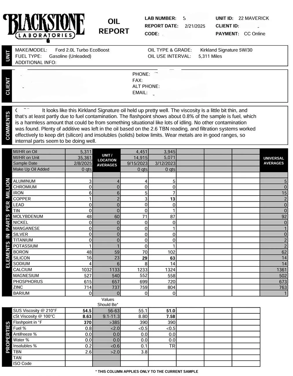

Ford Maverick Kirland Signature 5w-30 Oil Analysis for 2022 XLT Ecoboost Fx4 4K tow. 35,000 miles. Screenshot_20250221_224506
35,000 miles. Strictly Kirkland Signature full synthetic 5w30 from the time I purchased the truck.
5000 mile oil changes still look good and the oil still seems to hold up and maintain the additive package.
I do idle a bit more in the winter to warm up the truck and that's why I have a little fuel in the oil. Not enough to cause concern though.

Looks great! No reason to not use the Kirkland that I can see.
Thanks for sharing.

Its warren petroleum . Same manufacturer a most supertech , but probably a better ad pack .
I have some 0w20 here . It will be in my Maverick as soon as Ford stops giving me free oil changes .
