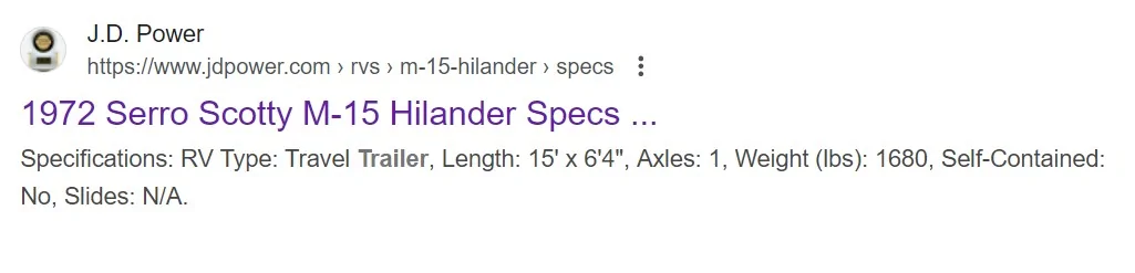

Agreed, but when new, back in 1972, the OP's trailer weighed 1680#.
