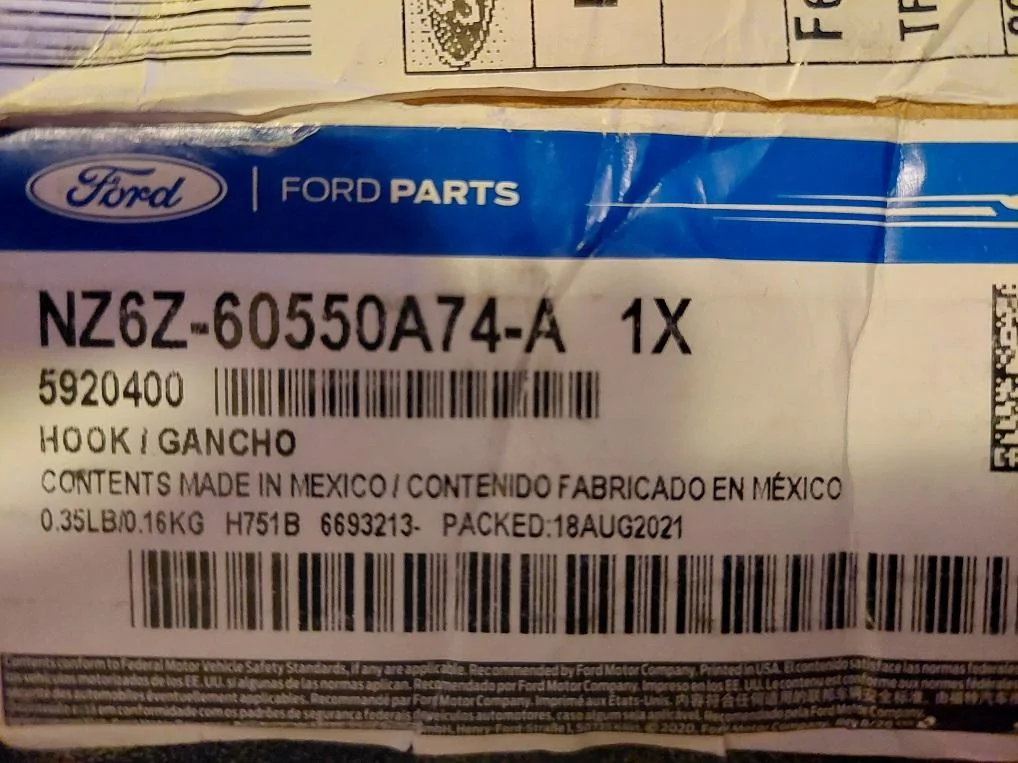

Since I purchased an XL Maverick my truck did not come with all of the D-Ring and side tie down points that the XLT and Lariat have. I added them to my truck today. Not sure if they have been posted here yet but for anyone wanting to add these to their XL truck Maverick, here are the part numbers.
D-Ring Front Floor NZ6Z 60550A74-A
D-Ring Bolts Floor W721941-S450B
Rear Tie down D ring side 5176389-YL3Z-9900064-AAA
Rear D ring side bolts W718208 S450B

These just add the same hardware that the XLT and Lariat come with. Two of each or one for each side. The holes are there, you just need to run a tap through them.

vezpa where did you purchase the d-rings from? I tried using the part number that you provided but its not coming up.
Thanks

Ford Maverick Factory OEM FORD part numbers for Maverick bed D-Rings and rear side tie hooks for XL (with installed pics) D
