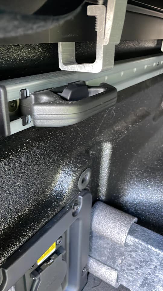

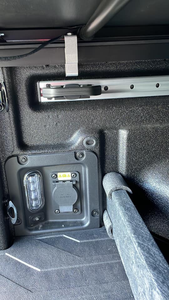

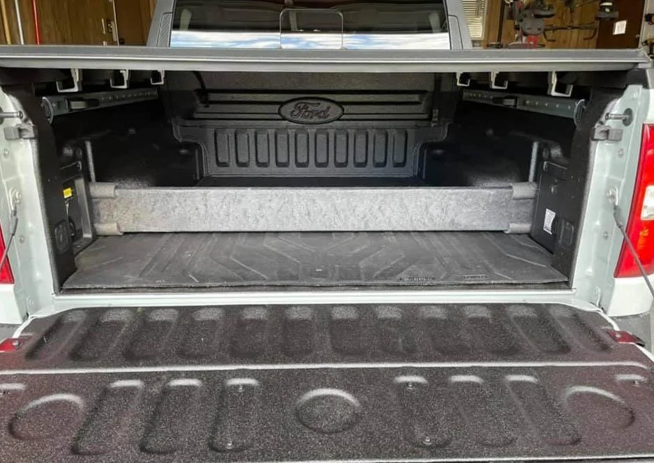

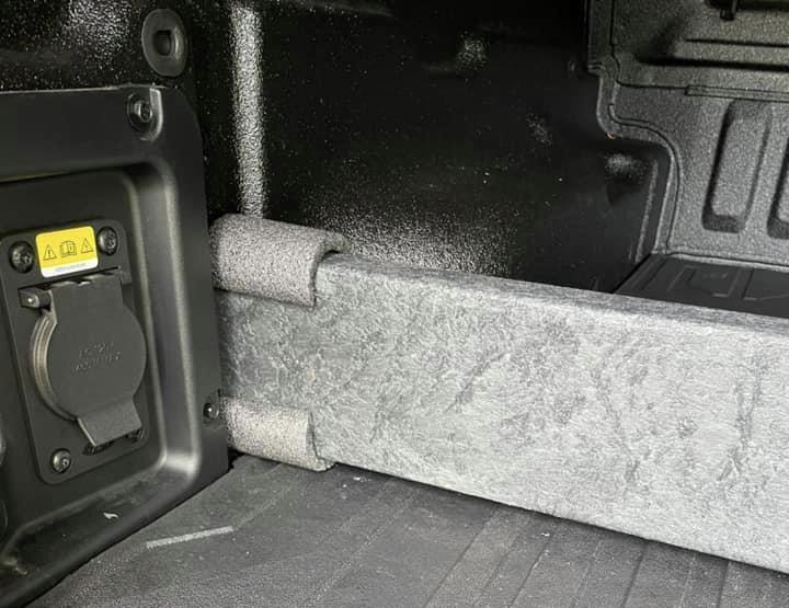

I stole this from a FB page just to share here, so credit to Laura Hamilton.
“Got my divider cut and put in today. Pleased with how it turned out. Used recycled plastic lumber in black from Menards, and added the pipe foam to make sure It doesn’t scratch my bed liner and I don’t hear it when I’m driving. Ready to get groceries 🤣.”​
"With my spray in liner it [plastic lumber] was about 54 1/4 inches long in that slot. We started at 54 1/2 and made a slight trim."​
"It’s about 15 3/8 inches from the lumber board to the tailgate"​
This truck has Ford's soft roll-up tonneau cover installed.​
At the price I probably will black stain a wooden board and use the pipe foam on that. I will cut the foam tighter so it looks cleaner as well.

What was the length of your cut?
I stole it to post, so no idea. Measure twice cut once, but you need to leave 1/8“ per side so the foam wedges in. Better to cut too long and trim if you need to.
