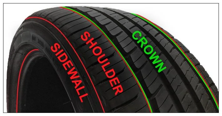

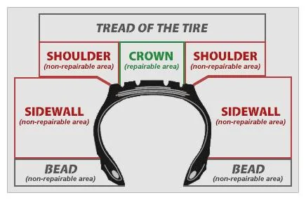

Within an inch of the edge is considered the sidewall.
The Sidewall is the "smooth", vertical area on the side of the tire between the edge of the tread and the bead of the tire, which does not include any area where tread grooves are still visible.
Clearly the pin was in the shoulder.
Ford Maverick $300.00 push pin! TireDiagramSamplePhoto1-710x373 (1)
However,
Ford Maverick $300.00 push pin! TireDiagram-CrownShoulderSidewall-436x285 2
But I would still plug it.
However,
The tread and the sidewall. There's not one person that would say crown or shoulder unless they're discussing uneven wear. Your diagram even explains that. Get a 295/75r22.5 and say that more than an inch in is unpatchable and a shop would laugh at that. It's only the first inch, regardless of tread pattern.
