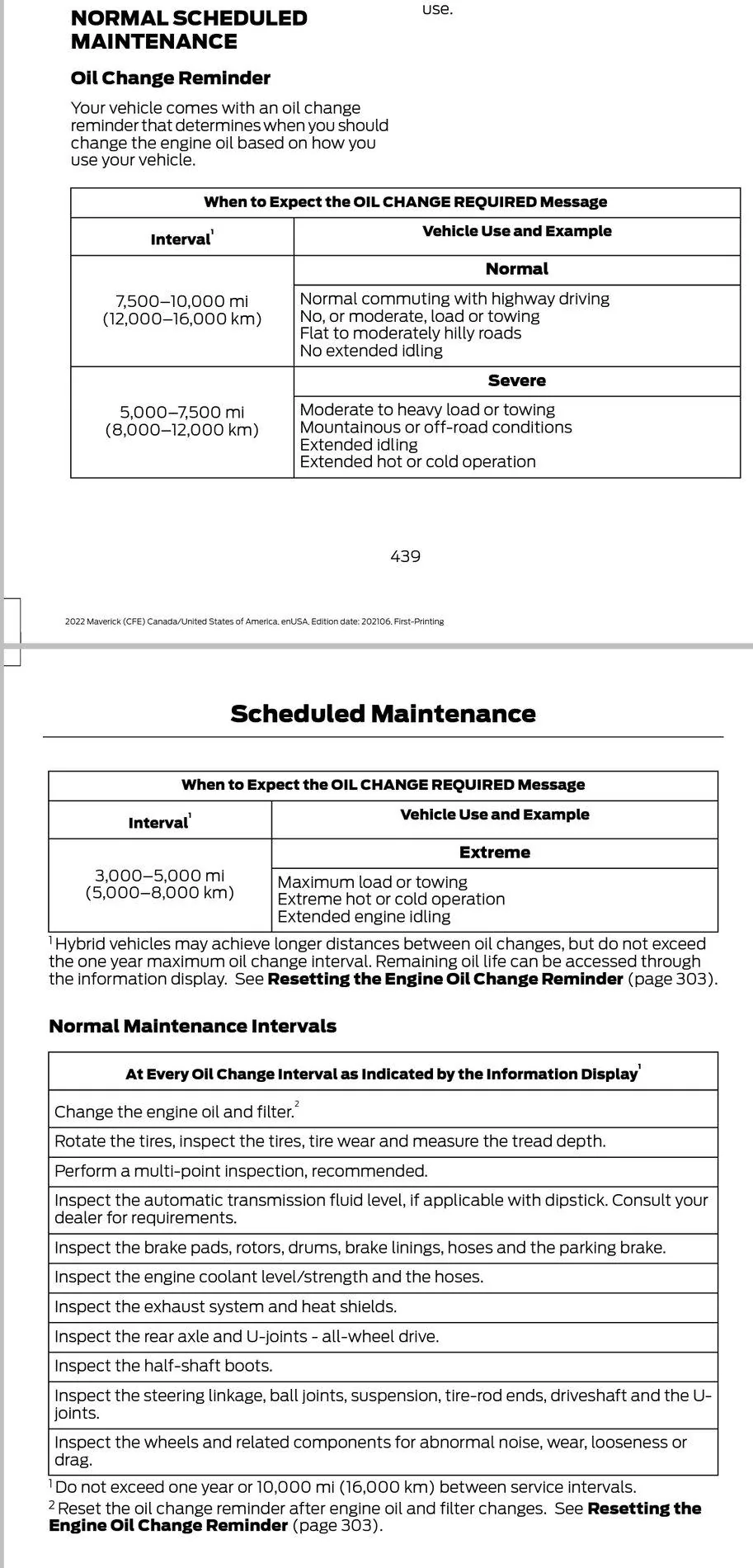

What are are everyone’s plans for breaking in the Maverick? I plan to change the oil right after the first 1k miles and not drive at speeds in excess of 70MPH until that point. I also plan to change the trans fluid after 10k
The manual does not say it needs an oil change after 1k miles but won’t hurt as long as the oil fluid is properly recycled.
per the manual “BREAKING-IN” page 273 “avoid driving at high speeds”. I believe this to be 60MPH but I can’t drive that slow on the interstate, what does everyone think?

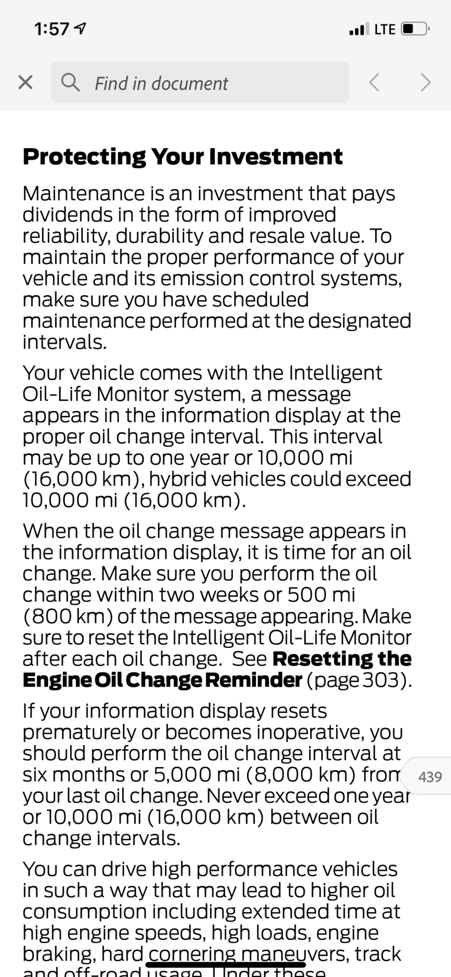

First Oil Change:
When the reminder comes on or in one year if it has not.
Only drive about 5k a year so probably once a year.
the indicator will come on after 1 year regardless of miles. Page 436 of the owners manual.
