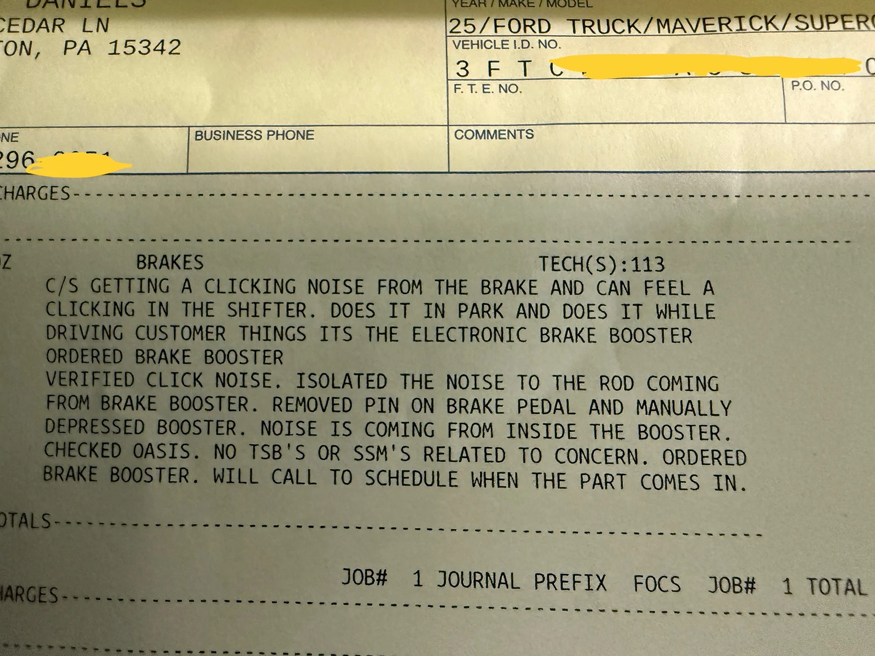

Dealership confirmed my suspicion, it was an EBB failure. They are ordering a new one but giving me back the truck while they wait for it to arrive and schedule the install.
Great easy check given there.
Of course, the pin will probably be a one-time use only item, and the rod made of plastic so the pin hole breaks on removal, and let's see, what else...
