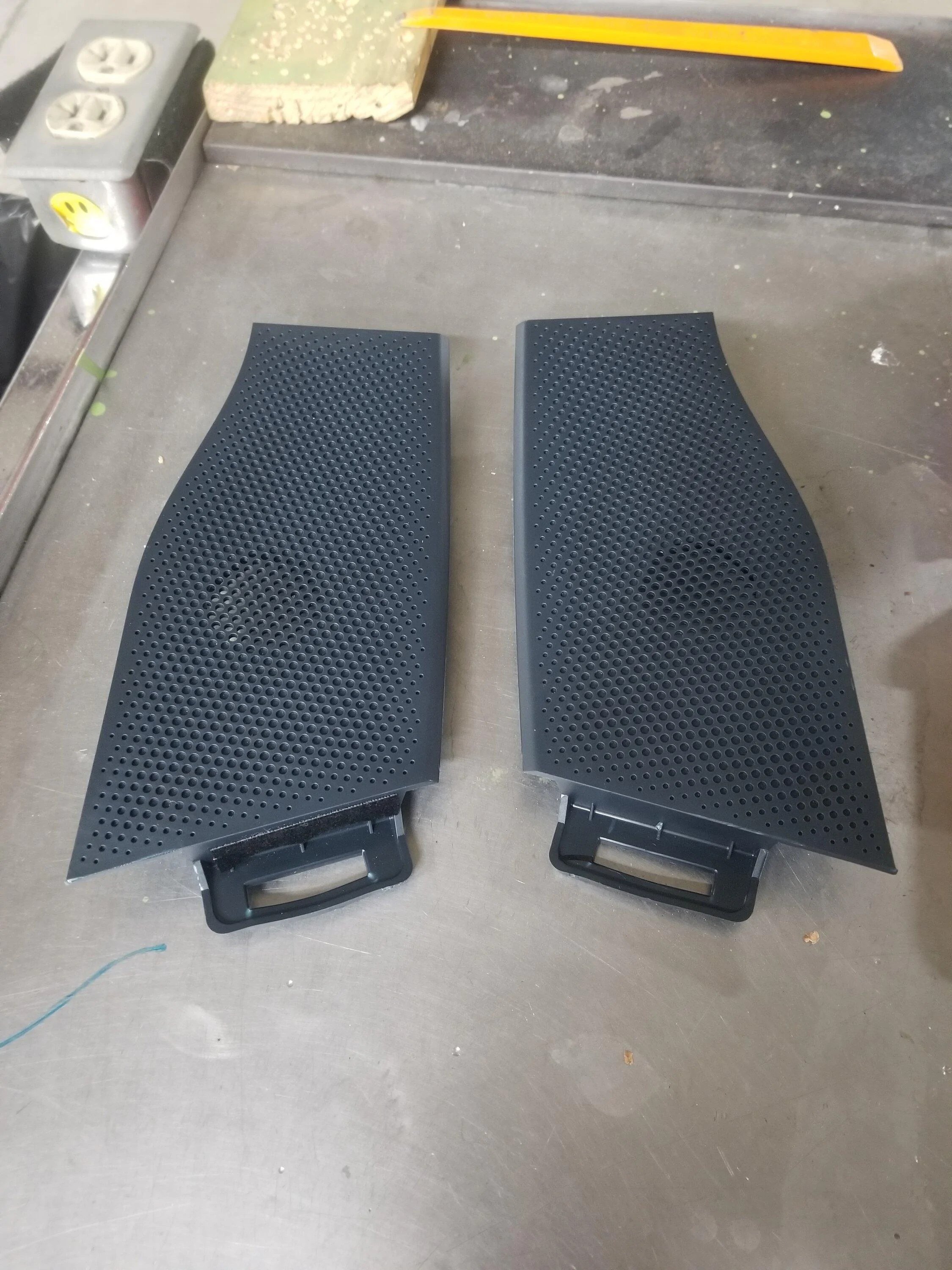

Most of my roads out here in west Texas suck pretty bad. From close to day 1 it also developed a buzzing noise from both A pillars at where the speaker grilles meet the A pillars if I'm driving on these crap roads which are little more than tar with pea gravel stuck in it and are everywhere, it's a constant dull buzzing. If I push at the plastics at this point the buzzing stops. I removed the 2 speaker grilles today after work before I drove home and the buzzing stopped. Yaaay score one for me and my sanity.
Dont get me wrong I love this truck. I just want it to be better. My 94 silverado I bought new was way worse with the snap crackle and pop interior. I went around and made it much better too.

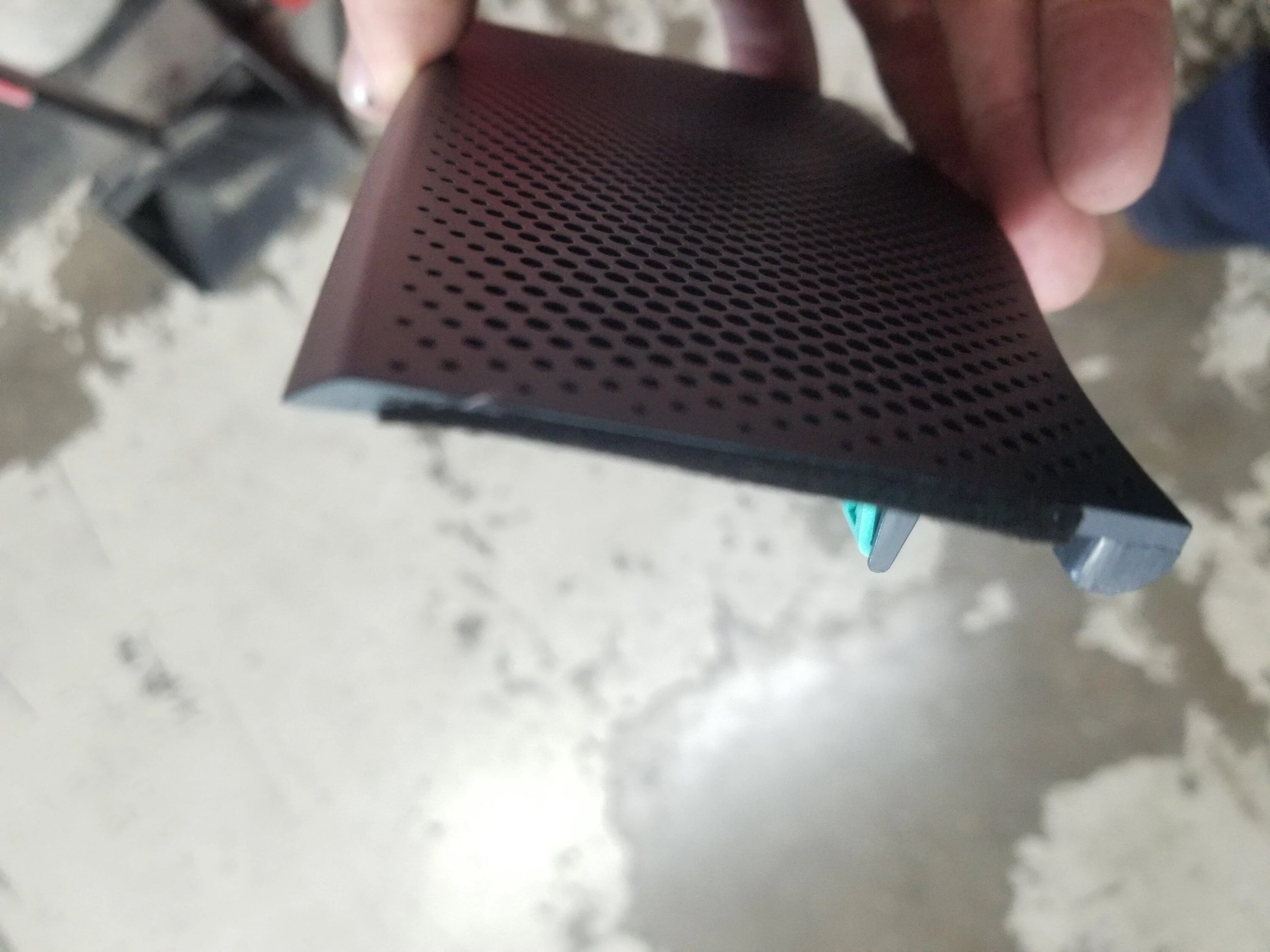

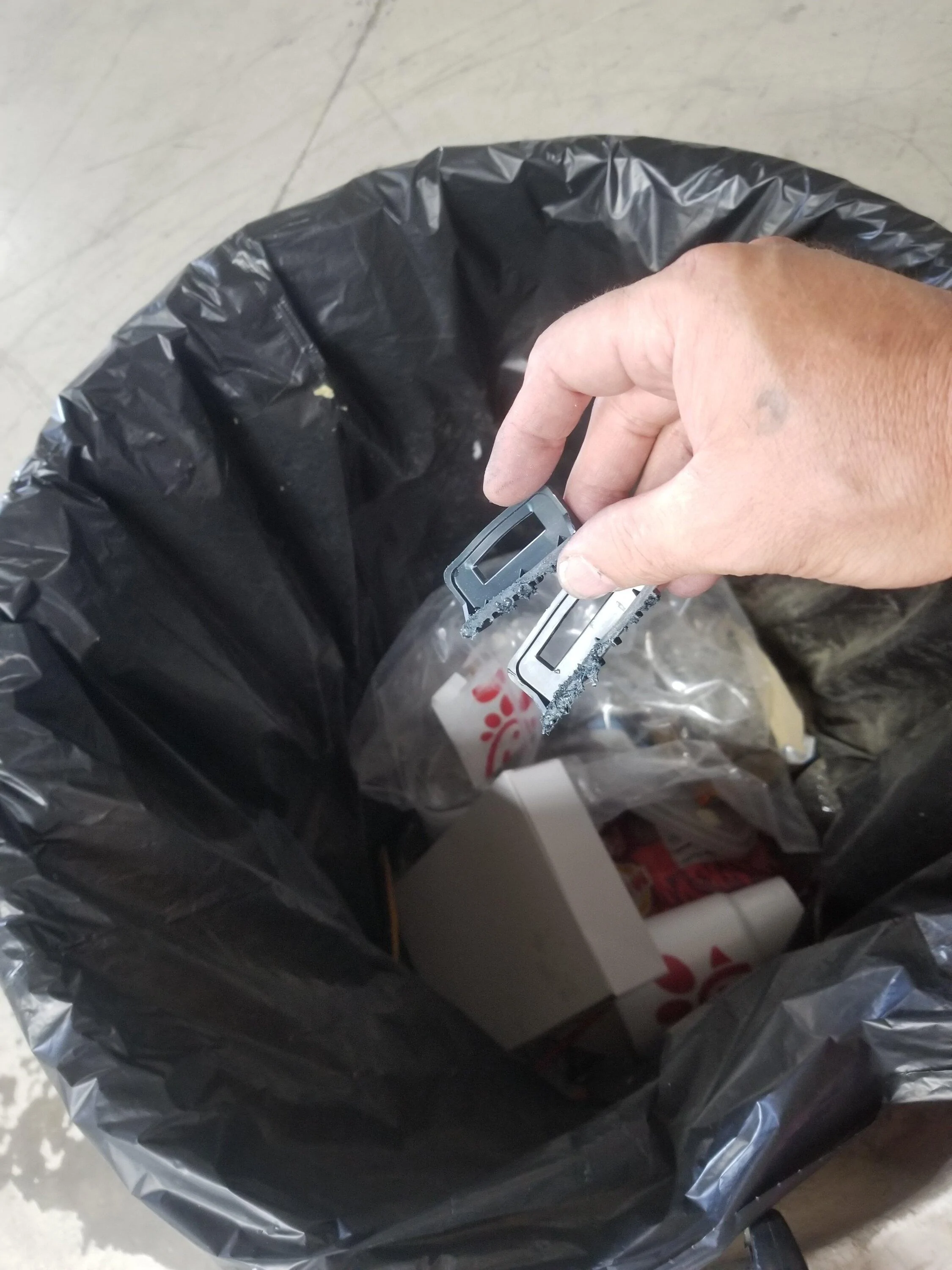

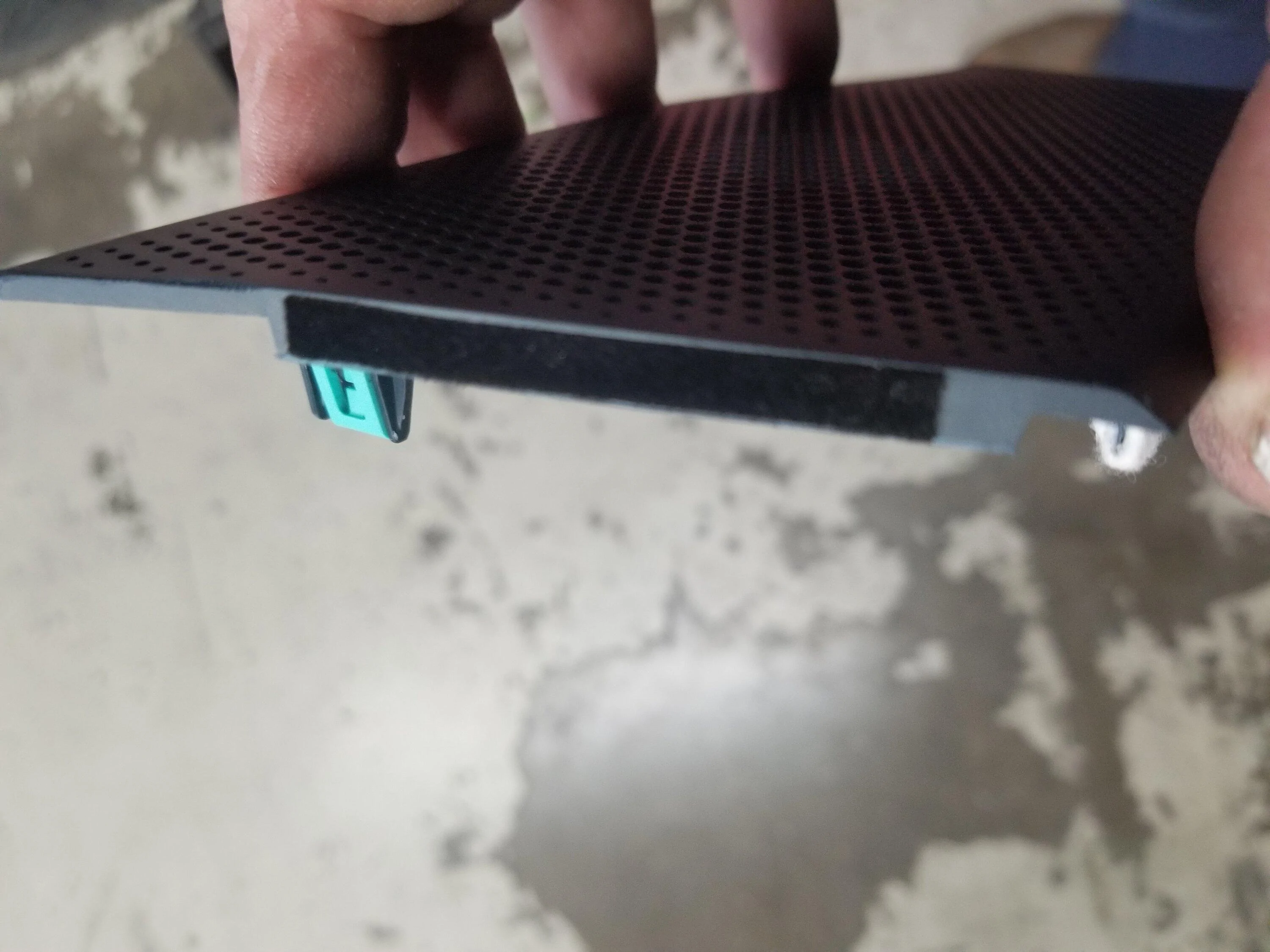

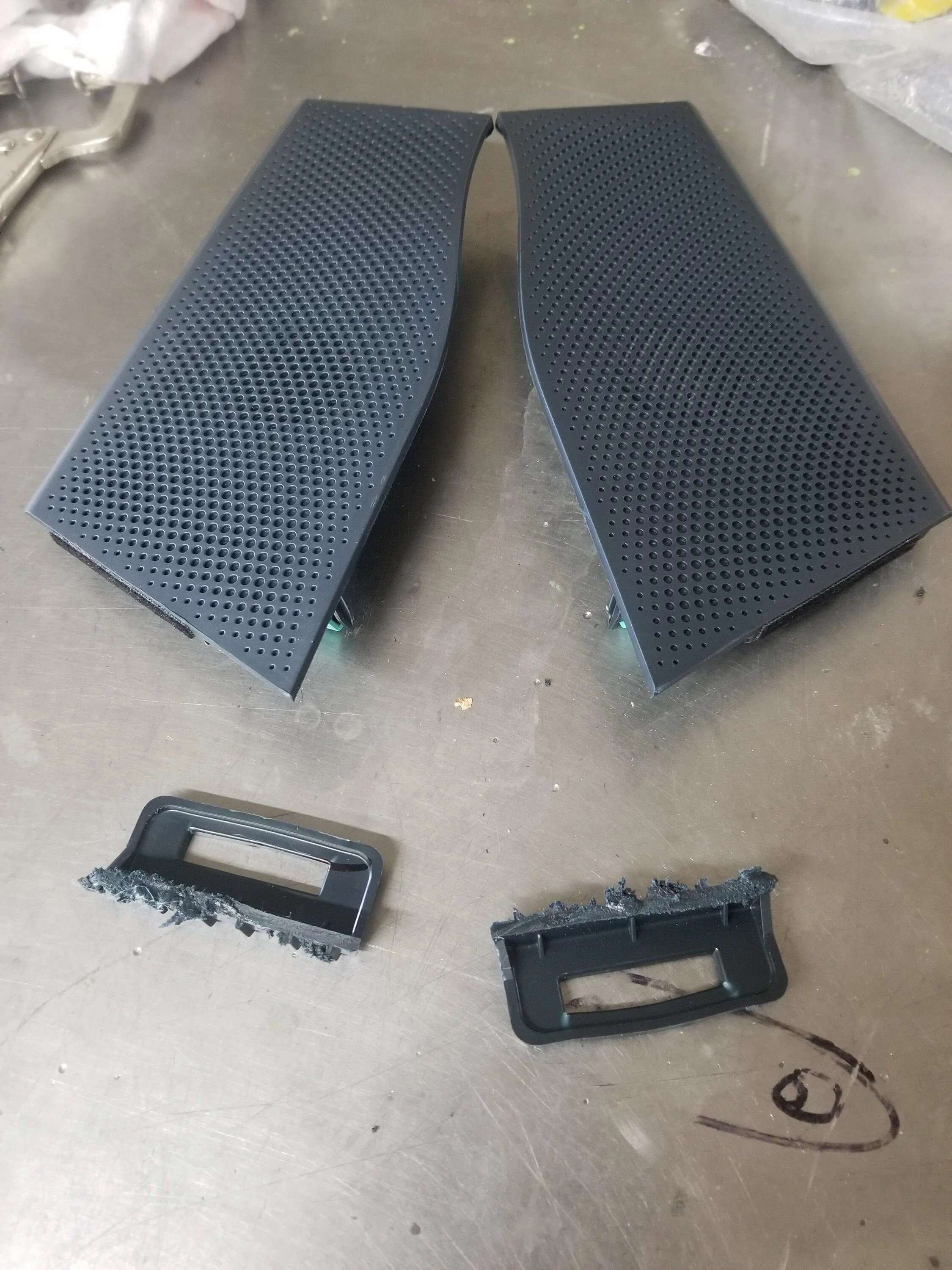

However I am curious as to who thought it was a good idea to have a slot and tab arrangement to tie the A pillar plastics to the speaker grille covers. I may trim a little of the slot back so it doesnt fit so tight, and add some black felt to cushion these pieces. If the covers will fit in place nicely without the A pillar tab, I may just cut the slot completely off the speaker grilles and toss those slot pieces in the trash, then add a thin cushion of felt where they touch the A pillar.
