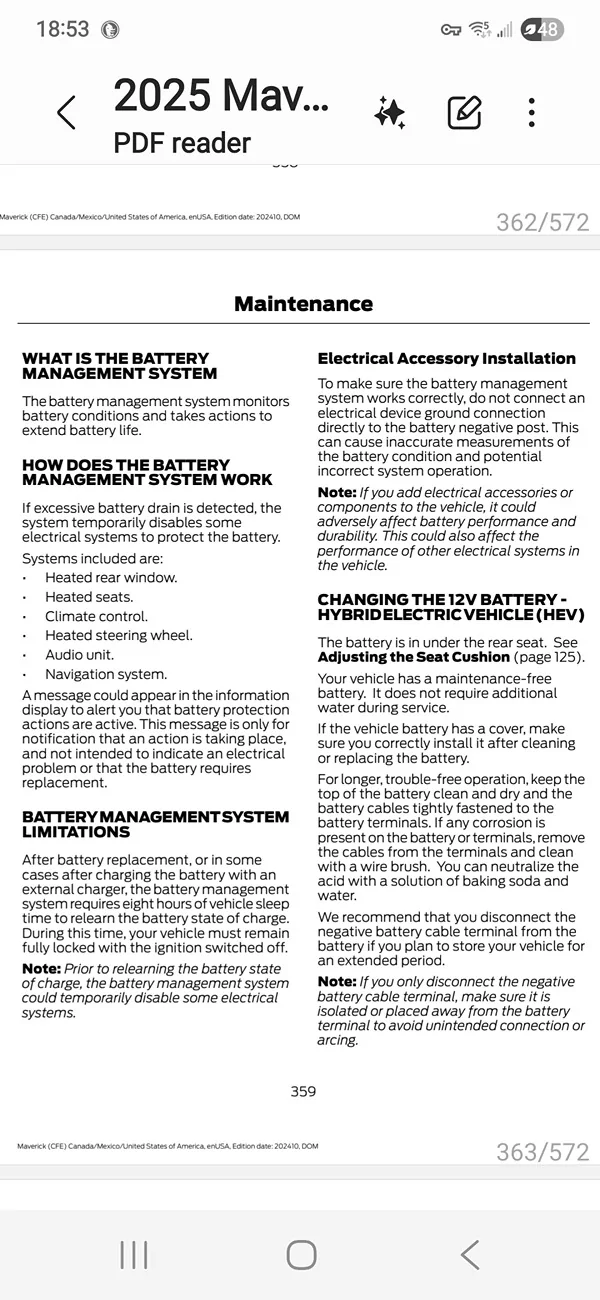

There seems to be a lot going on with your battery and I don't have the answer.
However, from reading many of the battery related threads here over time, and from reading over my truck manual, that we can help our trucks charging by trying to get the Battery Management System (BMS) to relearn what a 100% charged battery is supposed to look like....and hopefully then it charges the battery to the appropriate level.
Pg 359 of your E-Manual let's you know how to reset your BMS. (Page added below).
This is what I just did last night (I do it every once in a while):
-I fully charge the battery with a good charger designed for AGM batteries, at least 4 or 5 amps so it has some power to push and recondition my agm battery.
-I Disconnect the battery charger and clean it up,
-The directions then say to close up and lock your truck for at least 8 hours...yep, over night is a great time for that! I make sure everything is closed, windows, tailgate, engine bonnet and especially all the doors - fully closed and then lock it. I also unplug my dashcam so it doesn't come on and drain power during the process.
I also take our keys well away from the truck so we don't accidentally interrupt it's....relearning.... by walking by with our keys in our pockets or accidentally pressing buttons if in my pocket.
Our truck is always parked in our garage when not in use, I am always in and out of the garage so that is why I collect the keys and put them away, so I don't forget.
Again, this isn't the answer for all the issues with peoples batteries etc, just how to try get our trucks to relearn what a 100% charged battery is supposed to look like, and try to keep it there.

HeyBales
May 3, 2024
5,414
5,159
KC Metro area
Huh - never stood out to me before, but reading those pages since different than the online version - if Ford is using their specific term in there that they don't define elsewhere in manual.
Vehicle sleep time - takes upwards of 75 min for all systems to go to sleep.
So probably not a problem overnight hitting 8 hrs plus 1.25 hours since turn-off/door close/lock.
But I gotta remember to to probably add that in comments now.
Someone could literally think ya - I got 8 hrs, and it not actually be enough.
Great point on keeping keys away, as that would wake up modules on the truck.
ETA - 25MY, that's why.

Good day BillS
I hope you read my previous post about the Mav manual explaining how to get your BMS to relearn what a properly charged battery looks like.
-Have an appropriate charger (at least 4-5 amp), and I have the factory AGM battery.
-Charge your truck battery as per page 359 of the manual... I use the charge point under the hood and the ground provided. Charge it all day (or a couple of days), if possible, to let the smart charger recondition your battery. Manual says not to connect the charger to the negative battery post if I remember correctly...page 359.
-Disconnect your charger and close up the truck completely and unplug any extra electronic devices you may have (in my case it is a dash cam). Doors, tailgate, engine bonnet...everything fully closed!
-Lock your truck, I double lock mine, and put your truck keys far away as you can in the house so you dont accidentally wake the truck up by walking by it with keys in your pocket,
-leave your truck in this state overnight (I believe Heybales said 8 hours plus another 1.5 hrs for everything to shut down), so say 10 hours.
If your BMS is charging inadequately, this may help correct it and doesn't cost anything to try...I like that!
If your battery has been at a low charge state for a long time, it may need load testing, just to see if it is still serviceable...winter is coming...
Have a nice day, and I hope this helps you out,
Andy

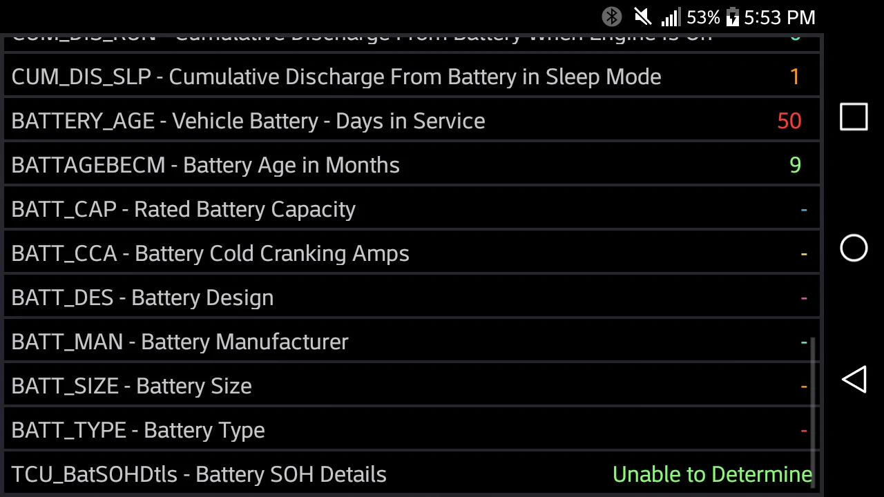

I have a question for the battery experts here. I checked my 25 Maverick with ForScan and the charging level is only set at 80%. So how does the BMS keep your battery at 100% charged after charging your battery to 100%?
85% SOC for the BMS is 100% charged actually. I've seen the posts from the beginning discovering that tidbit. Confirmed on my replacement battery.
That is probably the point it's supposed to go to trickle charge, but that's not what happens anyway on the hybrids. Perhaps it works properly on the EB's.
Look at all the other battery related values that are available PID's also in screen shot below - I'm betting it's not used just as the others aren't on the hybrid.
Just like there are orphan PID's regarding all kinds of things this truck doesn't have - they are probably left over.
Though - the 25 manual does appear to say there are some values that must be changed with a different battery spec on either the hybrid or the EB. Same footnotes made.
It would be interesting which of these PID's has a value now.
