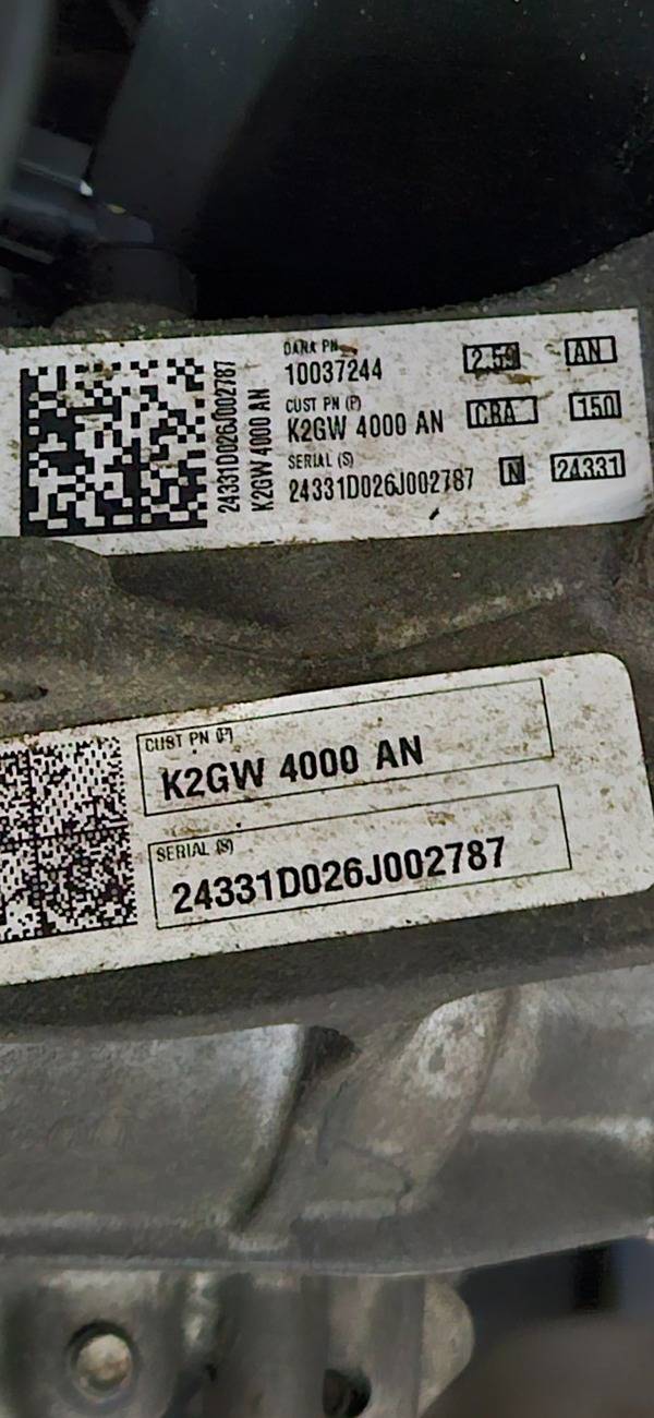

I just read over your thread, grabbed my paperwork to have a look in order to contribute to your data, but my window sticker and purchase info has nothing on it regarding the final drive ratio...and it is awd. I see the drive shaft and everything! ;-)
I di take a pic of the rear end data stickers but can't see any final drive ratio...so I added my Pic in case I am being a bit thick this evening.
Anything I can look at to try and figure this out, let me know as I don't mind helping you out.

Ya know what? Everyone talks about it yet where is it written down? Owner's manual? Maybe. But there could be a typo.
Really the way to know for sure is to MEASURE it. With a scan tool. I illustrated how I did it.
Good point though. Hard to answer this if it's not written down!
It isn't as easy as when I was climbing under my last F150, checking the final drive numbers so I could make sure of the trucks tow capacity for an RPod we picked up once i confirmed.
You don't know for sure, till you can confirm the numbers, to make sure of the surplus capacity. When towing, I like lots of head room.
Online search says it is a 2.91 final drive...but I don't trust that of course.
Maybe when I put it up on my ramps, I can get under it better...where is that dang steel tag with all the info I want!
Will input data if/when I figure this out.
