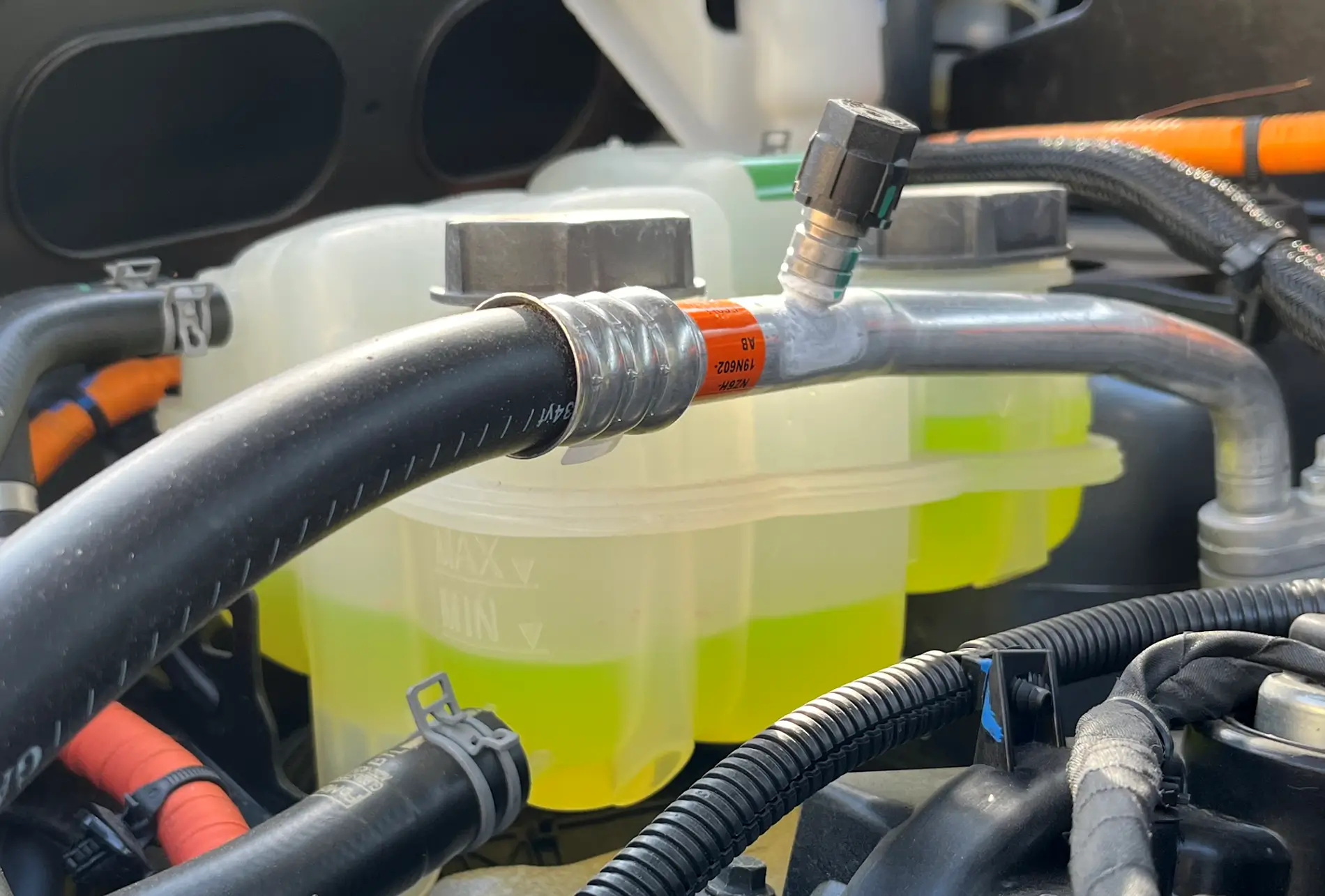

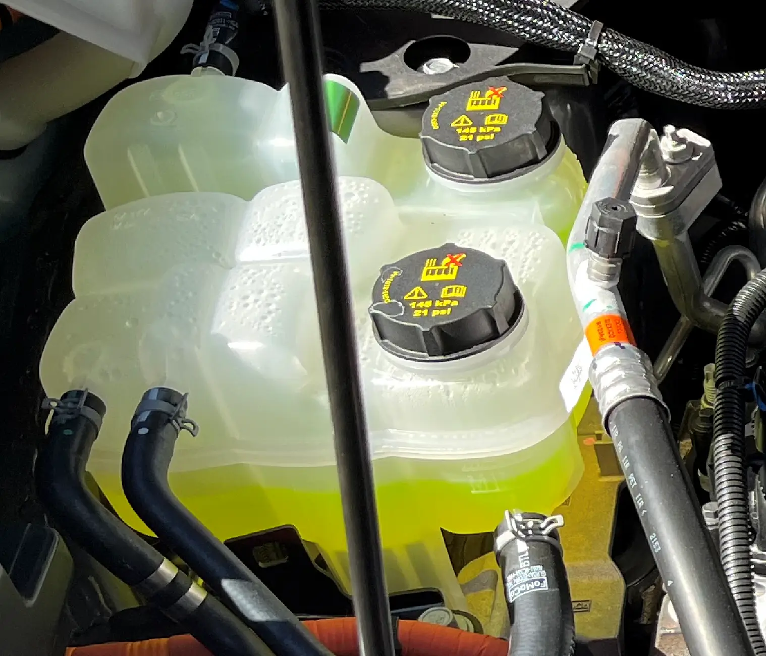

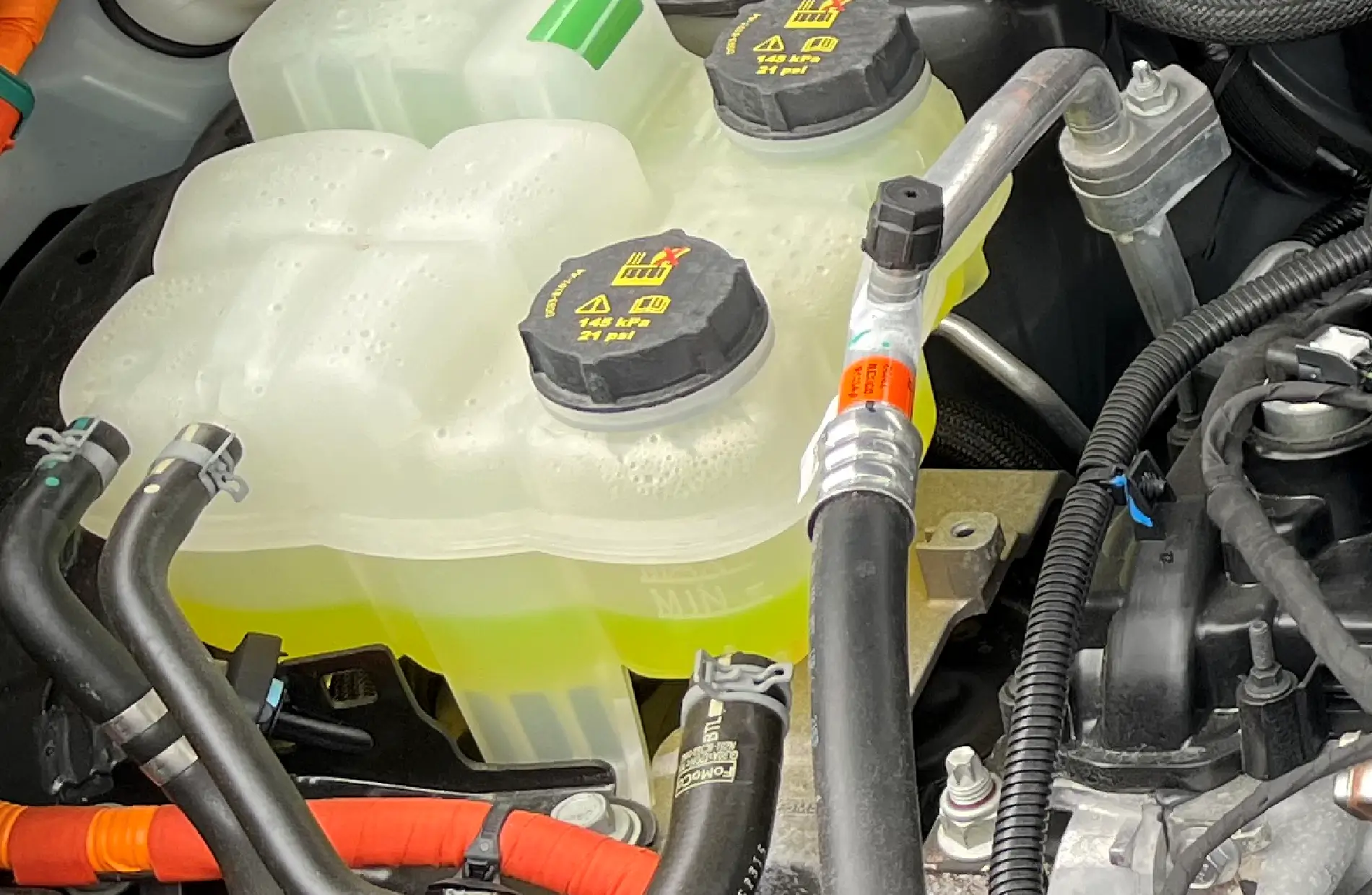

My front tank is down in level a bit since I got it Oct 2023.
The driveway slopes, so photos are not when the truck level.
10-2023
Ford Maverick 2025 Hybrid Coolant Leak 1767645438303-rl
12-2024
Ford Maverick 2025 Hybrid Coolant Leak 1767645935447-o0
01-2026
Ford Maverick 2025 Hybrid Coolant Leak 1767645526072-4t
