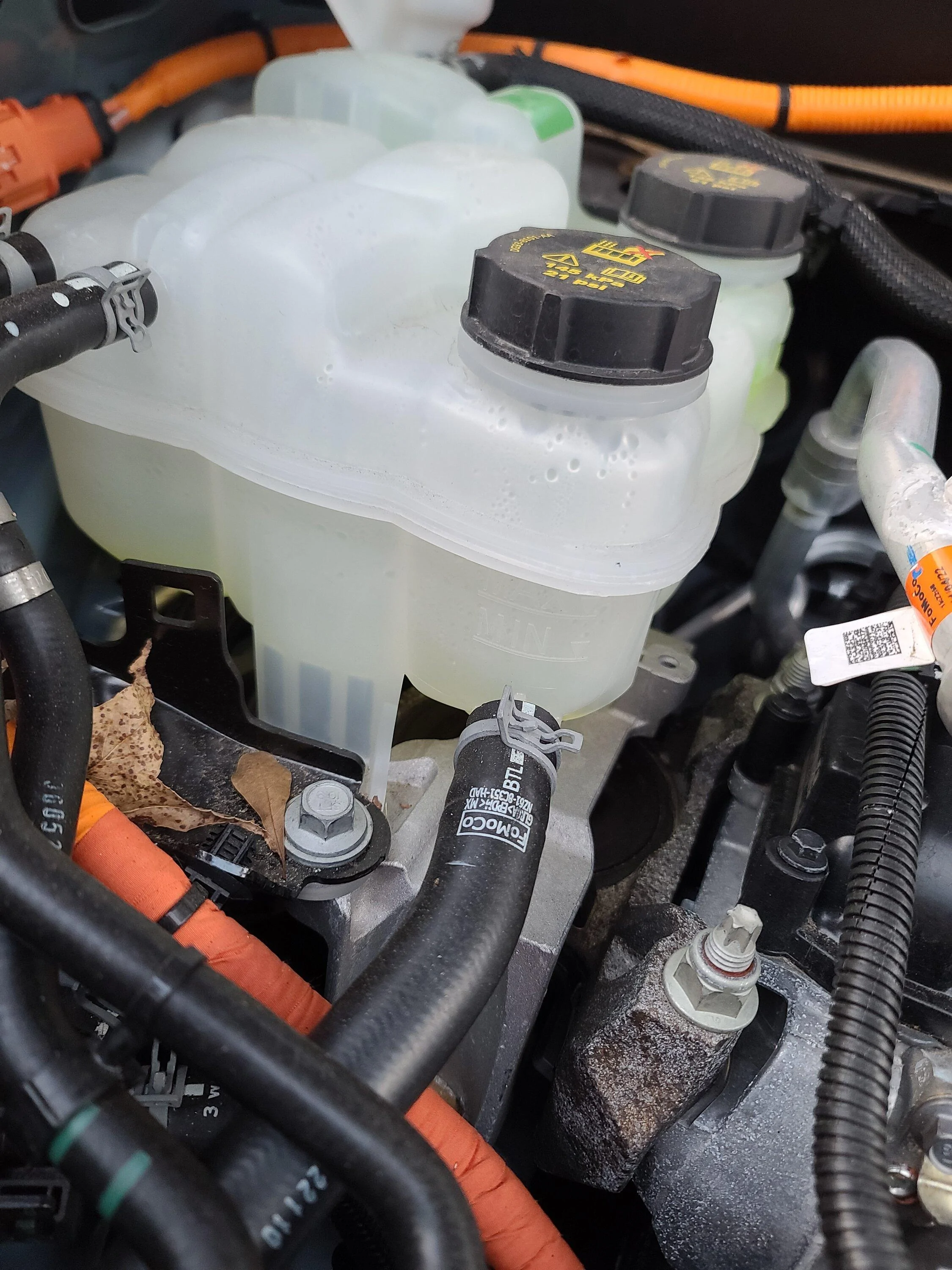

I believe that I have the same issue ... during a wicked cold day at the end of January, the Check Engine light came on on my hybrid. I made an appointment with the dealer right away but didn't get in for 10 days, during which the light went off and on a couple of times. In the appointment five days ago, the dealer stated that I needed a new Heater Assembly (18K463), but that it was on backorder. They told me I could drive the truck as-is until the part arrived.
I haven't noticed any driveway leaks, and my coolant reservoir under the hood is a little less than halfway between the MIN and MAX right now. I'll watch for leaks and coolant level, though, as it's possible that it's leaking and I just haven't noticed it. Super glad I saw your post!

My check engine light never came on. Engine temp display never showed abnormally high, either. But that coolant tank was sure empty. I wonder if yours is not opening/closing as expected, and so throwing the CEL? Or another problem that can be detected by computer.

Thanks. I haven't seen a leak, but it looks like my coolant level in the tank is dropping slowly. I don't know a ton about cars, but I don't want to miss another issue because my CEL is already on for this issue. I'm going to stop by the dealer today to check on the part and ask them to top off the coolant. Appreciate it!

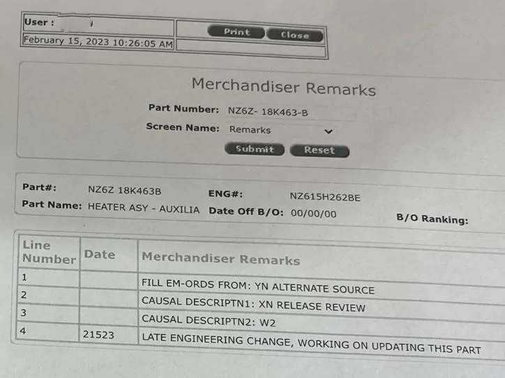

The dealer kindly topped off the fluid and checked on the status of the part for me. Apparently there's a shipping delay now on the Heater Assembly because Ford is working on a "late engineering change, working on updating this part" (see the report they printed below).
Ford Maverick FIXED - Coolant leak near exhaust - Exhaust Pipe Auxillary Heater IMG_8479
It sound like this might now be a known issue or a design flaw that Ford is correcting. I'll update when I have one. Anyone else have this issue?

Sounds like a continual potential problem. We all know how short the service life of the exhaust system is, why link desposible parts to a critical operating system like this. There has to be a better and more reliable option. Heat cycles cause cracking, cracking causes leaks, it is going to happen.
