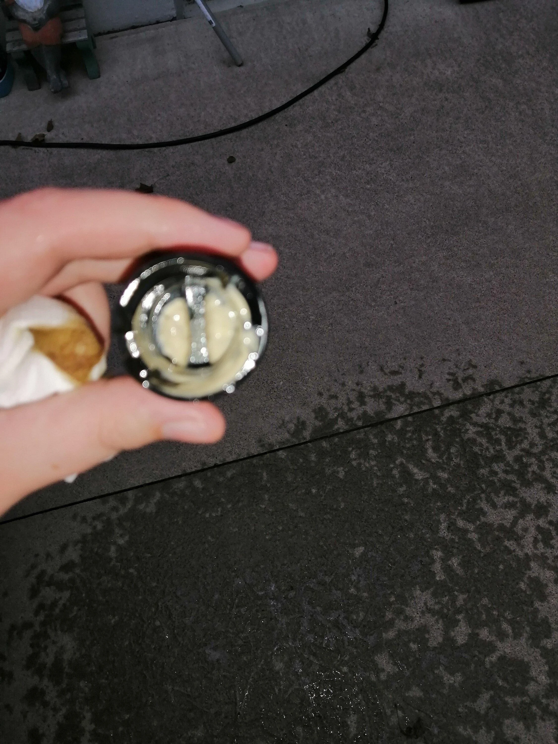

Matrixman2323

Unfortunately I'm having the same problem not with a maverick though a escape hybrid (same power train) this is the photo I took last night after the dealer said it was ok
My maverick is similar but not as much as yours. Dealer told me it was “condensation that forms in the inside of the cap”. I’m sure it’s not and will end up being another issue with this POS.
