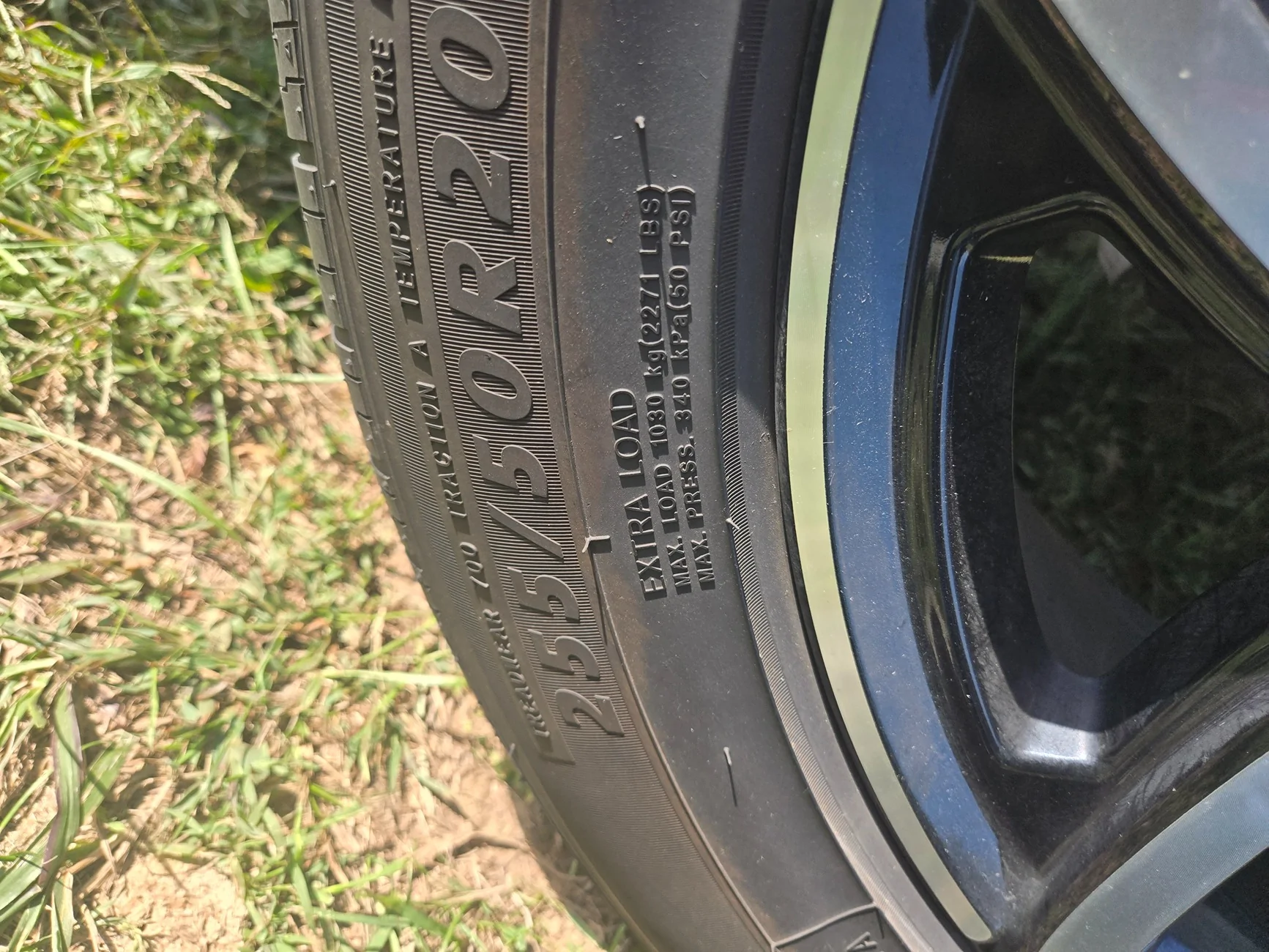

My 2025 Maverick Lariat hybrid AWD mpg:
New truck, OEM tire/wheel 42.6 mpg with tires inflated to 42psi by the FORD plant. After 1,500 miles, I got a best of 46mpg in 45mph construction traffic. I changed to 255/50R20 all season tires and Mach-E wheels and they looked flat at 32psi from the tire shop. I added a roll bar and roll up bed cover. My mileage dropped to 30mpg. I aired up to 38 psi and mpg increased to 35mpg. Aired up to 46psi and mpg hit 38.2mpg today. The tires are rated to 50psi. The tires look much better and the truck handling improved with a slightly bumpier ride. Should I try 50psi and continue to ignore the 36psi cold inflation pressure recommended by the sticker? It seems that the FORD factory is ignoring it as well by shipping trucks at 42psi. I guess the sticker serves nothing but to prevent liability for lawsuits after a rollover.

They come around 45-50 psi from the factory because they are strapped down to a train for several weeks and it helps prevent flat spotting.
The 35 psi Ford recommends will be the best combo of ride comfort, mpg, stopping distance, and wear pattern.
The stamped max tire sidewall pressure is for maximum weight carrying ability. I would bet it's in the 1500 lb range for each tire.
I personally run my three cars around 40-42 psi. All have tires that max out at 51 psi. One vehicle is old (30 years) and recommends 33-35 psi (front-back) for best comfort and 36-39 psi for best economy. They don't do that sort of thing anymore.
Running 10% under max sidewall is probably the best mpg vs comfort zone you'll find - more than that and the ride will deteriorate rapidly.
Radial tires should not wear much appreciably in the center with slightly higher psi. Setting it to 50 and above it might start to wear in the middle without extra weight on the vehicle.
I would bet the mpg increase you are seeing is much more related to driving pattern for that day and outside air temps.

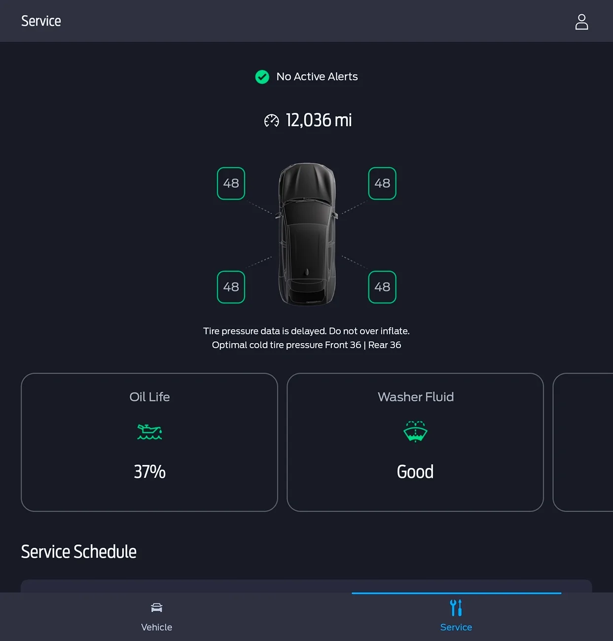

I noted the psi increased with ambient temperature more than I expected. They were at at 46psi @ 58°F and at 85° they are now 48psi. Interesting.

Even more interesting to see that 5 psi increase on the side with sun hitting the tires while sitting.
Or as I observed once - going one direction, but only about 2 psi then with the sun hit side.
The 51 psi is max cold amount (as it sits before being driven). Also know there is a margin of safety there.
Highest I've seen was 45 psi on the highway though and it started to make me nervous and get a little rough.
Typically when you put air in tires, the air going in is quite warm/hot so will come down a little from when you put it in too (assuming using one of those smaller battery compressors).
