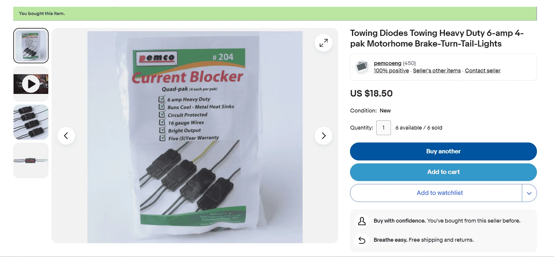

There is nothing odd about the Roadmaster instructions. I essentially wired mine the same, but with an $18.50 set of 4 diodes, and it works fine. The instructions to jump the two taillight wires is odd, and it is much easier to use 4 separate diodes (LT Turn, RT Turn,and each running light separately), But that should not have caused any issue. That is what diodes are for, to isolate the voltages applied to the lights.
I would more suspect a mis-wiring inside the 6pin connector by your installer. I've done 9 of these over the years and never had such an issue occur. Someone should carefully examine that 6 pin. There are many of us already with successful installs on our Mavericks. The Roadmaster kit is just an expensive collection of the needed items, but there isn'tanything wrong with it when properly installed.

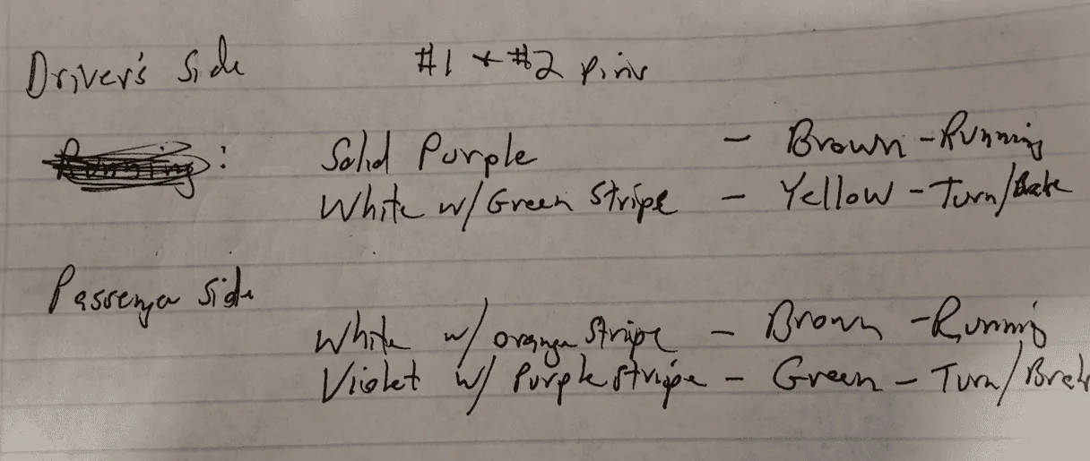

Do you have the pin out and wire color for the tail lights?
As I answered elsewhere, here are the Ford wires I cut and put in the ebay diode set.
Driver's side Solid Purple wire is the taillight (Use one of the Brown wire diodes)
Driver's side White with Green Stripe is the Left Turn/Brake light combo (Use the diode with a Yellow wire)
Passenger side White with Orange Stripe wire is the taillight (Use the 2nd Brown wire diode)
Passenger side Violet with Purple stripe is the Right Turn/Brake light combo (Use the Green wire diode).
Ford Maverick 2024 Maverick Lariat Hybrid - Essentially bricked 1707179235742
EDIT: This is correct. I somehow fat-fingered it incorrectly at first.
