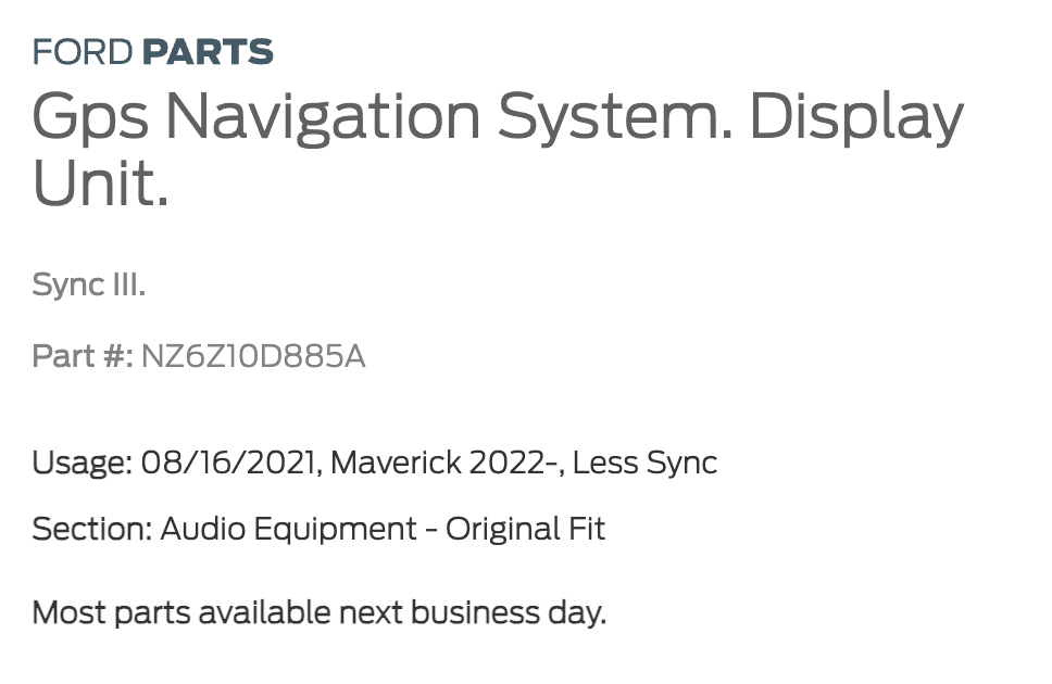

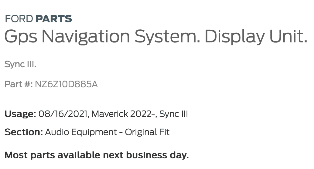

Display unit appears to be the same part number (NZ6Z10D885A), note it's listed as both "Less Sync" and "Sync III" (and under the misleading category of "GPS Navigation System"). That said, the hardware driving it, and which controls brightness, influences image quality is different. There's more to image quality than just the LCD panel itself.
It's not just software; the black (silver) box behind the dash is different (and it's actually 2 boxes for Sync 3 - APIM and ACM). Thus we have threads with instructions to swap the hardware like: https://www.mavericktruckclub.com/forum/threads/how-to-sync-3-4-swap-for-non-sync-3-xl-xlt.11860/
