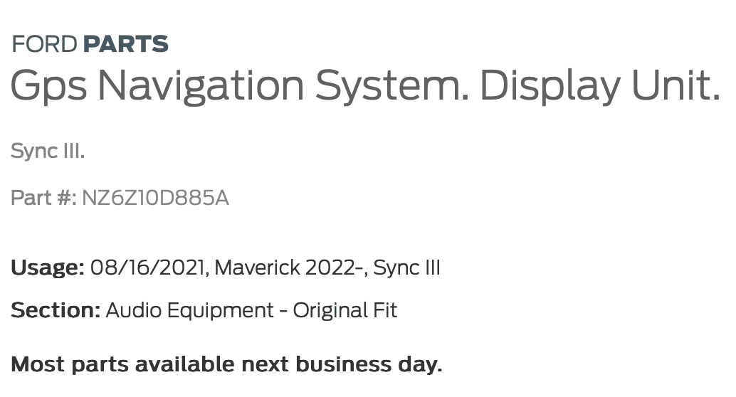

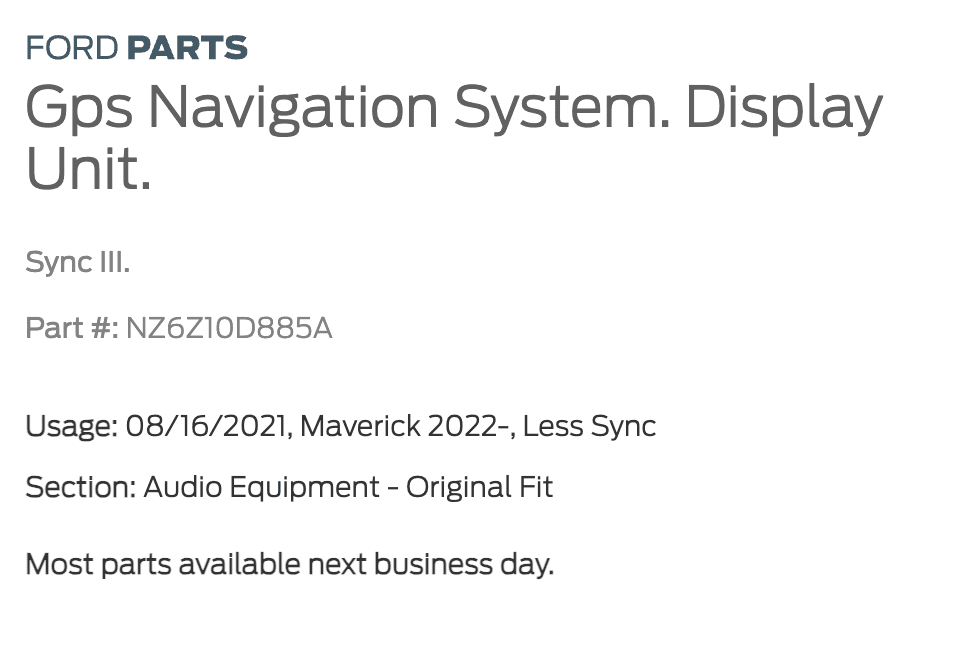

Display unit appears to be the same part number (NZ6Z10D885A), note it's listed as both "Less Sync" and "Sync III" (and under the misleading category of "GPS Navigation System"). That said, the hardware driving it, and which controls brightness, influences image quality is different. There's more to image quality than just the LCD panel itself.

Correction, these two screenshots show the same PN for both Sync III and Less Sync, not sure why it posted the wrong ones before. ;)
Where do you see reference to a resistive display on the base system? If that were the case, we'd see widespread complaints not just about brightness and image quality, but also about the touch sensitivity of the screen.
