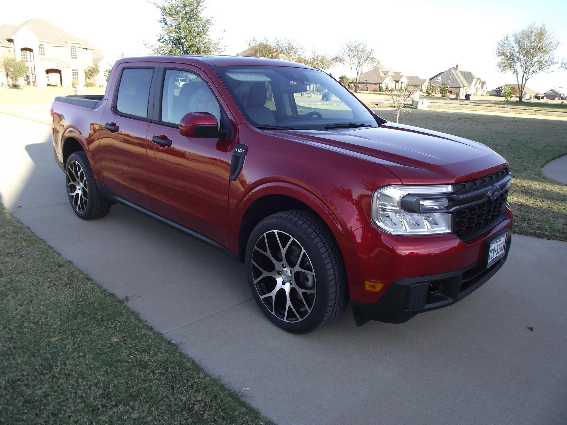

the 20X8.5”Ravetti wheels are 38mm offset 38mm which is the same as the stock Unique wheels, so there was no clearance issue with the 245/45R20 tires. Front strut clearance is practically identical to stock. This puts the tire approximately 1.5” negative which is what I wanted to achieve.
The actual hub diameter of the Maverick measured 63.25mm. Although most wheels will use conical seat lug nuts I recommend using hub centric rings for a little better fit for any aftermarket wheels.

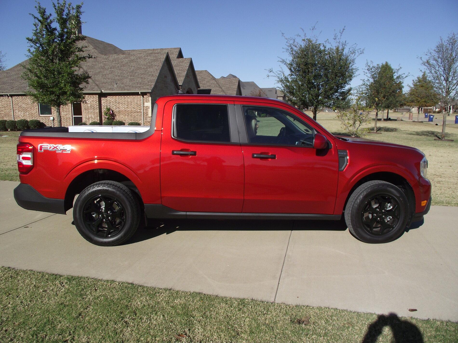

I have kept my Hot Pepper Red Maverick XLT in quarantine for close to 2 Months but couldn't resist temptation any longer. I pulled the trigger on a set of 20X8.5" Ravetti M8 Wheels and Continental DWS 006 Plus tires in 245/45/R-20.
I had hoped some manufacturer would have a 2" or so lowering kit or springs available before I did the tires and wheels. Not yet. It looks okay for now, but I will drop it as soon as the kit becomes available.
If you are shopping for replacement wheels for your Maverick I will tell you that you will know far more than any of the people I talked to about fitment. I have a slight advantage because I was in the tire and wheel business for 35 years. Anyway, do your homework before buying; especially if you buy on-line. It will save you a bunch of grief.
One thing I forgot to photograph and attach is the polished stainless steel tailgate letter insertsI got at Platinum Ford in Terrell. They really catch your eye and keep people from asking "what is that truck".
Before and AFTER pictures attached.
Man, that looks incredible!!!!

That's about the look I am going for. I don't really care for machined faced wheels, but those look great. I am looking at getting some 20's also and was looking at the same size tire. They are still pretty close to stock height. I am going to go more of an all Black look, so Black painted wheels. I have the same color but in a Hybrid. I also want to lower it a couple inches. Will definitely be on the lookout for a lowering kit.

I like it and agree with lowering it a couple inches. The tailgate lettering looks really nice too. I would probably remove the FX4 decal though.

Looks amazing, best one so far.

Looks great!! Maverick is just asking to be lowered! I hope that once you find a kit to lower it that you post on here. So far all the renderings I've seen of Mavericks lowered look awesome!

Beautiful mods!
Would you say your photos are accurate representation of the pepper red paint? I really hope so because I ordered pepper red too and yours looks so attractive.
