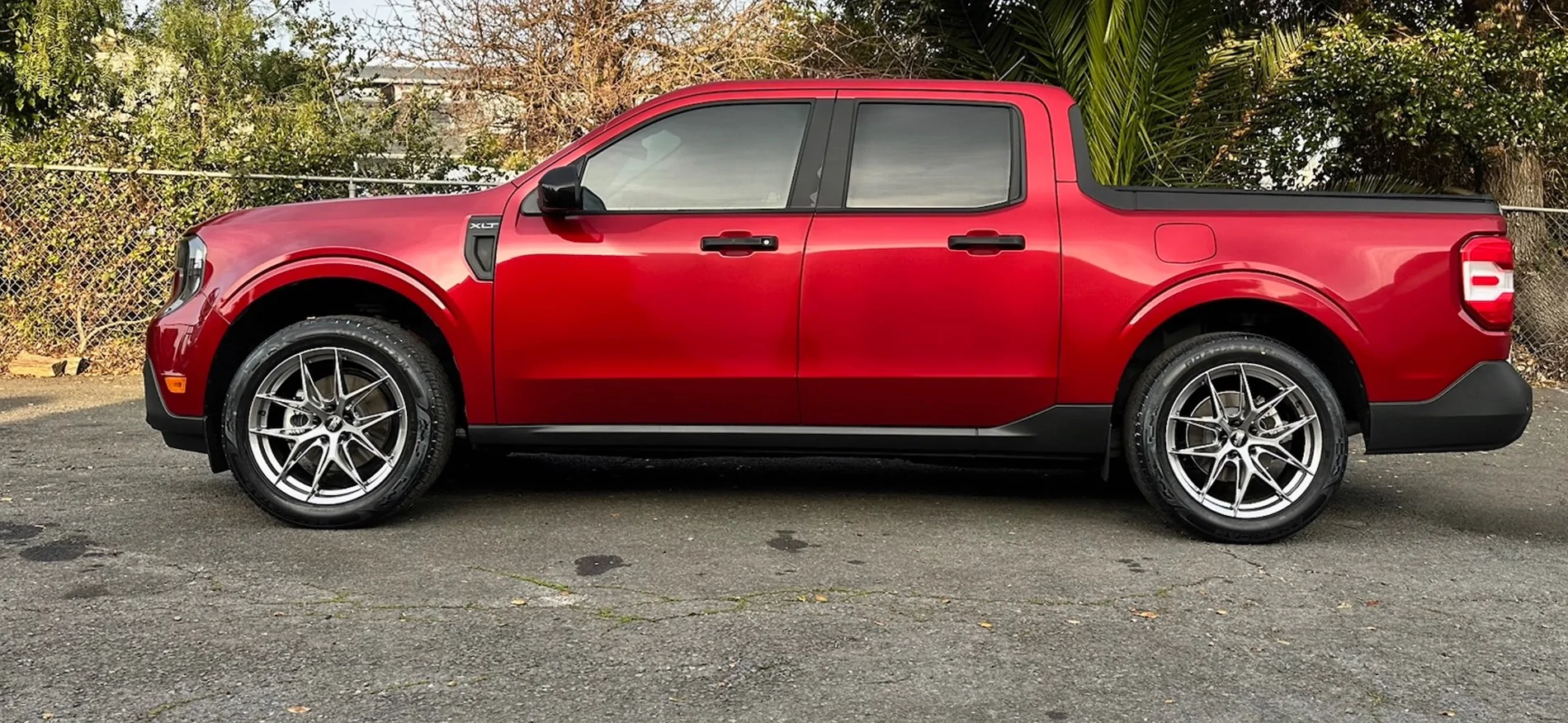

New wheels/tires 19x8.5 and 245/50/19 installed

Looking good!
What tire did you go with? Did it change the comfort of the ride?

Looking good!

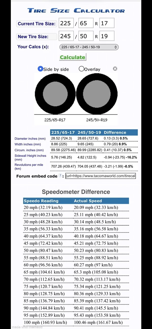

No change in ride comfort. 19” tire size really close to my stock size diameter. Just feels a little more planted with the wider stance. Tires are American RoadStars..

That's it! Im going with that tire size for my new set. I have the 19" Lariat wheels and I was thinking about getting some beefier tires. Thanks for sharing, it looks great!
Ditto, looks great and Cherokee, your timing is perfect as I had just asked if anyone with 19s had gone with a wider tire size than the 225/65-19s that are stock. I have Lariat wheels coming from another member and wanted to go wider but the next question for JCS and I, is that tire size too wide for a 7.5 inch wheel as yours are 8.5 and just right for that.
Just looked up that tire size and here is the recommended wheel size: So JCS and I are good to go.
RIM WIDTH RANGE 7.0" - 8.5"
