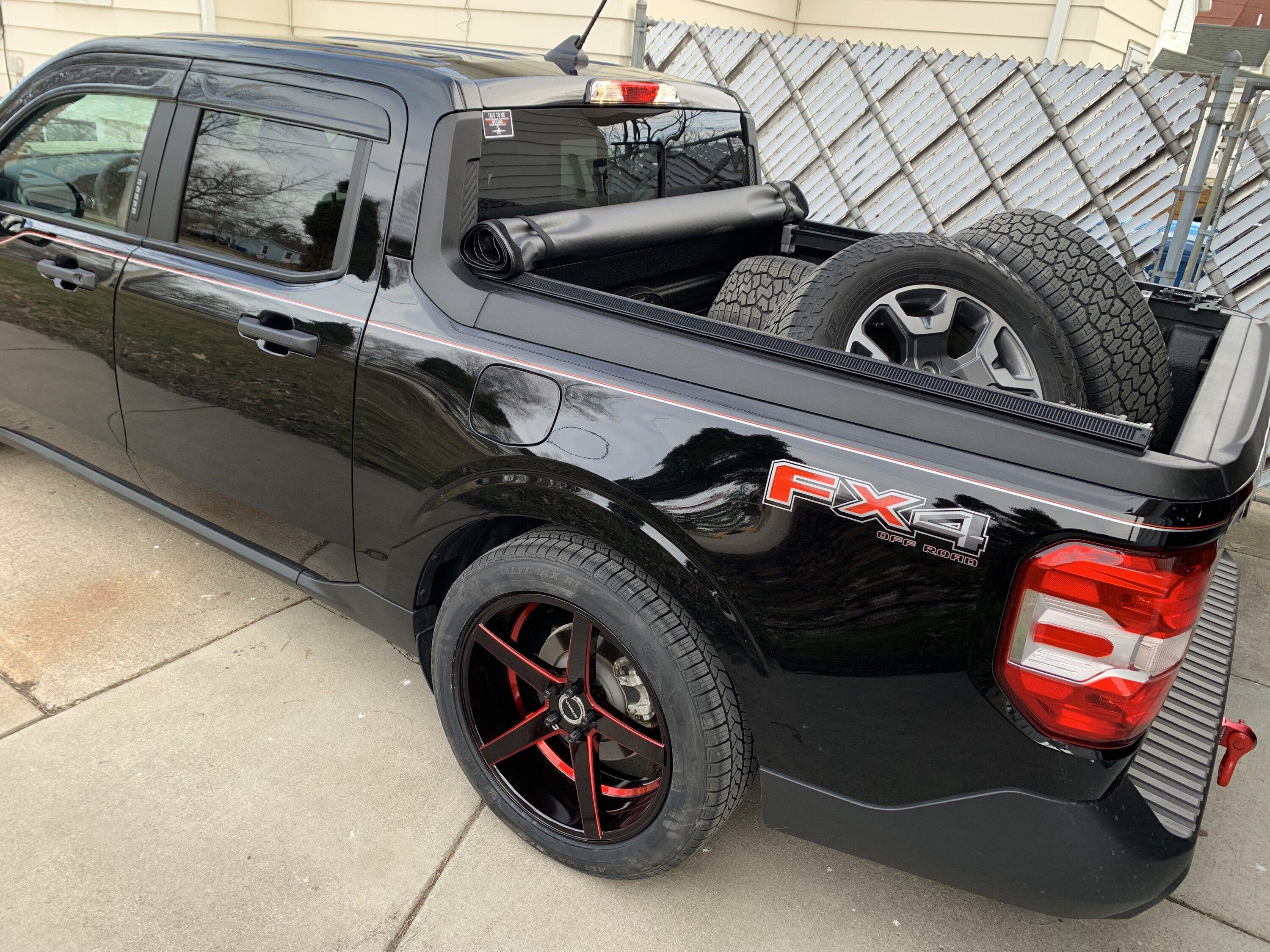

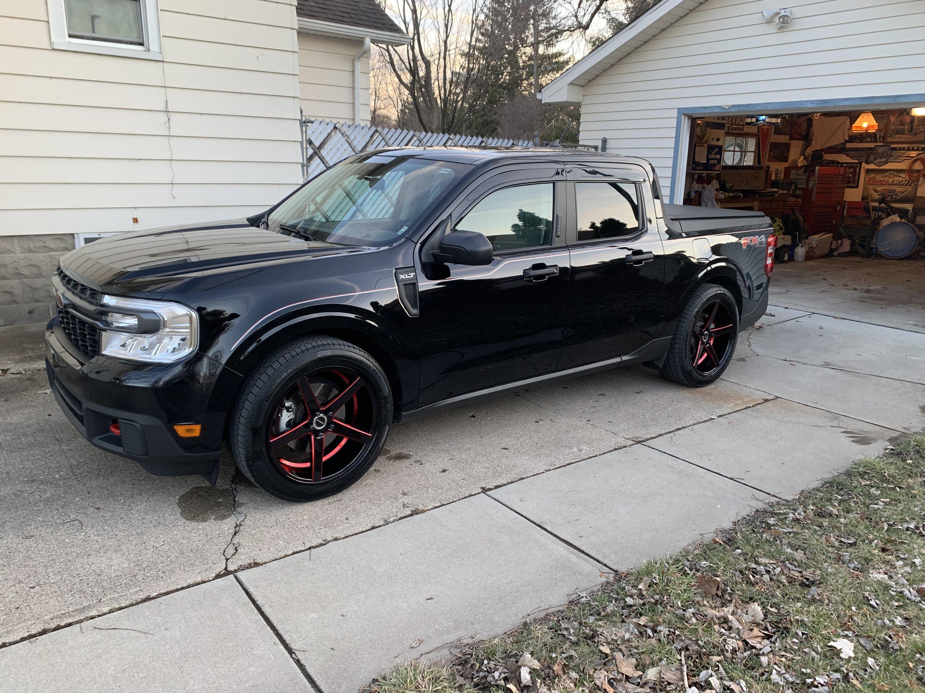

245/50/20 w/8.5” wide rims on mine, I just went to discount tire website and it show + size options 😉
