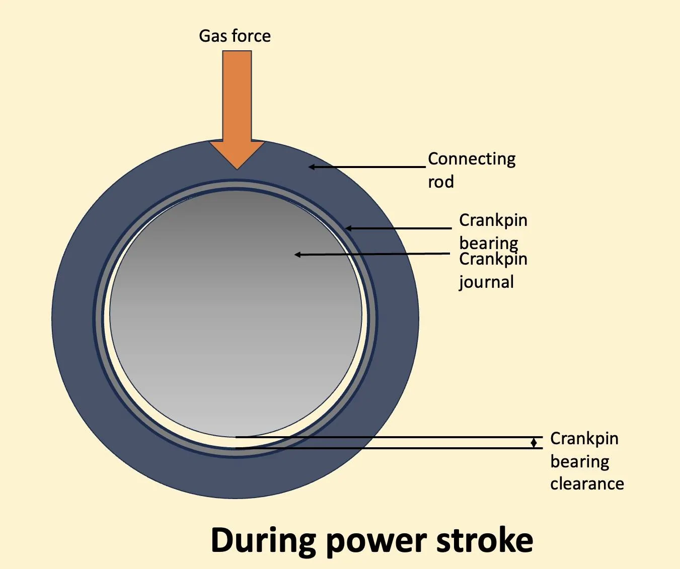

The bearing clearance is a function of journal diameter, typically 0.001 inches of clearance per inch of journal diameter.
Ford Maverick 2.5L Hybrid - Change to 5W-30 oil IMG_2124
As materials science has improved, bearing journals have become smaller. A smaller crank pin or connecting rod, due to using a more advanced material, will lead to less mass, less vibration, less parasitic drag and lower manufacturing costs.
Bearing journals have also become smaller as engine displacements have gotten smaller.
Miniaturized engines = smaller bearings = tighter clearances.
But that is only 1 aspect that has lead to the use of low viscosity oil in modern engines.
The other is the diameter of the oil passages in the engine block and the diameter of the oil spray holes at the bearings. In fluid dynamics, a higher viscosity fluid means greater resistance to flow, while a larger diameter tube reduces resistance.
Modern 4 cylinders have oil passages that are half the diameter of the V8’s of yesteryear. To achieve the same flow rate through a smaller tube, you have to either increase the pressure, or decrease the viscosity.
Falsie With FACTS
Just checked 2 thousandths main bearing clearance on ford maverick 2.0 turbo engine. Main bearing clearance on last Big Block chevy I did was also 2 thousands . Sounds really good BUT just isnt true.
I have to ask how many engines have you done??
