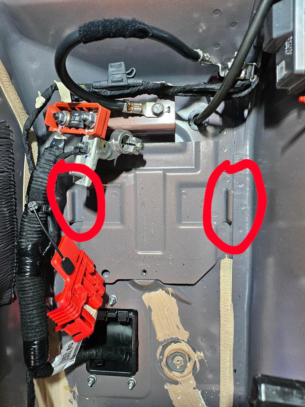

Hi Darnon. You mentioning cuttng/flattening tabs. Are those tabs under the battery?
What did you do to the tabs? Hammer them down, use saw blade?

The tabs are fore/aft of the battery to help position it. I used a pneumatic cutoff wheel, but some have simply bent them flat. An oscillating multi-tool might also work or a Dremel if you're really patient.
Darnon thanks for sharing the pics. So did the H5 Weise battery you bought fit good after you removed the tabs Height Width Length?

@scotty
My original picture was taken with the battery enclosure/cargo bin under the seat removed (and I put it back in after replacing the battery). I recall it actually only took a few minutes to remove it.
Open the rear doors, put up the rear bench seat, empty the storage bins on both sides of the battery, and remove the lid above the battery.
Next you can pull up on the threshold trim that covers the bottom of the rear door opening (just pull it up). After this is out you'll see the edge of that cargo bin/battery enclosure is free to be lifted.
Now you can pull up on cargo bin itself, It is also simply clicked in in multiple places using clips and you mostly pull it straight up. Start in one corner, and then work your way around. It'll be completely loose and you simply lift it out of the truck. If I recall correctly, there were no bolts to undo, but don't quote me on that, as it has been six months or so.
What you'll end up with then is the view as in my original picture with lots of access around the battery, making it easy to replace it. Reassemble in the reverse order.
To me it seems much easier to pull this cargo bin/battery enclosure out versus not doing so and trying to get to the battery hold down clamps using long extensions, etc.
Good luck!
I've tried everything to get that tray out and cannot get it.
Did you removed the H4 battery before trying to lift the tray out and then if so will it pop back in after the H5 is installed?

@deputylynch
I had no problem pulling it out. I remember simply pulling it up vertically out of the clips that hold it in place. You may have to yank it a bit as these clips can be tight.
Good luck!
