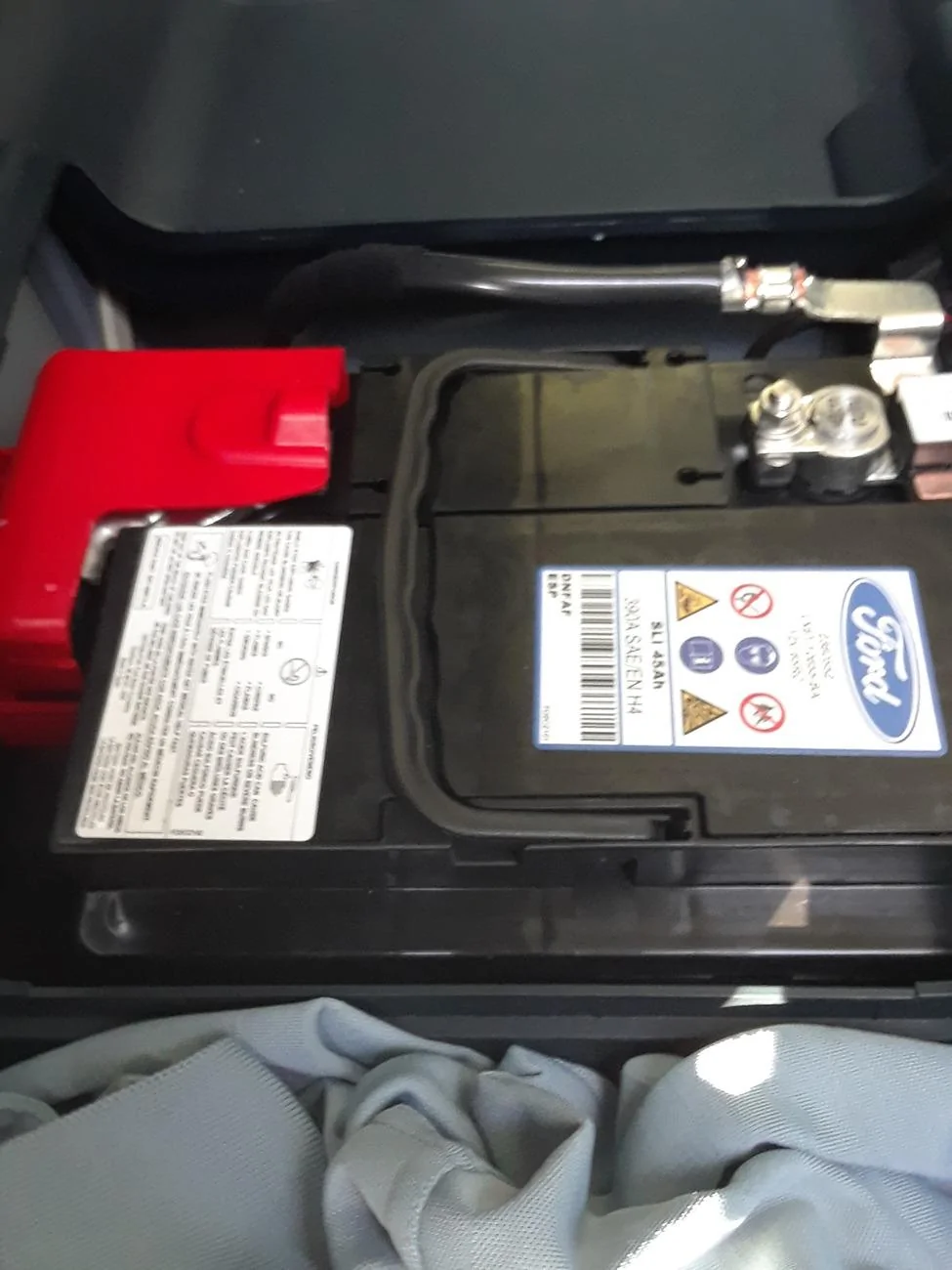

@scotty
My original picture was taken with the battery enclosure/cargo bin under the seat removed (and I put it back in after replacing the battery). I recall it actually only took a few minutes to remove it.
Open the rear doors, put up the rear bench seat, empty the storage bins on both sides of the battery, and remove the lid above the battery.
Next you can pull up on the threshold trim that covers the bottom of the rear door opening (just pull it up). After this is out you'll see the edge of that cargo bin/battery enclosure is free to be lifted.
Now you can pull up on cargo bin itself, It is also simply clicked in in multiple places using clips and you mostly pull it straight up. Start in one corner, and then work your way around. It'll be completely loose and you simply lift it out of the truck. If I recall correctly, there were no bolts to undo, but don't quote me on that, as it has been six months or so.
What you'll end up with then is the view as in my original picture with lots of access around the battery, making it easy to replace it. Reassemble in the reverse order.
To me it seems much easier to pull this cargo bin/battery enclosure out versus not doing so and trying to get to the battery hold down clamps using long extensions, etc.

@scotty
You can indeed swap the battery with another H4/Group 140R without removing the plastic around it as it fits through the top opening, and doing it that way was my initial plan.
But after fiddling for a while with long extensions and a flashlight (and a few bad words!) I instead opted to remove the plastic panels which was really super easy. Truly: you'll have no problem doing this, and it causes far less frustration. You'll only pull the threshold trim panel and then the cargo bin under the seat, that's all.

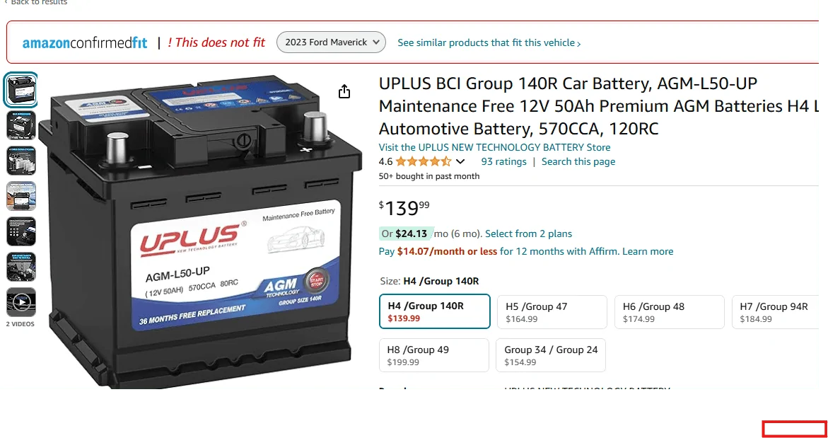

So I believe i found the battery you have on amazon. see attachment.
It is a 140R agm. But amazon says it doesn't fit my ford maverick, see attachment.
Is this the same battery you bought?
Ford Maverick 15.2v charging seems a bit high while driving uplus battery
because I can't really see lettering on your battery to compare.
@scotty
Yes, that is exactly the battery I got.
H4/Group 140R is the correct AGM battery for the Hybrid.
Don't worry whether they say it fits the Maverick Hybrid: it drops right in! Note that their 120RC figure on the listing is also incorrect: the product picture (label) actually shows the correct 80RC.

Ok, what you wrote encourages me because that battery is a lot less then Advance auto, die hard is$220. What does 80RC mean?
Owners manual says use bxt99rt-4A battery.
You have brought info. to a lot of us on the forum now and future readers. You need a trophy.
So stay with h4/group 140. Don't get a 99r t4 battery because it maybe different size and clamp may not attach to battery? Ensure it says agm battery on label.
Hopefully if and when I need the battery they will honor the 36 mths or close to it.
The stock battery in the Hybrid is a flooded cell battery, NOT an AGM, even though the settings in the vehicle are supposedly for an AGM battery. Note that comparable Toyota planetary gear hybrids all come standard with AGM batteries.
Word is that Ford has been unable to source enough AGM batteries, so they ended up putting flooded batteries in the Maverick Hybrids. Or it was simply a matter of cost as I understand they're still putting flooded batteries in these trucks.
Lots of Hybrid owners have reported deep sleep trouble caused by under voltage, which supposedly goes away after replacing the stock battery with an AGM. This to me indicates that this vehicle should have had an AGM battery in the first place.
After getting some deep sleep messages I played a bit with ForScan and changed the settings for the BMS (battery management system) from 80% state of charge to 95% state of charge (SOC). The system voltages never changed. It didn't seem to make a difference: I still got the occasional deep sleep.
Similar to the OP, a few weeks ago I put a voltage meter display in that same 12V plug and I noticed the same: system voltages between 14.8 (rare) and 15.1 (most of the time). I've seen 15.2V too! That seemed wild to me.
So yesterday I bit the bullet and installed a new Group 140R AGM battery. I also reset the BMS.
As others reported when replacing their flooded battery with an AGM: the system voltage instantly dropped to more "normal" values well below 15V!
Edit 4: with a few hundred miles on this new battery I have been seeing voltages between 14.6-14.8, right after startup and then after a while it drops down to 13.0V. Occasionally it will charge for a longer time steadily at at 14.6V. Seems to me that all is well. 👍
Here's what I think happens on these Hybrids:
1) My abused (chronically undercharged) OEM flooded battery likely has too high an internal resistance, which means that it will accept fewer charging amps at any given voltage. This battery was probably always below its target SOC and the BMS tries to bring the SOC up by feeding it charging current, and it raises the voltage to get there (north of 15.0V). Essentially the BMS was ALWAYS charging the battery, and that's exactly what I observed: voltages always showing between 14.9 and 15.2V, likely still too low for a solid charging current to get the battery up to the required SOC.
2) The new AGM battery has a much lower internal resistance (lower even than a brand new flooded battery), and will take a significant charging current already at much more "normal" voltages: I'm typically seeing 14.6-14.8 when it is charging. Once the BMS determines the battery has reached the required SOC level, it drops the system voltage to 13.0V which means the battery does not charge anymore.
I'll keep an eye on it over the coming months, but I suspect that the deep sleep troubles are over.
Again: this vehicle should have had an AGM battery in the first place.
Edit 5, three months, and about 6,000 miles later: Indeed, the random deep sleep issues are completely gone, and the system voltages stay between 14.6 and 14.8V, dropping to 13.0V once the battery reaches its target SOC. Seems fine to me.
I've had ONE occasion where the truck reported going to deep-sleep, and that was after being parked for 16 days while we were on a family vacation. I consider that fine as that's what this deep sleep feature is for. Interestingly: when I first turned on the truck after 19 days it started charging at 15.2V for the first 10 min or so, then dropped to its normal 14.6-14.8V. That was the only time I've ever seen over 15V on the system with this AGM battery , and must have been due to a lower than normal SOC.

Hey I am understanding a bit about batteries since your writings. thanks.
You said deep sleep. What does that mean? Does it mean you have to jump the battery to get truck started?
You said you went vacationing 16 days and truck reported going to deep=sleep. How did you know it went to sleep. Do you use forscan or did you take out fuse 11 and still found out it went to sleep some other way?
You told me 140r h4 is good fit in battery compartment.
did you have any experience that says the H5 battery (weise) will fit just as easy?
The manual says use 99rt-4a battery. I couldn't find that battery on line anywhere.
Maybe that is motorcraft flooded specific.
Say only two batteries at Ford on line and they did say agm description.
You deserve trophy for all the help you give use on forum
