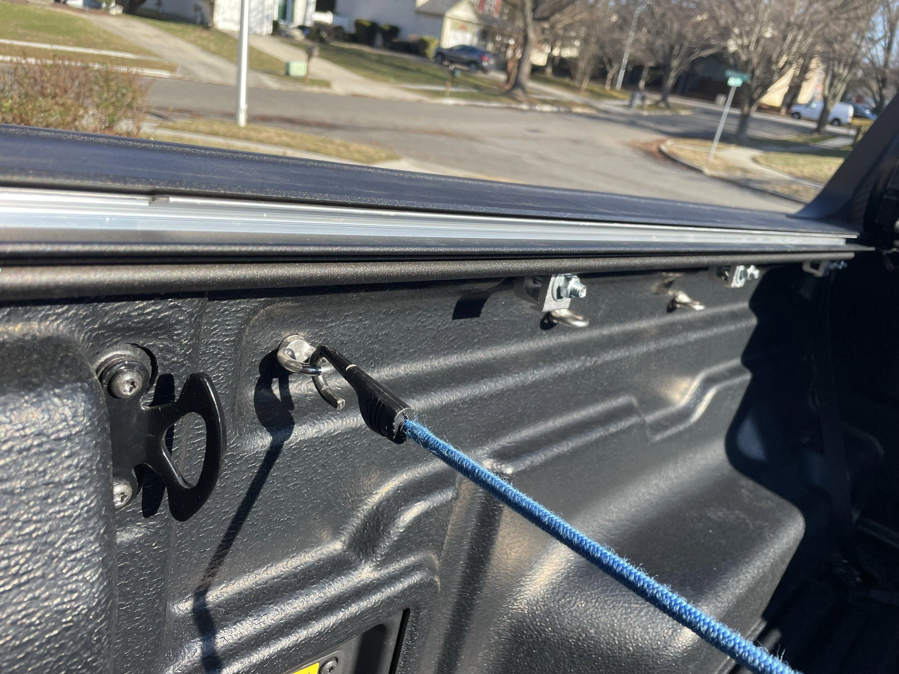

Mine has 4 M8 holes on each side. The eye hooks just screw in. You might put a rubber or plastic washer on to prevent messing up the paint.
Yes if you don’t have a bed liner. If you do have a bed liner, it can serve as the plastic between the paint and the hooks.

Hello Maverick owner,
Ford is selling the Cargo Management System for $420. I got mines for $12 on Amazon. Pictures attached
https://a.co/d/ci5TG0G
I actually think these are better than the rail system.

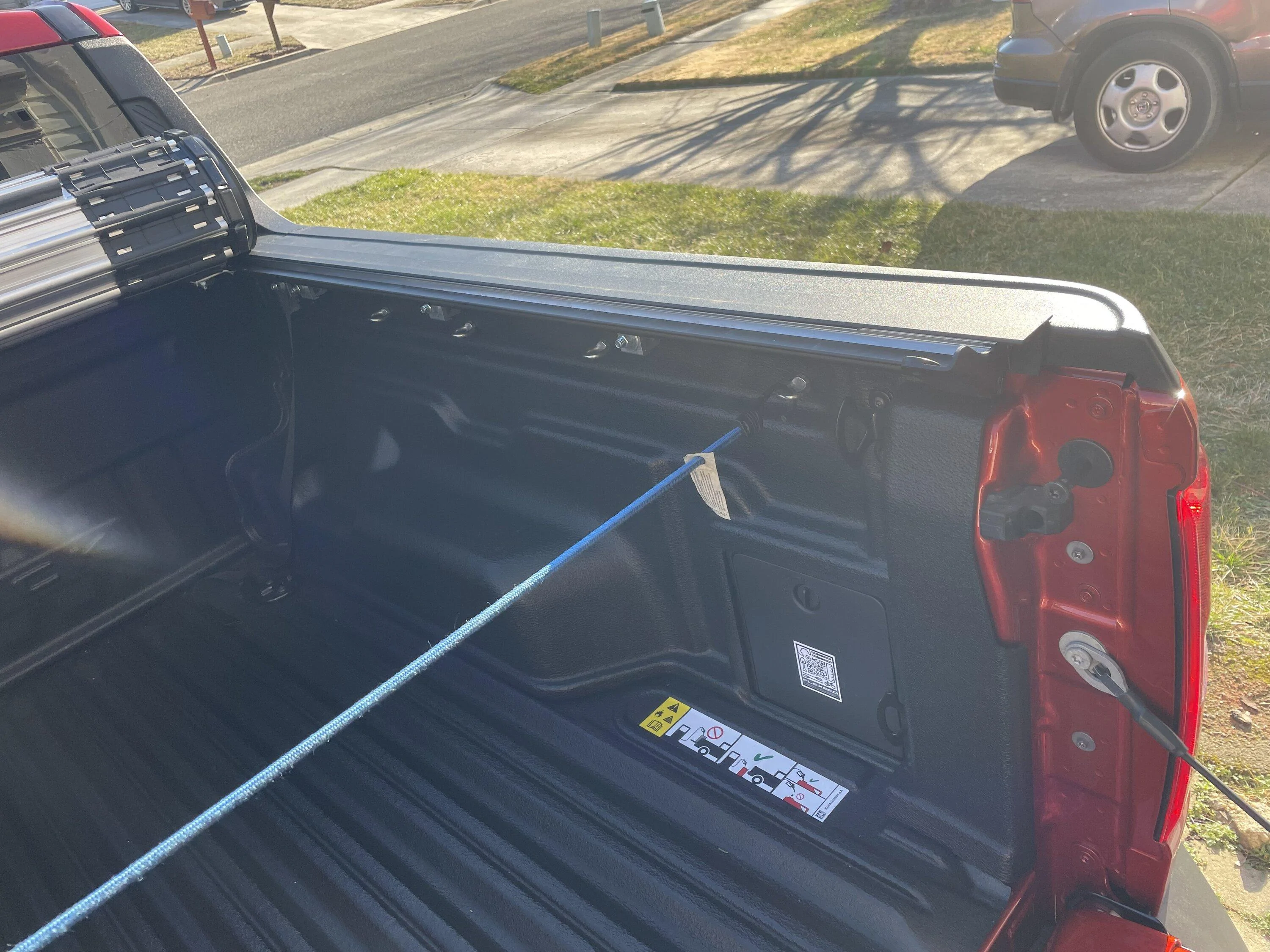

Do you think those would be strong enough to secure a motorcycle using tie-down straps?
Yes I don’t see why not. They’re screwed in and you have 7 on total. You can use all 7 to secure your bike.

I would recommend reading the owner's manual about how to properly secure loads. In addition, the rail system spreads any force across multiple attachment points and not just one- if you're not careful you'll end up with a bent truck bed where one of those hooks gets pulled hard...
I installed these too and use friction straps instead of ratchet straps. My thinking (hoping?) is that'll keep me from doing any damage.
Yeah I think the people talking about bending the truck bed are over thinking it in my opinion. Sure if you plan on loading a few thousand pounds of stuff very high, then you might want to consider if this is be too much. But I really don’t think people who buy mavericks are going to use this little truck to haul big stuff. But hey if have $420 go ahead and get the stuff from Ford. I shared this to give people who want to tie down so pieces of 2x4s, plywood, boxes, etc you know the average home stuff for small projects, these ring bolts will work great.

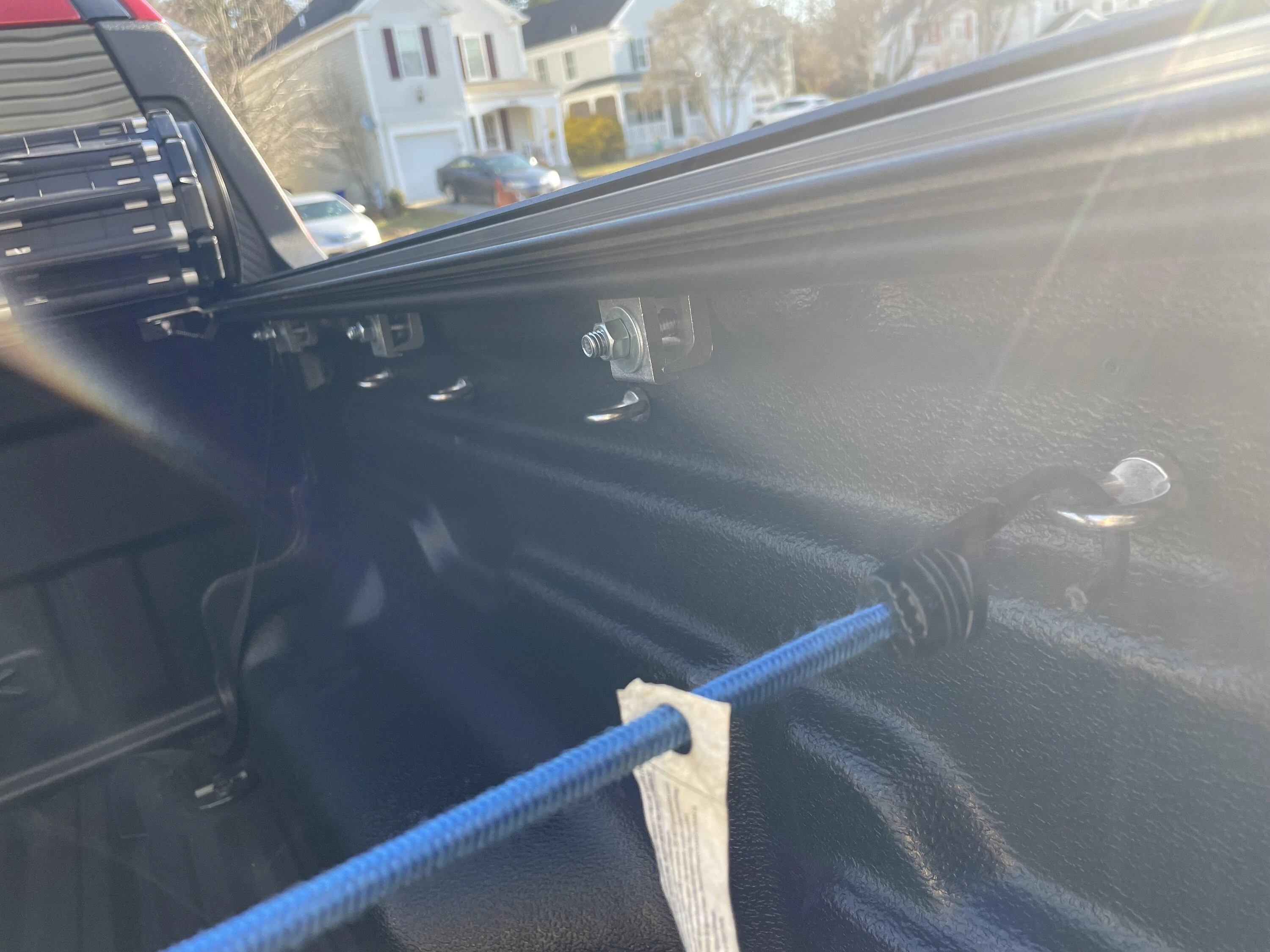

It's good to take @Ole cat man warning about lifting weights with eye bolts and since there is so much difference in weight ratings use caution lifting. M8 - 600# to 900# with crappy imports being less, even much less. Reading reviews some even fail being tightened, don't tighten them like a bolt. Tightening these eye bolts will pre load the bolt and will reduce their weight (tension) rating.
For ratchet straps don't get crazy cranking them down, be aware of the angles and you should be good. A 1" ratchet strap can generate approx 400# of pull, long lever ratchets much more.
Reduction In Maximum Weight Capacity By Angle Of Pull (Degrees) for lifting.
5° = full weight capacity (100% of load)
15° = weight capacity reduced by 20%
30° = weight capacity reduced by 35%
45° = weight capacity reduced by 70%
46°+ = not safe to use an eye bolt; consider a hoist ring instead
