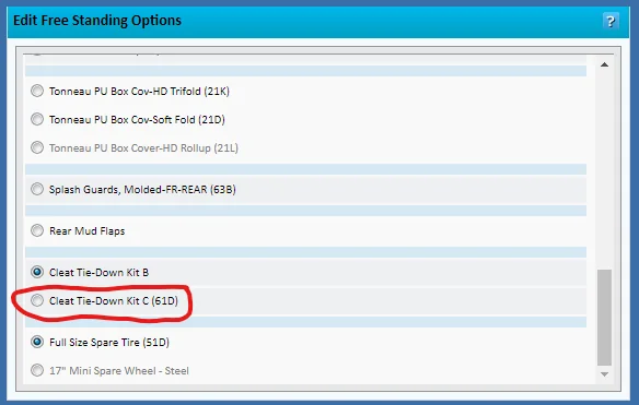

Bed rail system is available with the DIBL (according to the order guide).
MY dealer couldn't figure out how to add it. He said the 61D was nowhere to be found on the computer. Wanted to get it ordered before it was too late so I just ran with it....

Thanks!
Emailed my dealer.
